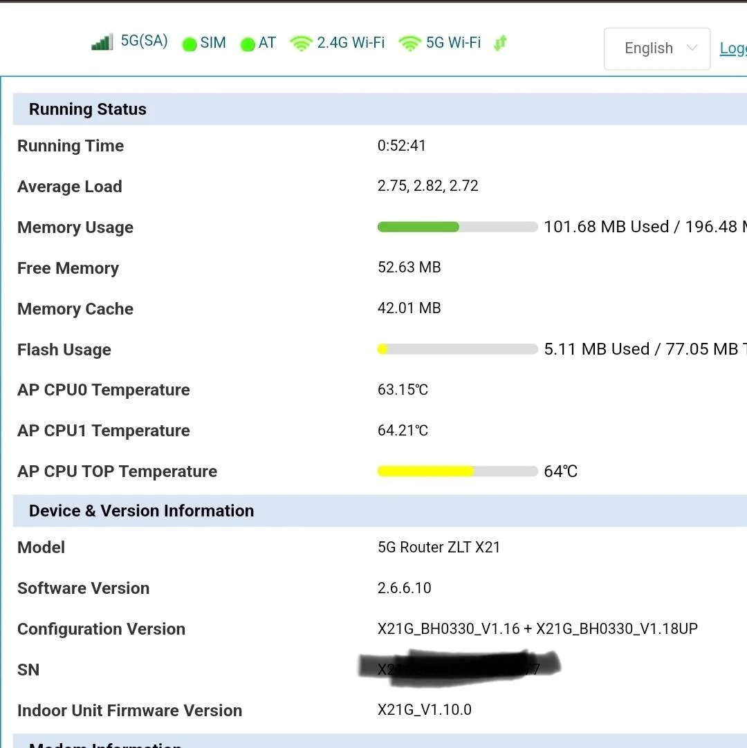

👨‍🏫 Tutorial Downgrade China Unicom VN007+ Ver. 2.6.6 for Superadmin Access
Thanks sir! Na downgrade ko na yung saken to version 1.10.23, but unfortunately hindi ko ma access yung super admin generator na link nato "You do not have permission to view the full content of this post. Log in or register now.". so I got stuck on step #15. Meron ka bang alternatives for step #15? Really appreciate your help. Thanks again.

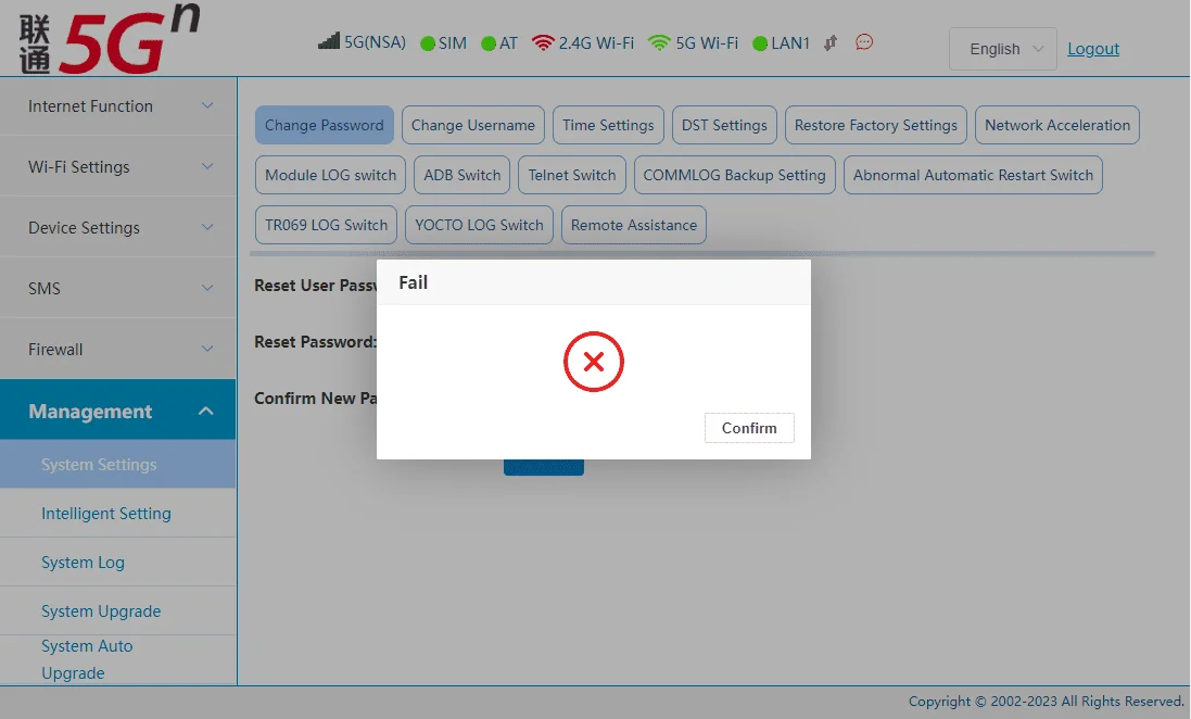

Lods, stucked up ako sa Step 8, hindi ko mapalitan ang Administrator User password:
I have version 3.0.2 po. Ano kaya problema nito?
Salamat po.
ganito rin problema ko, seems like na di gumagana sa 3.0.2
Edit:
Gumagana yung downgrade from 3.0.2 to 1.15. Rekta mo na downgrade. Saka ka iaallow mag change ng adminstrator password.
Hindi allowed sa 3.0.2 yung adminstrator changes.
Edit:
salamat dito lods, nagtry ako mag downgrade from 3.0.6 to 1.15.1 pero nagfe-fail. Then, nag try ako ng ibang lower version. nakapag-downgrade ako from 3.0.6 to 1.12.8 ng walang admin access. hahahaha. Saka ako nag try mag change ng admin name at password para mag downgrade to 1.10.23. nakapag change na ako ng IMEI at susubukan ko mag lock ng bands. Sa mga gusto i-try yung ginawa ko i-download niyo yung X21G_1.12.8_usr_UN2020C_20220309_normal_update.bin tas rekta upload kayo. Then, follow niyo na ulit yung steps ni OP.
When i try to upload 1.10.23, showing package error. .swu is not supporting
bro, you're trying to downgrade the version from 2.6.6 to 1.10.23. You should follow the steps and start with 1.15.1.
OR, try downloading X21G_1.12.8_usr_UN2020C_20220309_normal_update.bin first then, upload it. Be sure to reset your modem by holding the reset botton for 10 seconds after a successful downgrade. Next follow the instruction from Steps #2-#9.

Downgrading from 3.2.6 firmware
1. Login using admin/admin
2 Go to management > System upgrade > Browse > (Insert firmware) > upload > Sytem upgrade
*uulit ulitin naten ang step 9 hnggng maging 1.10.23 software version naten
Ganto ang pasunod sunod sa pag downgrade
1.14.0 >>>> 1.13.0 >>>> 1.10.23
3. Then finollow ko lng tong youtube video
4. Go to 192.168.0.1 then input yung username (dalawa yun either "superadmin" or yung alternate username na "Gztz@83583#" without quotes)
18. Input password 12345678
19. Dapat naka login na kayo as superuser
(Optional)20.For IMEI changing, Go to Management > AT Command then input code:
AT+SPIMEI=0, "IMEI CODE HERE"
AT+SPIMEI?
