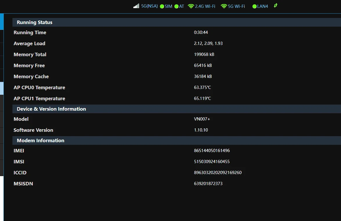

Eto yung firmware pang upgrade/downgrade
X21_IDU (停止维护)5G SA!
The firmware starting with X21G_IDU can only be used on VN007+!
Notice:
VN007 cannot use this firmware!
It is recommended to use the Chrome kernel browser to upgrade the firmware!
TardisLX/vn007_history_firmware
X21_IDU_SA
The firmware starting with X21_IDU can only be used on VN007!
Notice:
VN007+ cannot use this firmware!
vn007_history_firmware/X21G/
The firmware starting with X21G can only be used on VN007+!
Notice:
X21_IDU (stop maintenance)
The firmware starting with X21 can only be used on VN007!
Notice:
When VN007 is in version 3.X, you cannot use this firmware to downgrade at will! ! !
This version does not support 5G SA!

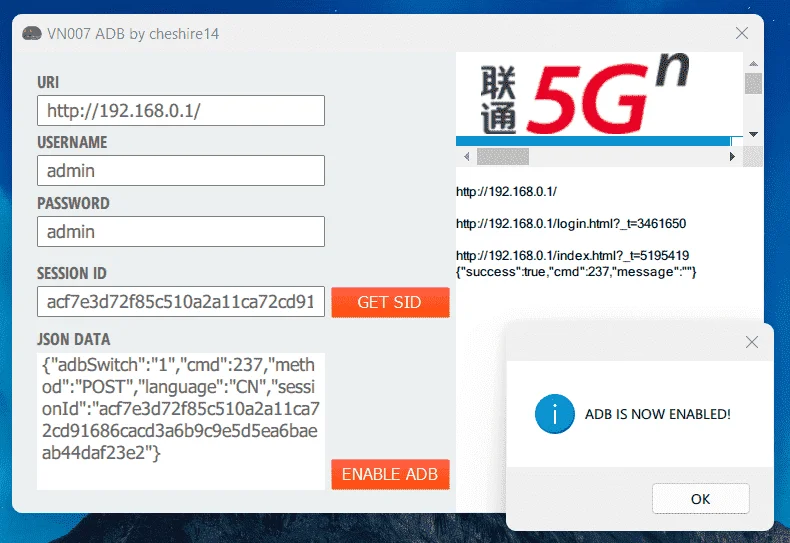

Microsoft Windows [Version 10.0.19044.1387]
(c) Microsoft Corporation. All rights reserved.
C:\Program Files (x86)\Minimal ADB and Fastboot>adb connect 192.168.0.1:5555
  • daemon not running; starting now at tcp:5037
  • daemon started successfully
connected to 192.168.0.1:5555
C:\Program Files (x86)\Minimal ADB and Fastboot>adb shell
root@udx710-module-pi:/ # cat /tmp/mdlcfg.sysconfig / grep SYS_SENIOR_LOGIN_PWD

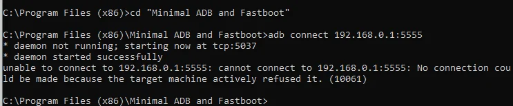

Success naman sya sa tools kaso pagdating sa adb ganto sya
same na run as admin meron ding netframework tapos ng i check ko sa system log eto yung nakita ko di kaya na approved yung adb? VN007
Thanks for sharing! Got my root password using the methods provided in this post.
I'm using VN007+.
  • Downgraded OS to 1.10.10
  • Used the VN007 ENABLE ADB tool
  • Used the minimal adb fastboot tool
