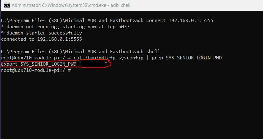

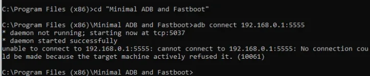

Sa mga wala pang root password or project password for band locking ng VN007 5G e share ko po ung na discover kung technique..
dapat connected kayu sa VN007 nyu.
download nyu nlng ung tools.
Tools Required:

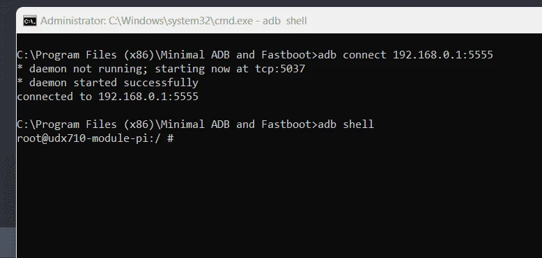

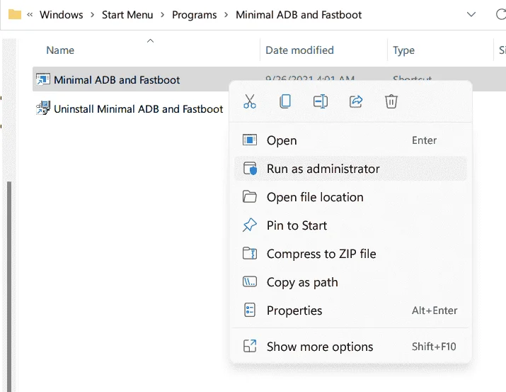

1. Run as admin "Minimal ADB and Fastboot" or any adb tool
2. Type adb connect 192.168.0.1:5555 then enter
3. Type adb shell then enter
4. Type cat /tmp/mdlcfg.sysconfig | grep SYS_SENIOR_LOGIN_PWD then enter
5. there you have it. congrats!

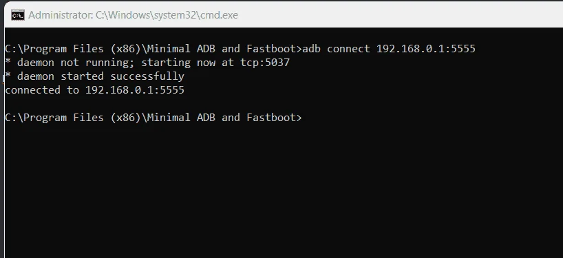

eto po error na nakuha ko nung tiniry ko po ang ADB... pa help please!
https://phcorner.org/threads/china-unicom-vn007-enable-adb.1274010/

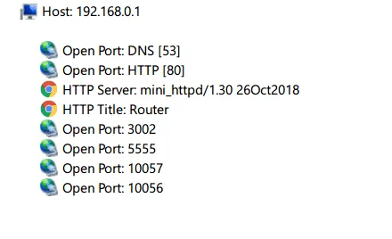

Hello, do you know how to get the Pásswørd of superadmin?
I use vn007 +, but it does not open the ADB port
you might try upgrading the firmware first..i upgraded mine before getting the root pass
as always, do it at your own risk, we're not responsible for any damage in your device..

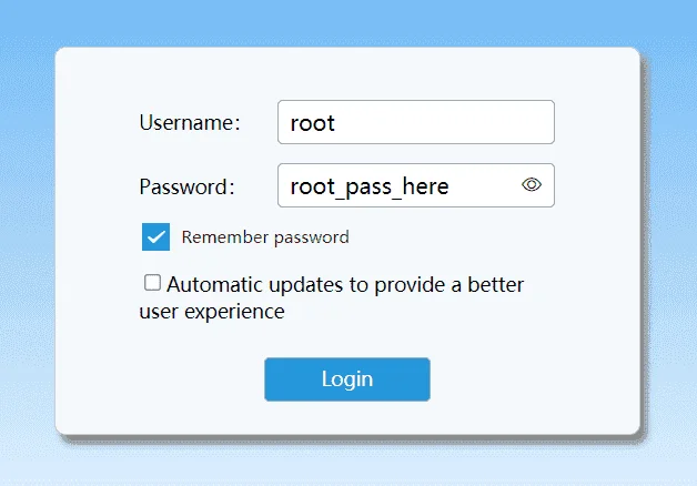

hindi po yan telnet..
e download mo po ung tool tas yun gamitin mo pang execute ng command.
Pwede rin Lods Basta may root user and pass pwede sa Telnet/ssh/termux yan gawin sa smartphone
Lods, Same way Ganyan din pagpasok sa pag modified firmware ng Lte modem pwede network unlock via commands na grep write mtdwrite basta linux base firmware ang modem
Pwede rin Lods Basta may root user and pass pwede sa Telnet/ssh/termux yan gawin sa smartphoneLods, Same way Ganyan din pagpasok sa pag modified firmware ng Lte modem pwede network unlock via commands na grep write mtdwrite basta linux base firmware ang modem
close ung port ng telnet sa VN007+, via android bridge debug mo lang ata ma a~access...
if you have a trick po to enable ung telnet, much appreciated if you share it here po.
