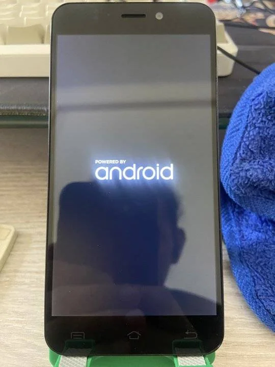

I have a Cherry Mobile Flare X Lite and it is stuck on bootloop I need help getting this device working again sana.
Nagoopen sya hanggang "Powered by Android" lang and then after a few seconds mamamatay and mag vi-vibrate ulit and boot into "Powered by Android" again.

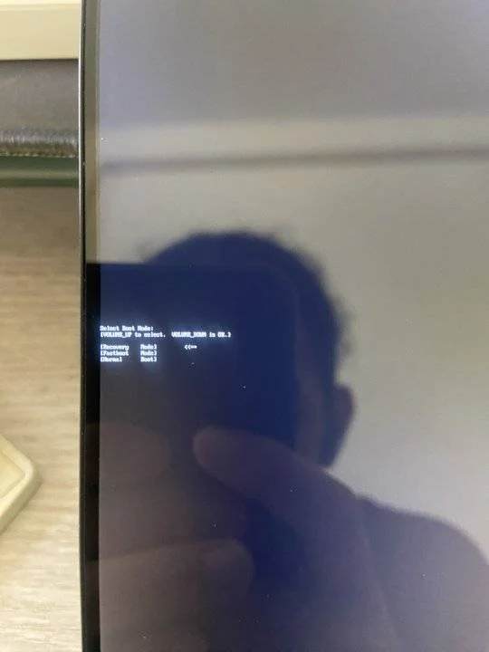

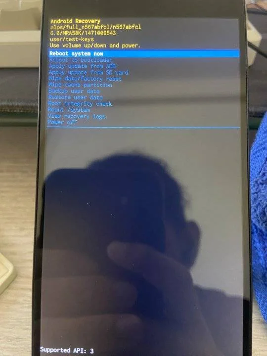

Any idea kung ano problem neto? The pictures attached are the only menus I can only reach with the phone.
What I have done so far:
I Wiped/Erased the device to factory settings
Cleared Cache
Flashed Stock ROM using SP Flash Tool.

Gamit ka Sp Flash tool, and make sure na installed lahat ng MTK driver para iwas disgrasya. Sa pag flash sa mga mtk device is bago mo salpak sa laptop make sure na naka start flash kana sa Sp Tool then make sure din na naka press ung volume down and plus then insert sa laptop para mag flash sya
Ito ung guide sana masundan mo
Hello, Update:
I tried to reflash again, even redownloaded the stock rom pero wala padin nangyari, i even checked the drivers and it installed properly, phone is still stuck on logo, nothing changed, still the same problem.
ibang version ng stock rom lods, sure yan
Do you have a link for a different version? I can't find anything anywhere only the "07092017" is the only one i can find.
Hello, Update:
sadly nope, sali ka kaya lods sa group ng phone mo, baka meron sila
Try mo reflash ult Palit ka ng method sa Sp flash Tool. Gawin mong option is uhg Format all+download
Sinubukan ko na dn boss pero wala padin talaga, suko na lang ako for today.
If ever na may nakakaalam ng workaround sa problem na to please reply lang, will keep watching this thread.
Mag TWRP ang solution doon ka mismo mag flash ng rom... Mag palit ka ng recovery un ang best way pero kapag wala parin anyare my sira ung ic nyan sa loob" hardware ang sira"
