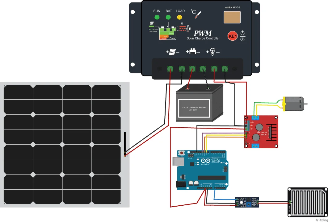

1. The purposed is that it automatically retrieved when its raining and back when it's not ( we used rain sensor)
2. The motor we used is one 12v Power Window Motor that connected to a h-bridge
3. .It retrieves when it's raining and return when the rain stop vice-versa

anong gagawin
- The purposed is that it automatically retrieved when its raining and back when it's not ( we used rain sensor)
  • The motor we used is one 12v Power Window Motor that connected to a h-bridge
  • It retrieves when it's raining and return when the rain stop vice-versa
ito po lods.. Wala akong alam sa programming

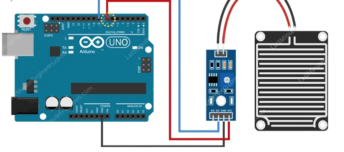

try mo to ts using rain sensor
#define sensorPower 7
#define sensorPin 8
void setup() {
pinMode(sensorPower, OUTPUT);
// Initially keep the sensor OFF
digitalWrite(sensorPower, LOW);
Serial.begin(9600);
void loop() {
//get the reading from the function below and print it
int val = readSensor();
Serial.print("Digital Output: ");
Serial.println(val);
// Determine status of rain
if (val) {
Serial.println("Status: Clear");
} else {
Serial.println("Status: It's raining");
delay(1000); // Take a reading every second
Serial.println();
// This function returns the sensor output
int readSensor() {
digitalWrite(sensorPower, HIGH); // Turn the sensor ON
delay(10); // Allow power to settle
int val = digitalRead(sensorPin); // Read the sensor output
digitalWrite(sensorPower, LOW); // Turn the sensor OFF
return val; // Return the value
