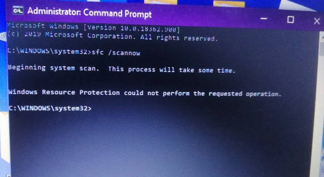

This laptop of mine is bigla na lang magcollapse (blue screen), start up repair does not work. yung cmd command lang na "chkdsk /f /r C:" ang makarestore
I wish po na matotally repair na para magamit ko ng maayos.

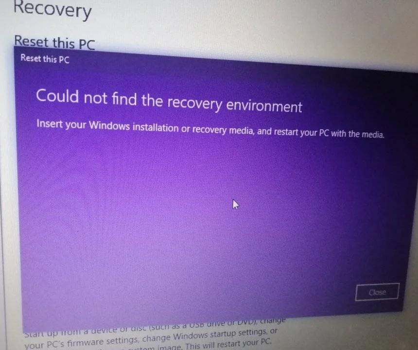

Tinry ko ireset pero got this error.
inapply ko na yung enable reagentc pero error din. Unable to Boot Configuration Data
then tinry ko din mag cmd repair, error din.

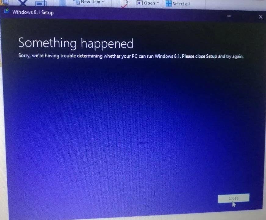

so lastly tinry ko mag install windows 8 (original OS) and windows 10 iso puro ganito error.
ano po need gawin? any way to fix DIY or need na talaga technician?

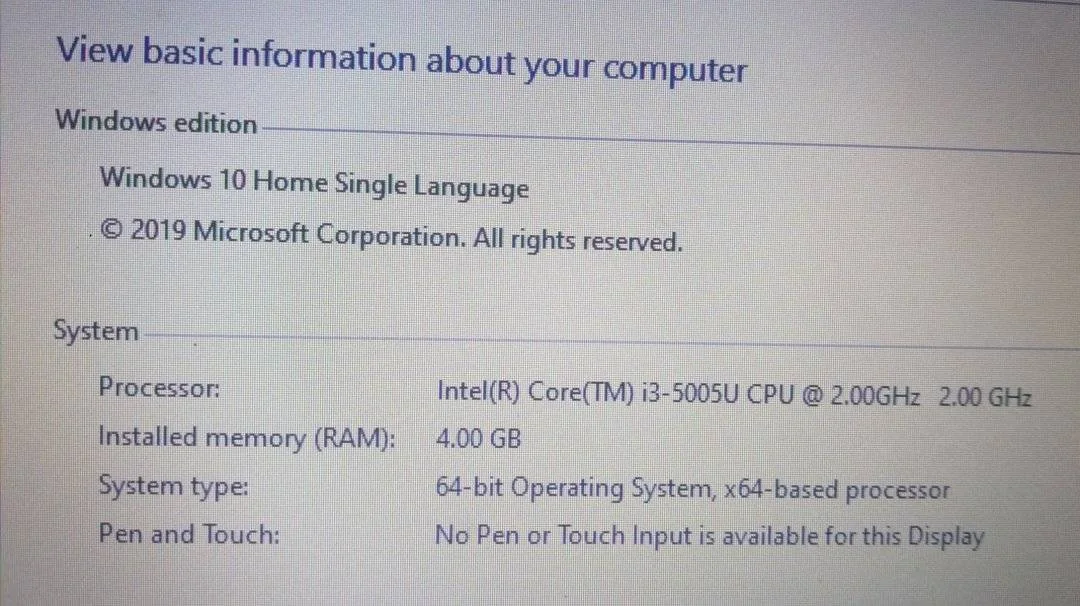

Can be faulty HDD ang sira, since nagbubluescreen sya, plus namentioned mo na windoze 8 yung orig OS nya plus 5th gen yung processor mo screenshot, nagdeteriorate na siguro ang HDD from this moment.
Palitan mo nalang ng SSD sya, and kung maaccess mo pa ang laman ng lumang HDD para macopy mo sya to backup.

Acer Travelmate P236-M-37YE po
age po ng laptop?
8 years po
try HDD Sentinel para macheck health/performance nung storage mo baka kasi mababa na kaya laging corrupted
Bad po ang result so need na talaga ireplace I guess.
