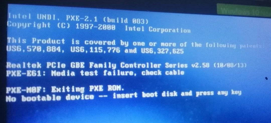

Hello
Sa mga expert, badly need your help.
This laptop of mine is bigla na lang magcollapse (blue screen), start up repair does not work. yung cmd command lang na "chkdsk /f /r C:" ang makarestore
I wish po na matotally repair na para magamit ko ng maayos.
Tinry ko ireset pero got this error.
inapply ko na yung enable reagentc pero error din. Unable to Boot Configuration Data
then tinry ko din mag cmd repair, error din.
so lastly tinry ko mag install windows 8 (original OS) and windows 10 iso puro ganito error.
ano po need gawin? any way to fix DIY or need na talaga technician?
Hope someone can help, thanks in advance.

Error when resetting: Could not find the windows recovery environment
Error when enabling regeantc : Unable to boot configuration data
Error with sfc /scannow : Windows Resource could not perform the requested operation
Error when installing ISO: Sorry, we're having trouble determining whether your PC can run Windows 8.1 /10

Most likely pag ganitong error is corrupted na mismo yung OS file or mababa na yung health ng hard drive mo, if maka pasok sa desktop, download and install hard disk sentinel, pag di na talaga maka pasok sa desktop. check sa bios kung nandun pa yung hard disk mo. if ever na di na talaga ma detect, need na talaga mag replace.
