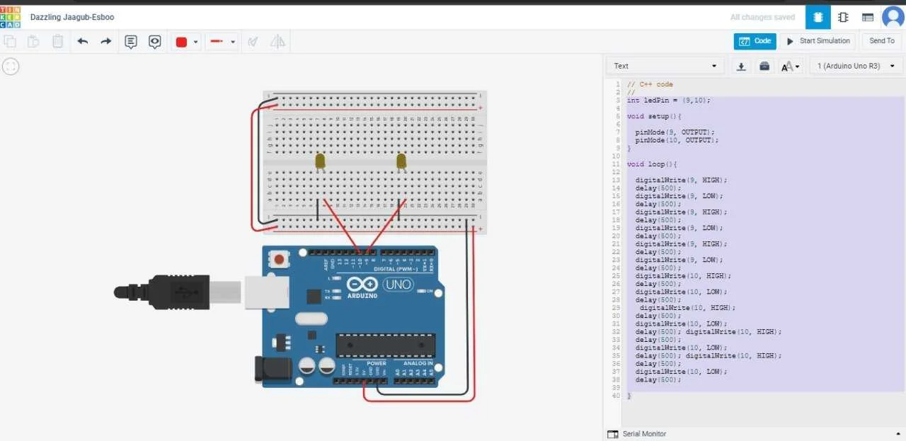

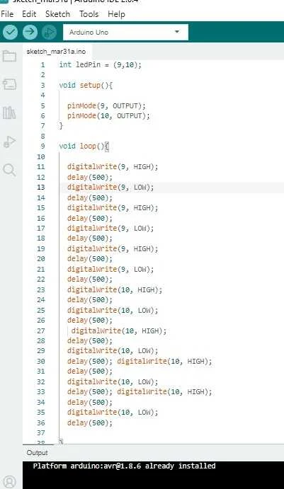

Mga lods pahelp po about arduino coding,
Subject namin microprocessor kaka start ko lng po sa arduino
Ni study ko na po din to kasi para sa future programing ng thesis ko
Pahelp po paano mag shorten ng code pero same output result lng in po
Maraming Salamat po sa help!
ito po yung code
int ledPin = (9,10);
void setup(){
pinMode(9, OUTPUT);
pinMode(10, OUTPUT);
void loop(){
digitalWrite(9, HIGH);
delay(500);
digitalWrite(9, LOW);
delay(500);
delay(500);
delay(500);
delay(500);
delay(500);
digitalWrite(10, HIGH);
delay(500);
digitalWrite(10, LOW);
delay(500);
delay(500);
delay(500); digitalWrite(10, HIGH);
delay(500);
delay(500);
delay(500);
Hi! I can see that your code is controlling two LEDs connected to pins 9 and 10 of your Arduino board. To shorten your code, you can use a loop to repeat the same code for both LEDs. Here's an example:
Code:
int ledPins[] = {9, 10}; // declare an array with the LED pins
void setup() {
  // set the LED pins as outputs
  for (int i = 0; i < 2; i++) {
    pinMode(ledPins[i], OUTPUT);
void loop() {
  // loop through each LED and blink it 3 times
    for (int j = 0; j < 3; j++) {
      digitalWrite(ledPins[i], HIGH);
      delay(500);
      digitalWrite(ledPins[i], LOW);
      delay(500);
In this example, we use an array ledPins to store the LED pins, and a for loop to set them as outputs in the setup() function. Then we use two nested for loops in the loop() function to loop through each LED and blink it three times, with a delay of 500ms between each blink.
I hope this helps! Let me know if you have any questions.
