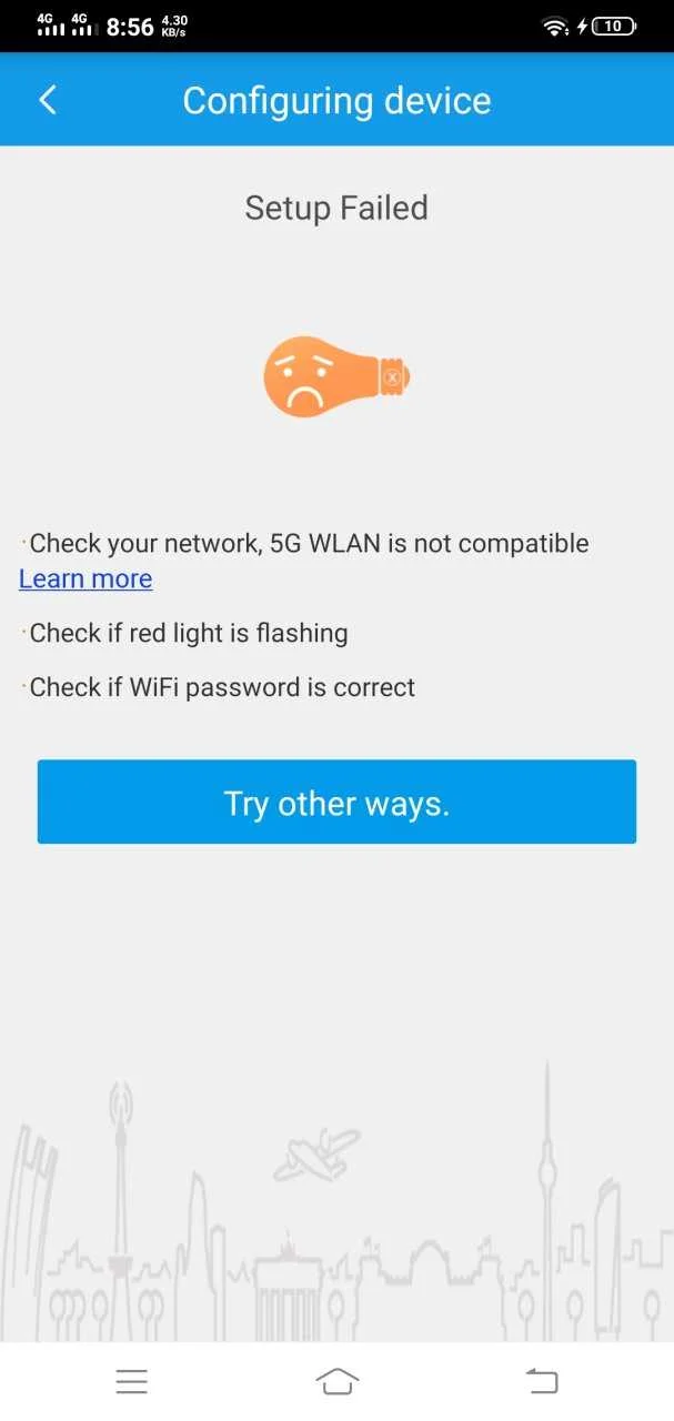

about cctv camera... not detect on wifi but in lan cable connected.. working sya.. i'm using 360 eyes pro program.. pano kaya i-set up.. nagawa ko AP mode at wifi mode .. ayaww mag connect pero in lan cable mode working.. ano po kaya problem??

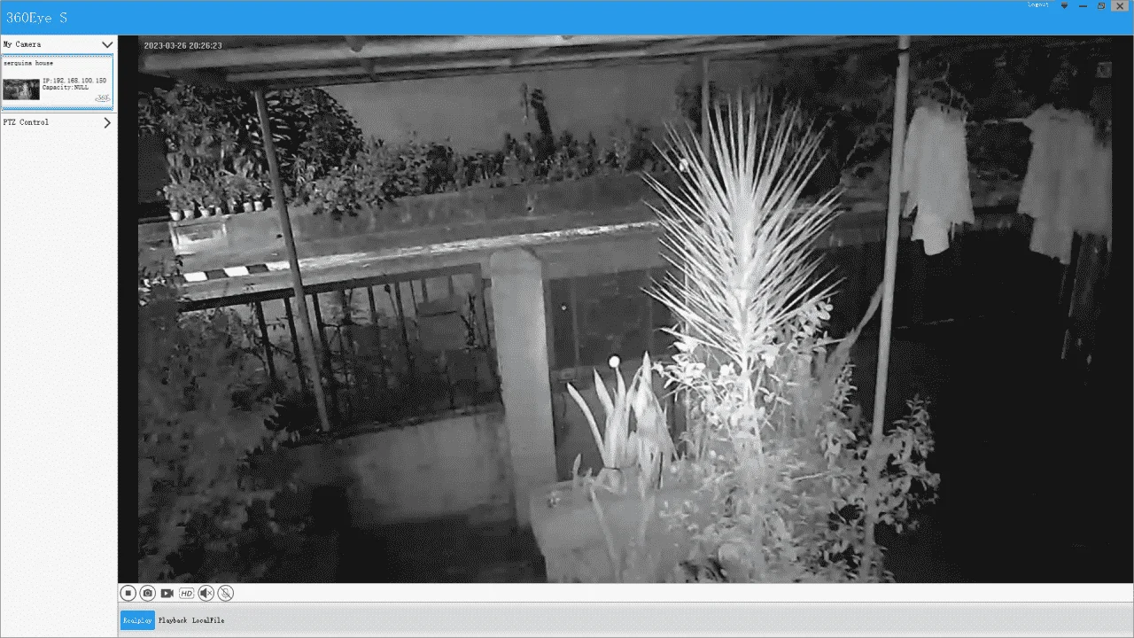

bka may software version po nyan.. pang pc at cp ..
sa akin po may pang pc at cp po... almost 2 cp naka connect at pc sa cctv ...

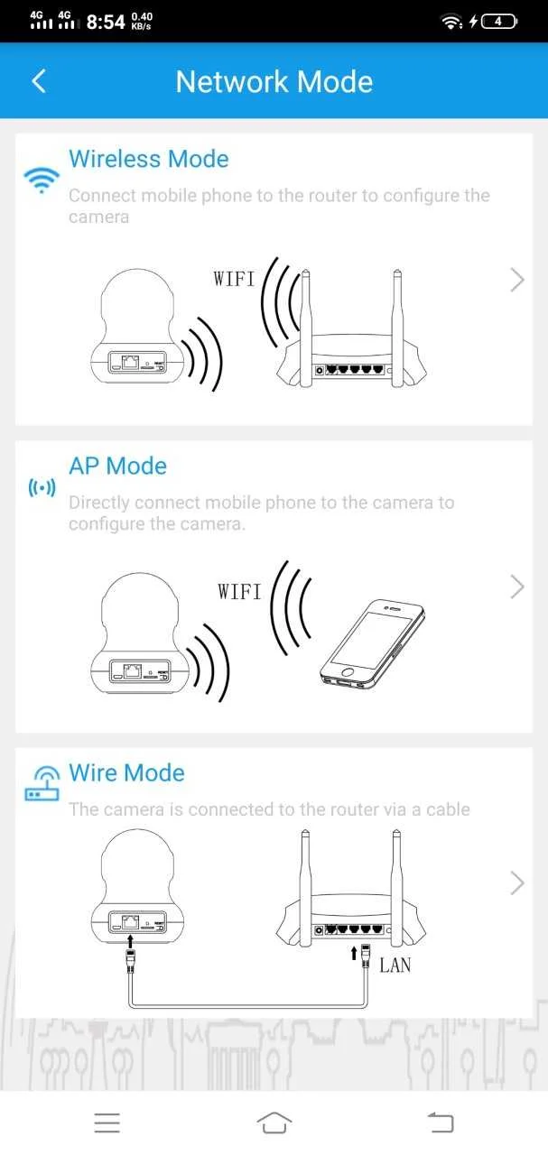

may ss ka ba nang settings nang app nang cctv mo?
sakin kasi kakalagay ko lang this month meron syang sariling hotspot meron din sya option direct wifi
Yan po ss.. Yan din error.. Tama nmn po password sa wifi

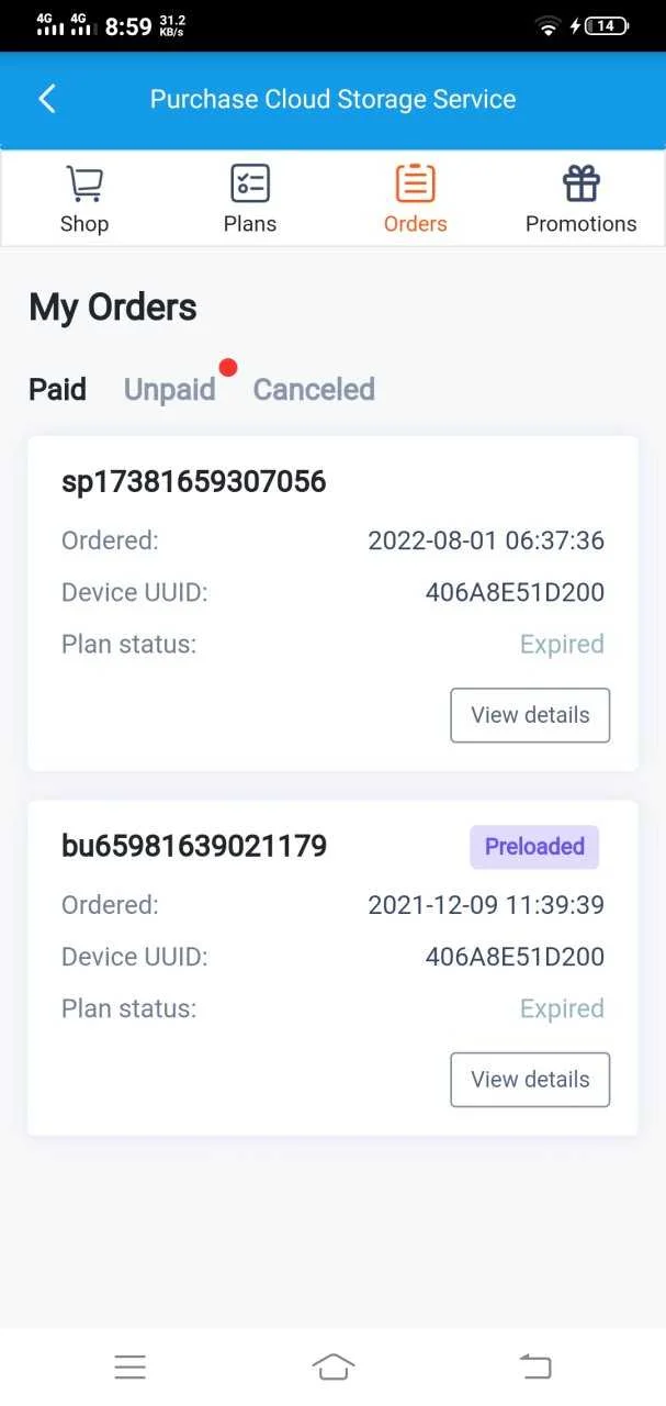

Eto po yung free cloud storage..
