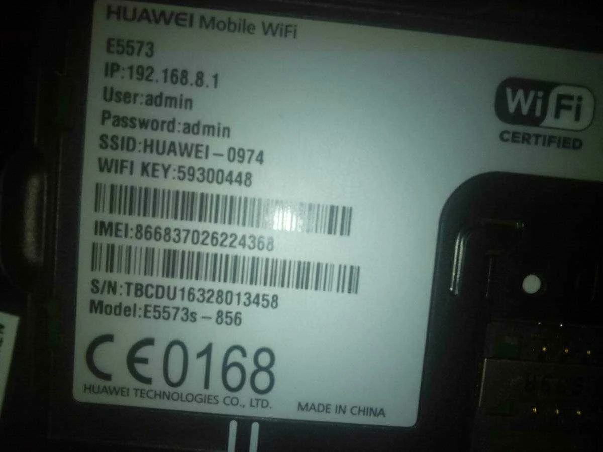

model: huawei e5573s-856
IMEI:866837026224368
need unlock code pls. thanks
Unlock codes 55675508 or 32444595 or 63659846

Ganda ng pocket mo ah haha. Hmm. Sige pagaralan ko yang model mo.
Na testing monaba lahat ng codes? Try mo (y) 10attempts pa naman yan.
elijahjames Follow mo instructions. Patingin narin ako ng screenshot mo.
