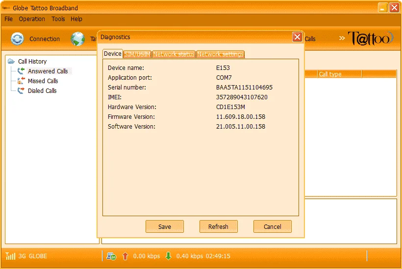

Tested for Huawei All model and Globe T@ttoo.
*Requirements:
#1 Kung may pc, Laptop kayo mas Okay (y)
#2 Kung wala naman. Android phone nalang tapos download kayo sa playstore ng HiLink. (y)
INSTRUCTION:
#1 power off pocket wifi/stick. Salpak ka smart/sun/tnt na simcard sa pocket wifi. (Vice versa)
#2 conect mo laptop mo or computer or Android phone sa pocket wifi mo
#3 punta kasa browser mo. Then type 192.168.8.1 or 192.168.1.1
(Dipende yan sa unit mo) (kadalsan makikita mo naman to sa Likod ng unit mo)
#4 may nakalagay jan na box. Ang nakalagay Input SimLock:
‪#‎5 Last‬ step: Lagay mo yung code na ibibigay ko sayo (y)
Note:
(If nanghingi ng username and password use default)
(Username: admin Password: admin)
DONE!
#Openline
#Globet@ttoo
#Huawei
#Unlockcodes
#100%free
Comment down your Model and Unit.
