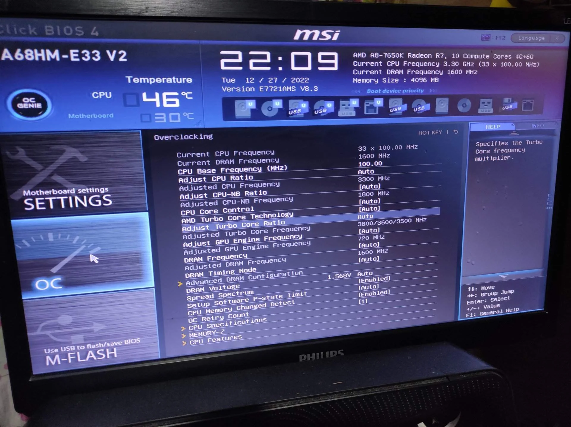

✅ Nacheck ko pa kanina sa bios kung nag ooverheat ung cpu and mobo hindi rin..
Stuck nalang sya now sa pagikot ng fan at no display parin, di rin nailaw yung keyboard capslock and other indicators

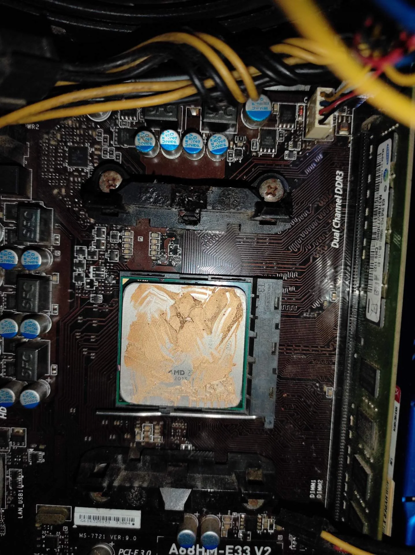

baka cpu mo paps may problem ? try mo nga mag lagay bagong thermal paste

It will automatically shut off if heat is sensed, based on your pix, it does not have heatsink were it should be there. Maybe I'm wrong.
Malaki duda ko na motherboard problema nyan. May mobo ako dati na nagautoshutdown ng di mo alam ang dahilan.
Yun pala may tama na PCH chip, naglalaro sa 96-104C ang temp
mobo po b prob nito? same ng akin, my power, umiikot fan, di namamatay kaso no display, wla ilaw keyboard my ilaw ung mouse
Hinala ko motherboard yan kasi walang ilaw ang keyboard at mouse at no display. Pag no display at may ilaw ang mouse at keyboard, ram sticks mo yan. Linisan mo lang.
