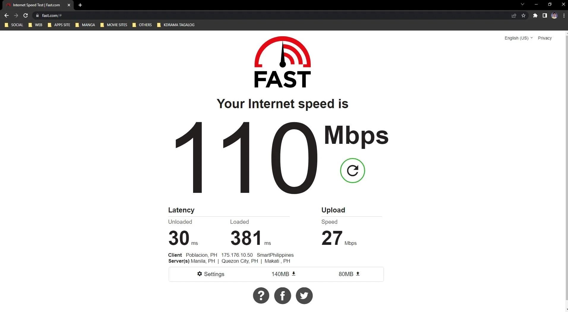

mga idol successful yung pag unlock ng device ko as requested kay Globe, a brief tutorial mentioned by R1BNC on youtube. Di ako affiliated sa kanya pero I just want to support the legitimacy nung mismong video. Big thanks and credits to him, process is confidential so ibabahagi ko nalang yung mismong proof. Maraming salamat po.
Model: Huawei B535-932 Postpaid
Request date: 12 days na pangungulit
Link: nasa youtube po pakihanap nalang yung video nya
Disclaimer: Ito lang proof ang maiproprovide ko na possible ang unlocking ng B535-932 (not device specific pero depende nalang siguro sa tagal ng modem nung na release) but the process and patience will solely rely on you who need it. Please do not be disappointed if by any means your request is disregarded by Globe's agent (Globe Facebook Page via messenger). Try as many times as you can dahil posible na marami ang rejections diyan kaya tyaga ang labanan. Paki basa nalang ang mga comments for questions that you're curious about para may idea kayo. To those resellers po I don't think this will be worth your time kasi hindi sya easy-access, but it is for those individuals who badly needed its unlocked feature. Pasensya na po kung ito lang din yung maibabahagi ko, yun lamang po maraming salamat.

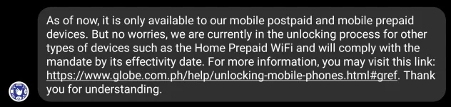

Pag nag sesend ako message sabi nila unauthorized daw sila mag unlock ng modems

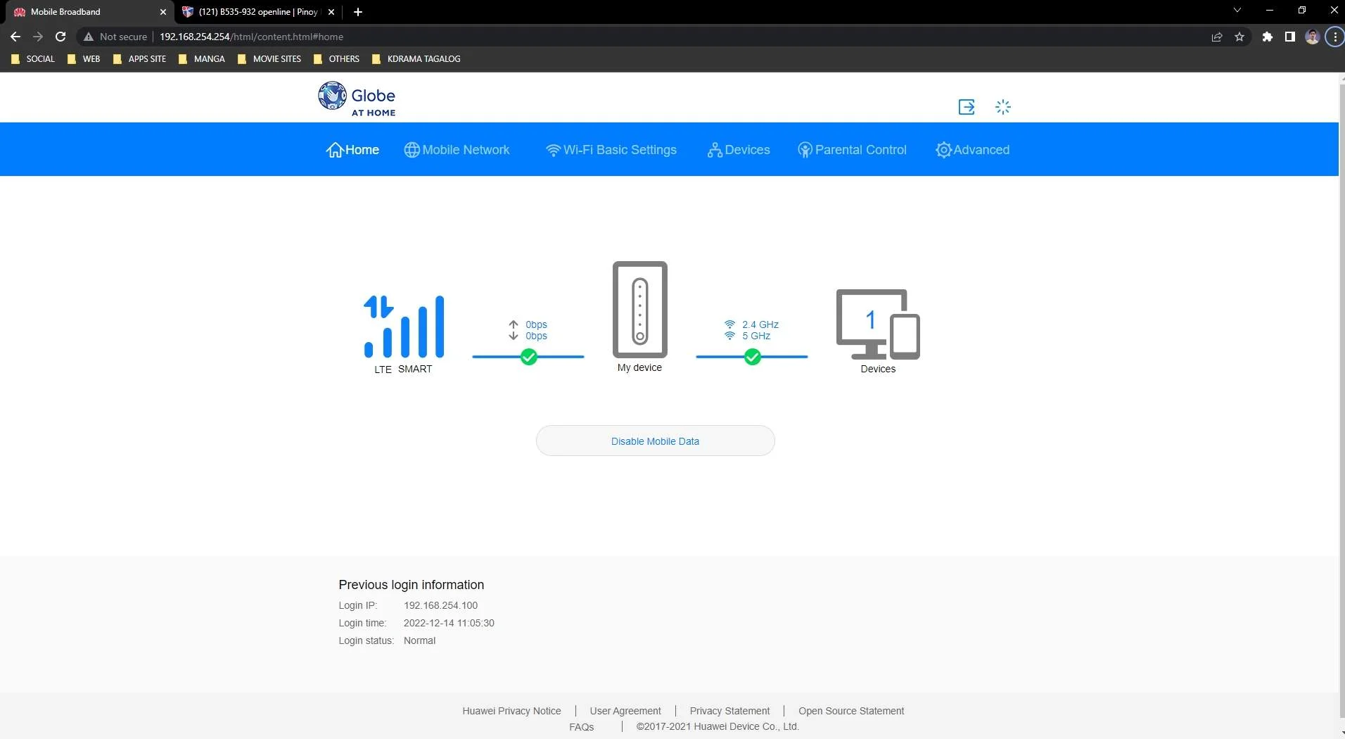

TS nka Admin access na po ako mula nung binili ko tong modem Huawei B535-932 Openline na ba to?
hindi pa po openline lods. Access lng po yan sa advanced/hidden features ng GUI nya.

sabihin mo di naman need pumunta ng store kase nakalagay naman sa memo na IMEI at active globe mobile number lang ang kaylangan sa pag request ng unlock code. tsaka mo ipakita yung mismong memo na yun at yung sanction kung hindi nila ma process. Then if tumanggi sabihin mo na iinclude mo yung convo nyo para isend sa ntc ang reklamo. Ulit ulitin mo idol

kung sa bawat sagot nila na walang malinaw na paraan para ma process ang request mo dapat alam nyo ibackfire sa kanila ng tama base sa memo idol. kung meron kayong home prepaid wifi number sa mga lumang modem na meron kasamang sim pwede nyo gamitin yun if mag request sila ng account number, mapa active man o expired na. if ang sagot nila hindi nila ma process dahil expired na ang sim, wag nyo tigilan na hindi naman need ang existing sim na included at since consumer ka alam mo na meron ka karapatan para makuha yung hinihingi mo sa kanila. Ako kahit postpaid ang modem ko sinabi ko prepaid hahahaha kase meron akong globe modem na prepaid na meron sim na expired kaya yun binigay ko sa kanila.

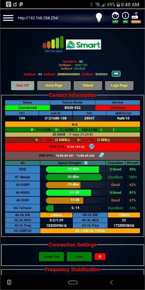

konti lng daw bands lods pag postpaid na 932 3,28,41 lang, Yung prepaid may band 1,3,28,40,41, hinde ba pwede mga bagong bili lods tapos e req ng unlocking agad haha

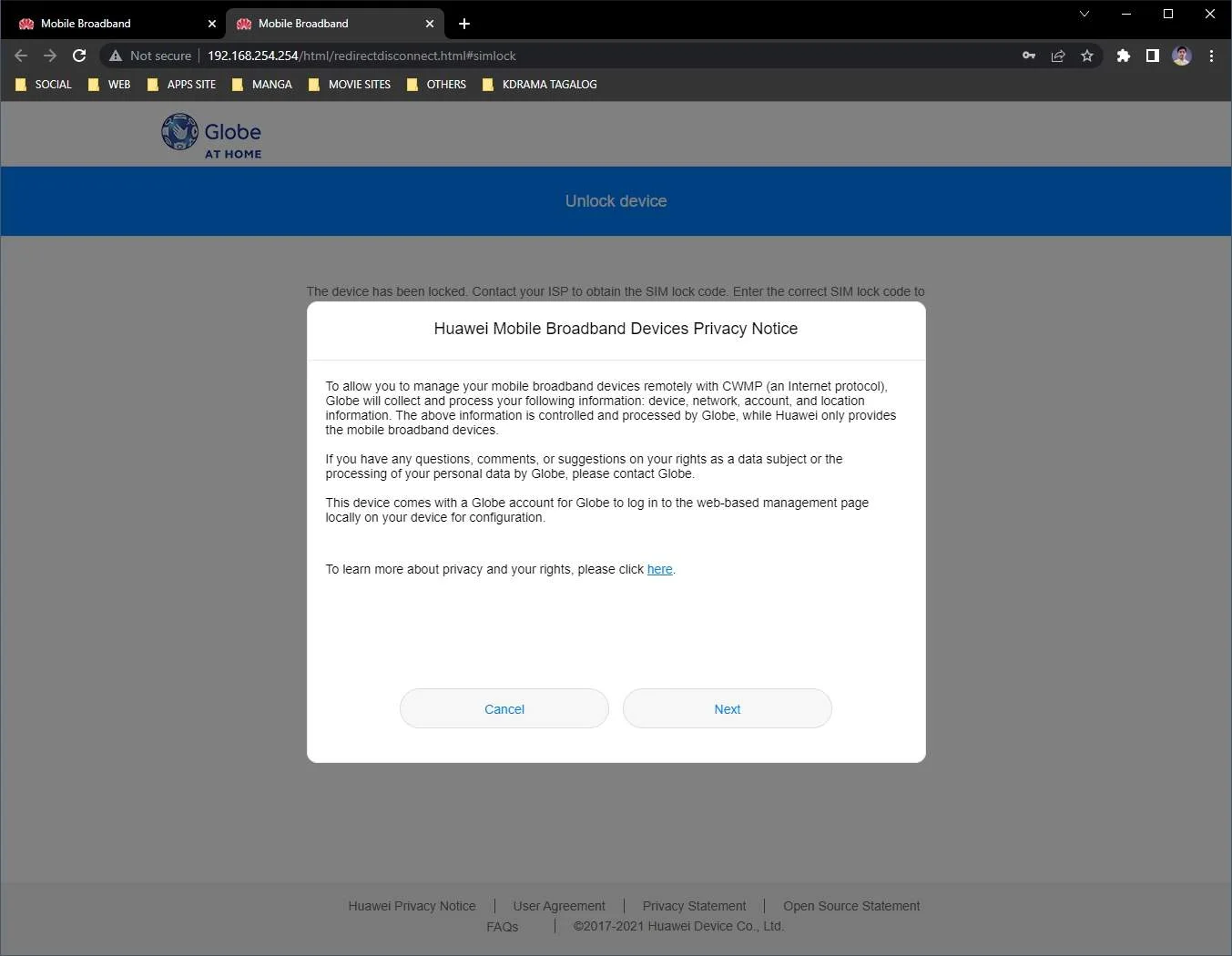

sir, paano ka po pala napunta doon sa unlocking page ng modem?
insert ka ng smart sim lilitaw yan
yun na nga eh haha eh wala postpaid binili ko kasi since may admin access pa. pero prepaid meron din pala kaso provided lang ni Globe yung password di katulad ng postpaid na pwede ipagenerate agad. 3/28 bands lang din naman available sa area ko since unstable to useless na ang 1 at 41 samin hahaha okay na rin.2022-12-17 01_09_05-LG-US998.webp
