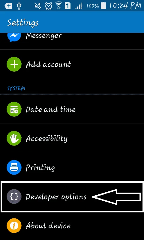

2. Punta ka sa Phone mo then go to Settings>About Device tapos scroll down at tap mo lang yung Build number 5 times or 7 times hanggang lumabas yung message na You are now a developer! Then back at lalabas ang "Developer Options" before About Device
3. Click Developer OptionsScreenshot_2016-07-29-22-24-03.webp then Check mo yung USB debugging.

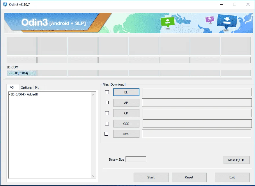

7.Connect mo lang Device mo sa PC using your CORD at kailangan na detect yan sa odin gaya nito aw.webp
8. Tapos Click AP then open mo yung TWRP 3.0 na nasa folder
9. Sa Option Tab dapat hindi naka check yung re-partition
10. Then Click Start tapos wait niyo lang hanggang ma success na at matapos magreboot yung phone niyo, then pwede na Exit yung Odin. At ilagay niyo ang UPDATE-SuperSU-v1.94.zip sa SD card niyo. (Dont extract it, ilagay niyo lang sa SD CARD)

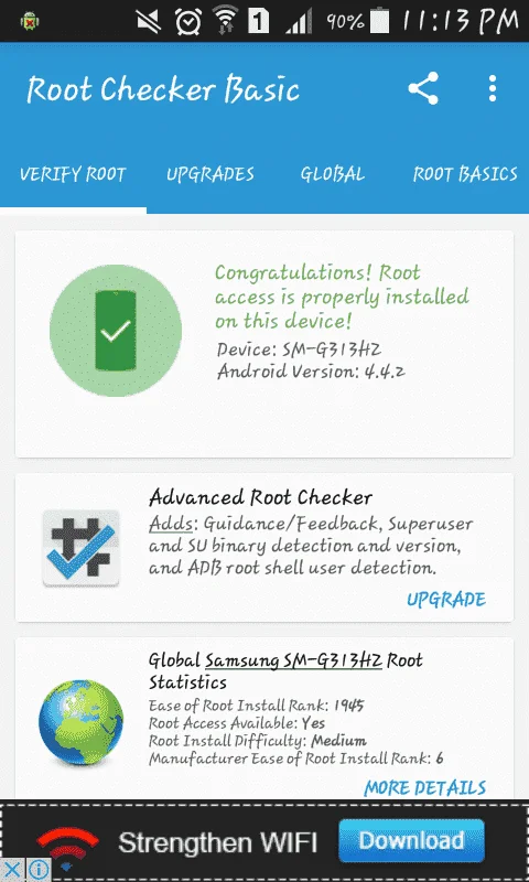

Download niyo Root Checker sa Play Store para malaman kung rooted naba device mo ,
Open Root Checker then Click Verify Root! if not rooted wait mo yung SU na mag grant ng access sa rootchecker then click verify root again!
