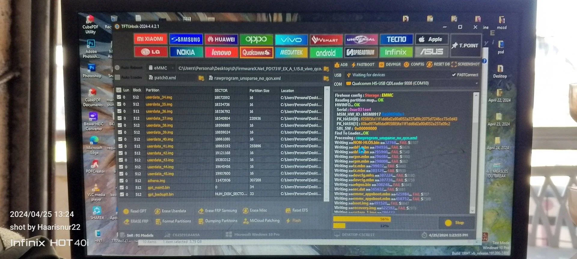

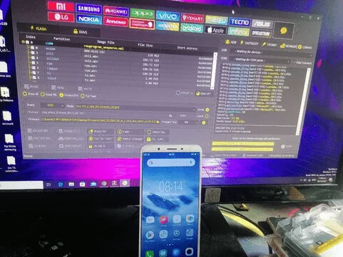

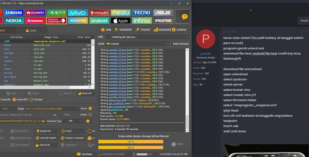

issue: auto restart (try palit battery at tanggal switch pero no luck)
program gamit unlock tool
download file here:You do not have permission to view the full content of this post. Log in or register now. credit kay boss Nasher@25
download file and extract
open unlocktool
select qualcom
check server
select brand: vivo
select model: vivo y71
select firmware folder
select "rawprogram_unsparse.xml"
click flash

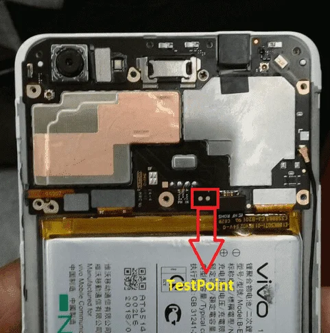

turn off unit baklasin at tanggalin ang battery
testpoint
insert usb
wait until done

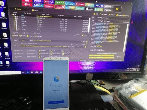

mga boss bakit sakin nag failed
mga boss ano po dapat kung gawin para ndi mag failed?
crack lang po ang gamit kong unlocktool
Pano paps kung no display possible lcd diba po pero wala kasi syang basag or kahit ano bigla lang sya namatay habang ginagamit tpos pag chinacharge working naman sya wala lang display also pag sinasaksak naman sa pc nadedetect din
