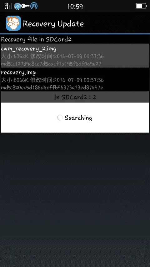

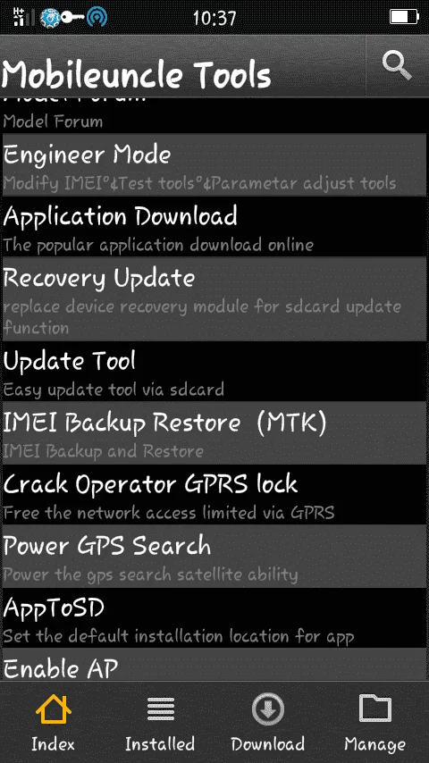

Magdownload ka ng stock recovery ng cp mo eg: "recovery.img" tapos download ka
"mobile uncle tools.apk"
"Rooted ang cellphone"
Dapat nasa sdcard ung recovery.img mo para mabasa ng mobile uncle tools
Tapos click mo "recovery update"
Pag nasa recovery update kana click mo ung "recovery.img" na dinownload mo tapos automatic reboot ang cp mo at yan nag flash kana ng recovery mo

SALAMAT dito sir! (Y) try ko maya.
