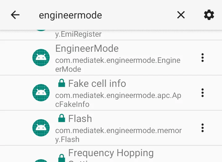

2. Using Activity Launcher; You do not have permission to view the full content of this post. Log in or register now. on Google Play.
• Open Activity Launcher
• Search the name “EngineerMode”
• Find the name called EngineerMode (com.mediatek.engineermode.EngineerMode) and then open it. (Ignore the secured ones)
• Finally, you're in the Engineering Mode

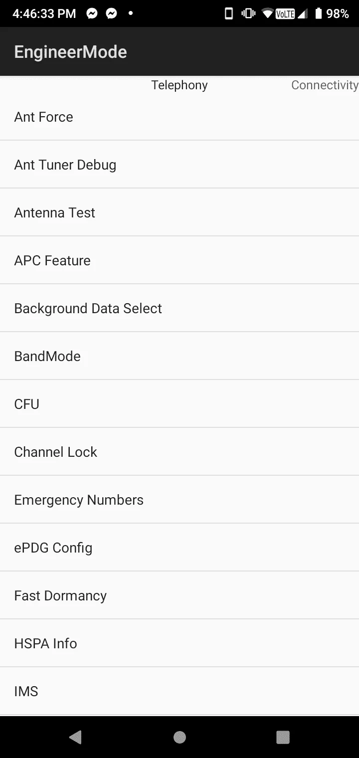

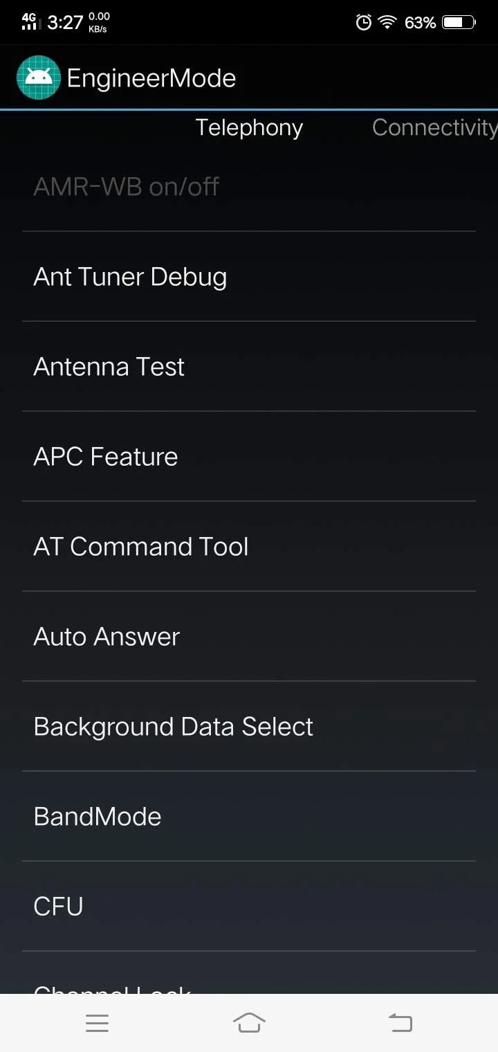

What is Engineer Mode Looks like:
(Actual screenshot of EngineerMode on vivo Y91c, and Cherry_Mobile Omega X.)
So you can configure BandMode, IMS, Misc Feature Config, and Network Selecting.
This is a real Engineer Mode, some of these is almost identical. This is exclusive only for any MediaTek platforms.

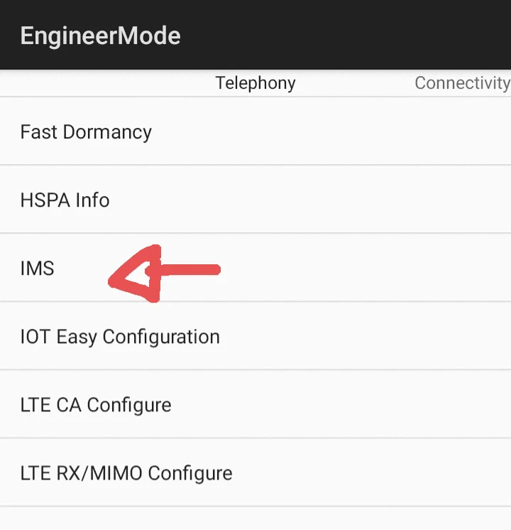

Step 2: Tap IMS
Step 3
: Select your network slot you have. In which SIM card is mounted to
Step 4: In the VOLTE Setting section, change the setting to “CMW500 setting” from Default setting
Step 5: Hit “SET” the button.

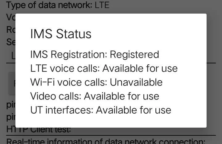

Tip 1: Looking the real-time info about Phone Info
To access the cell/phone info you have 2 ways to do:
1. Using NetMonster; You do not have permission to view the full content of this post. Log in or register now. on Google Play.
• Open NetMonster
• In the first time, grant all 2 required permissions
• Tap “More Options” (3 dots) in bottom right side
• Select “Phone Info ↗”
• Finally, you can show the cell info

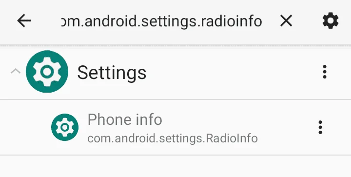

-You can also use Activity Launcher (You do not have permission to view the full content of this post. Log in or register now.) to search the public activity to be accessible.
Search the name: “com.android.settings.RadioInfo”

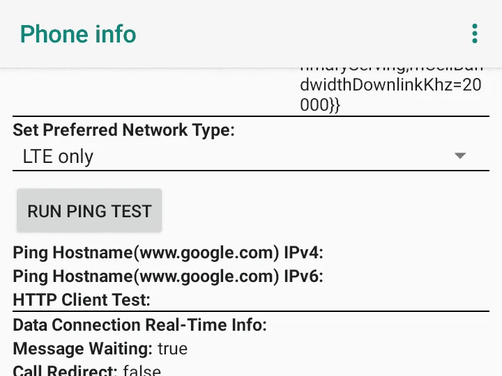

2. Enter using the native dialer app 📞
• Open your native dialer app (Phone)
• Enter the code ★#★#4636#★#★
Now, you can see the full info such as IMEI, Phone number, Signal Strength, Voice Network Type, Data Network Type, VoLTE Provisioned, Video Calling Provisioned, and more.
And also you can see the info about IMS Service satus in Cell info.
-Related: Enable ViLTE in Tip 3 to bypass IMS Status makes it available to use for Video calls over LTE.

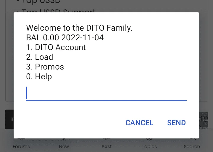

Tip 2: Enable USSD Support using EngineerMode (Optional)
- It requires VoLTE to be enabled.
• Open EngineerMode (See above)
• Tap IMS → Choose your network slot
• Tap USSD
• Tap USSD Support
• Switch it “ON” and then hit SET.
To test it out, open your native dialer app. Enter ★185# and hit Dial button 📞 with DITO.
This is the USSD dialog that shows the Welcome message.

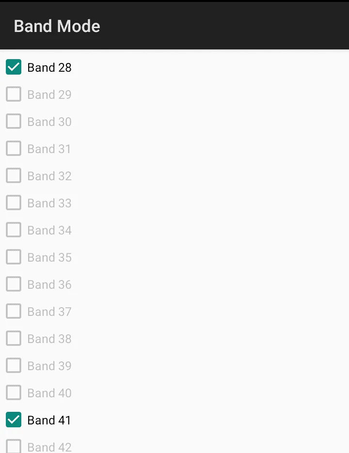

Tip 4: Lock LTE Band using EngineerMode
• Tap BandMode → Select your network slot
• In LTE mode selection, check/uncheck the band you like (On DITO, Band 1, 28 & 41 are supported.) Uncheck some of them to ignore the signal recieved to the device.
• If you have done, then hit SET to apply the change.
*To revert your changes, hit RESET TO DEFAULT and then hit OK to reset it's default band settings.

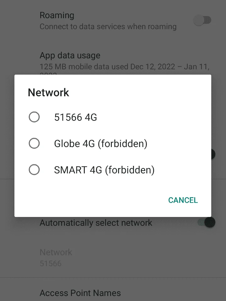

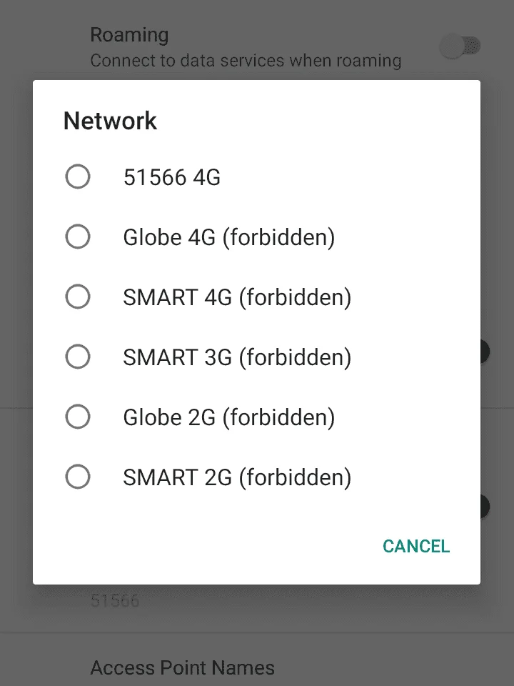

Tip 5: Change network from 4G pref (3G/2G) to 4G LTE only using Engineer Mode.
• Tap Network Selecting → Select your network slot
• Select the drop-down menu to select the option and change it to LTE only (from LTE/UMTS/GSM). After that, it will set immediately as 4G LTE only.
This is a great idea to save energy by disabling them the legacy networks and leave us only 4G LTE only to your DITO SIM, and saves time searching for network.
The image result when switching from LTE/UMTS/GSM to LTE only.
51566 4G is a DITO network.
