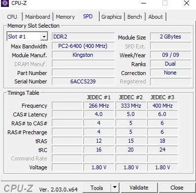

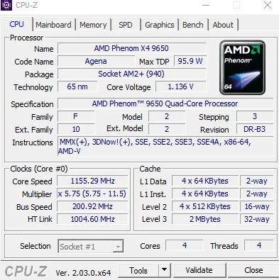

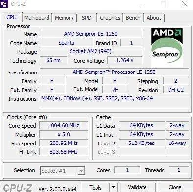

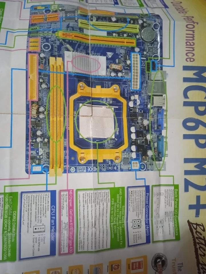

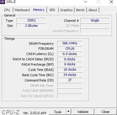

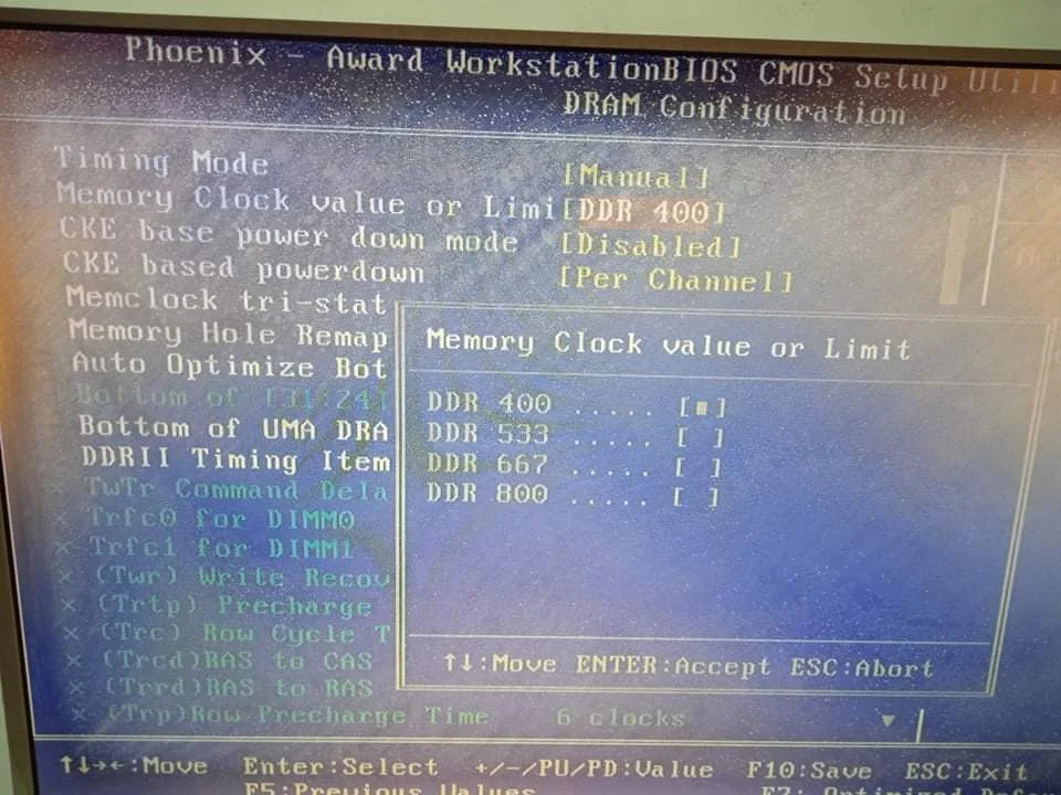

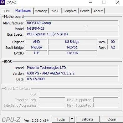

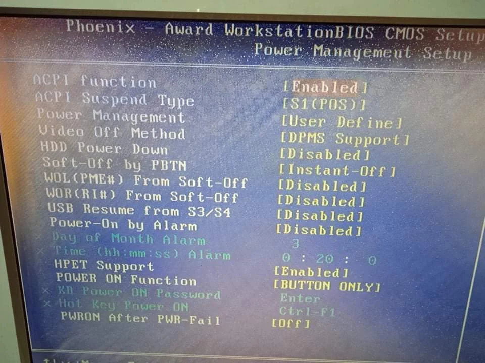

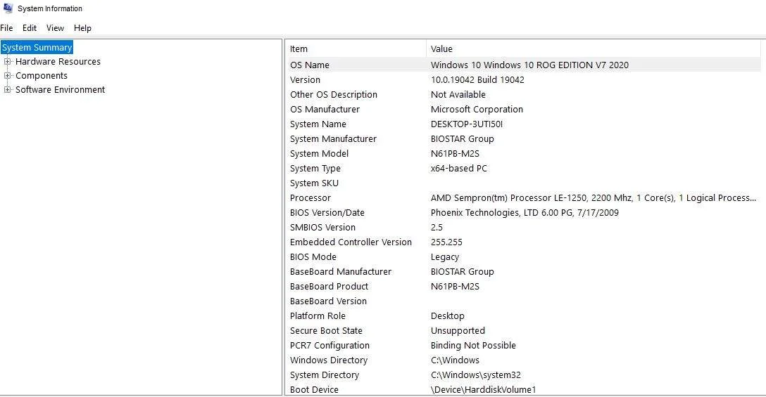

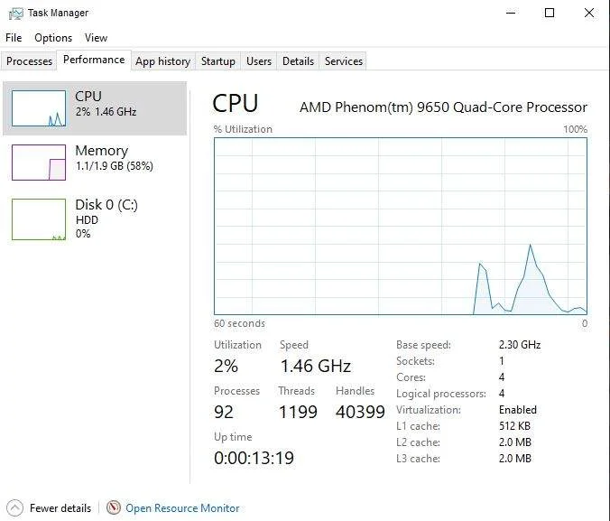

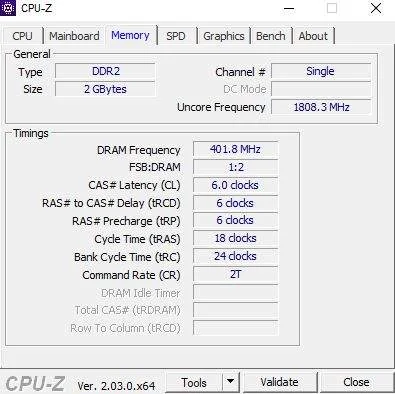

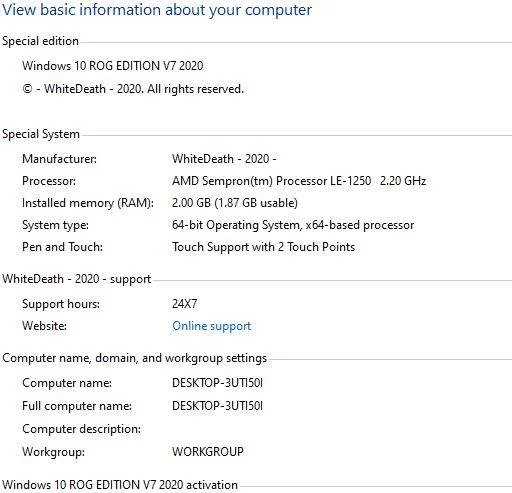

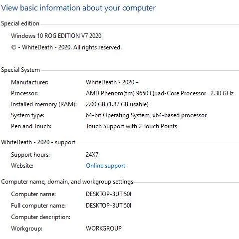

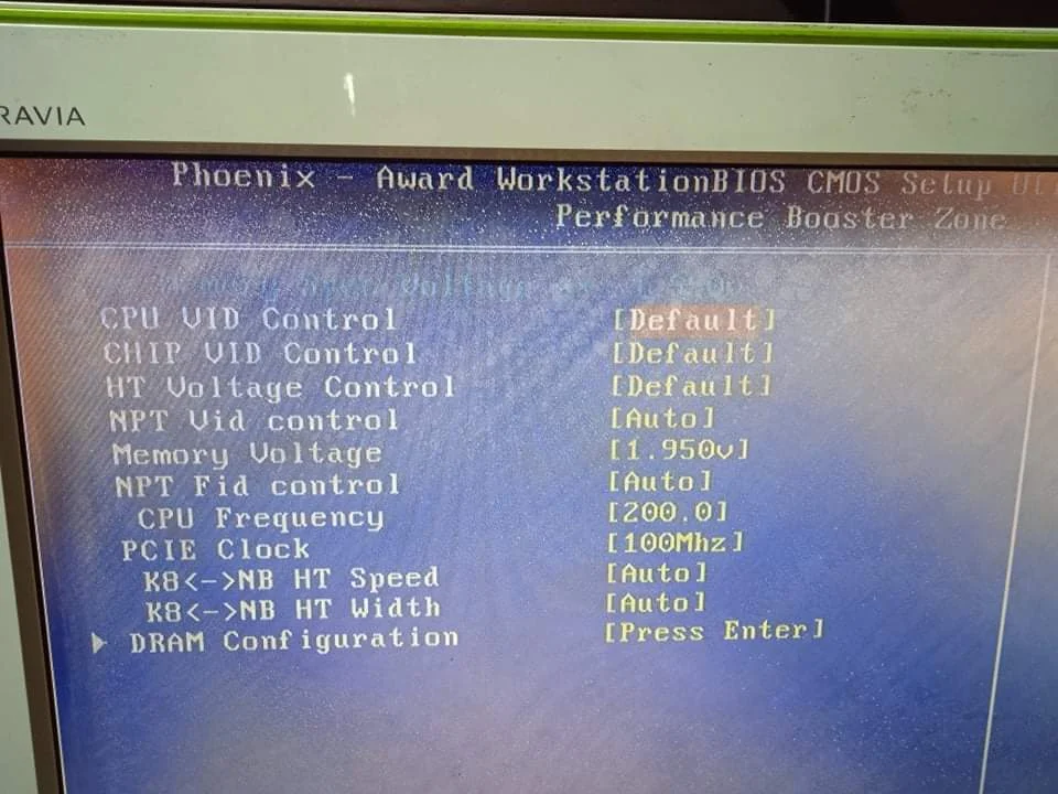

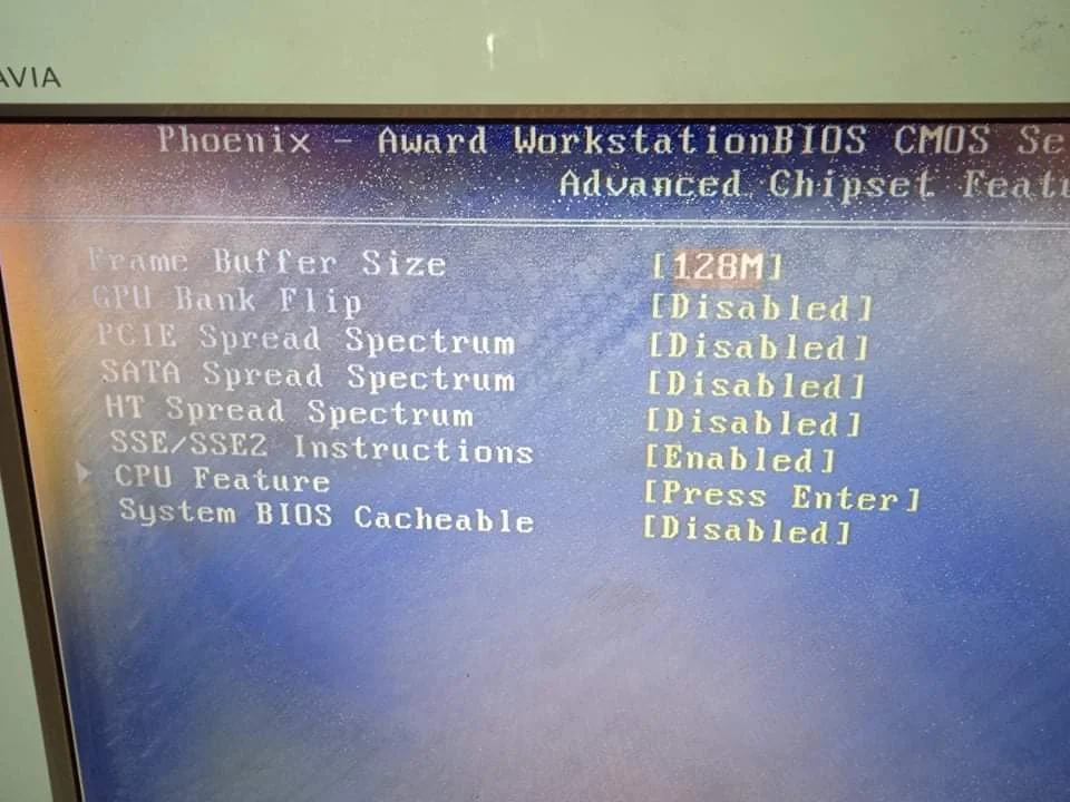

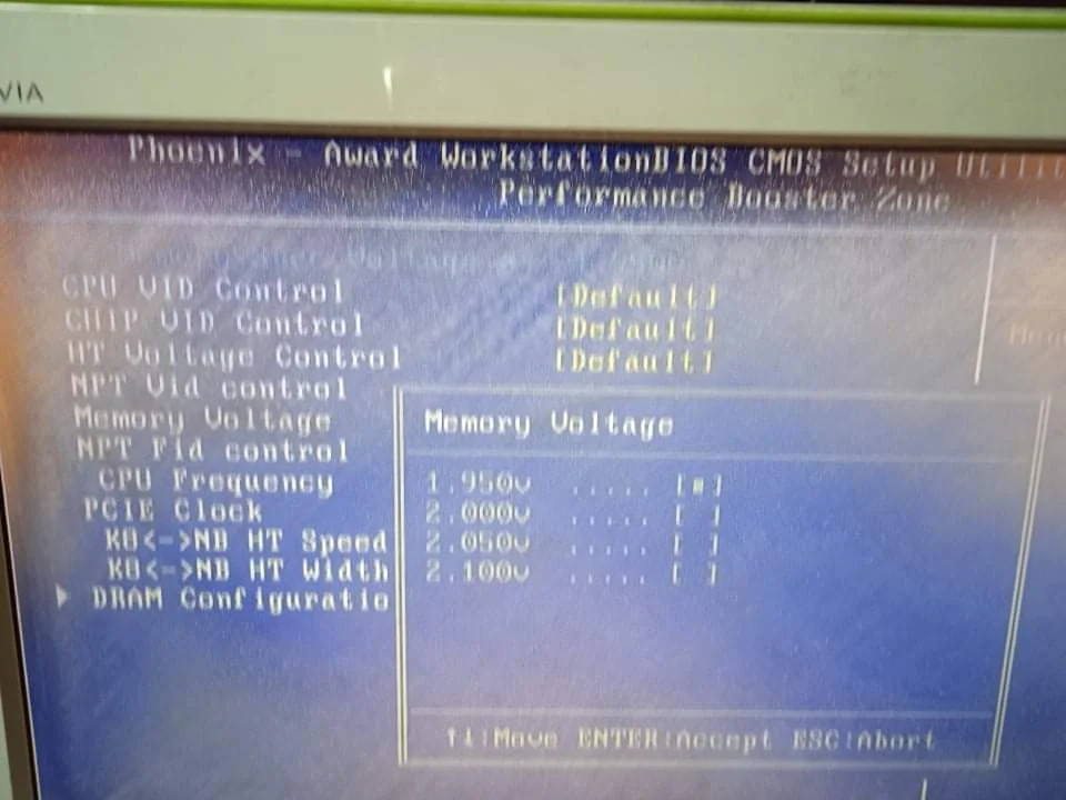

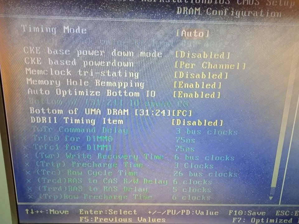

bossing sana matulungan mo din ako, luma na pc ko ,dati syang sempron ,bumili aq sa shopee phenom x4 9650, un lang kaya ng budget ko, nakakahiya man dahil very old na ung cpu,naiinis kc ako manood lang ng movies pahinto hinto pa ,di kona nga ginamit sa games nakakwisit,kaya pinalitan ko, ang problema pag boot ayaw black screen din pero pag binalik ko un sempron ,ok nman, ano kaya problema boss?? memory ko 800mhz

well first ano exact model ng sempron cpu mo
kase lima yung klase ng sempron cpu
version 2000, version 2003, version 2009, version 2011, version 2014
pareparehas sila ng socket so kasya lahat ng amd cpu sakanila pati ryzen kase PGA sila
pero my max cpu support yang socket nila
2000 to 2003 is socket 462 and 754 = di sya tatangap ng phenom x2
2009 to 2011 is socket AM3 and AM3+ ito lang tumatangap ng phenom x2
2014 is socket AM1 = di rin tatangap ng phenom x2

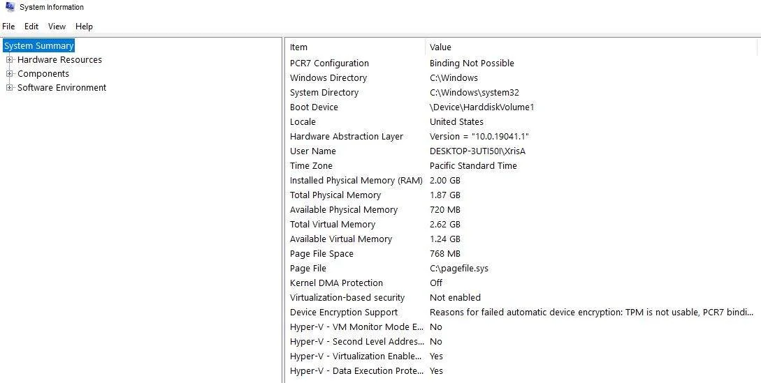

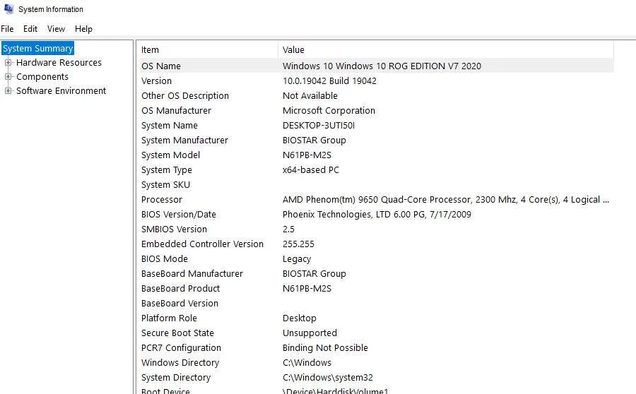

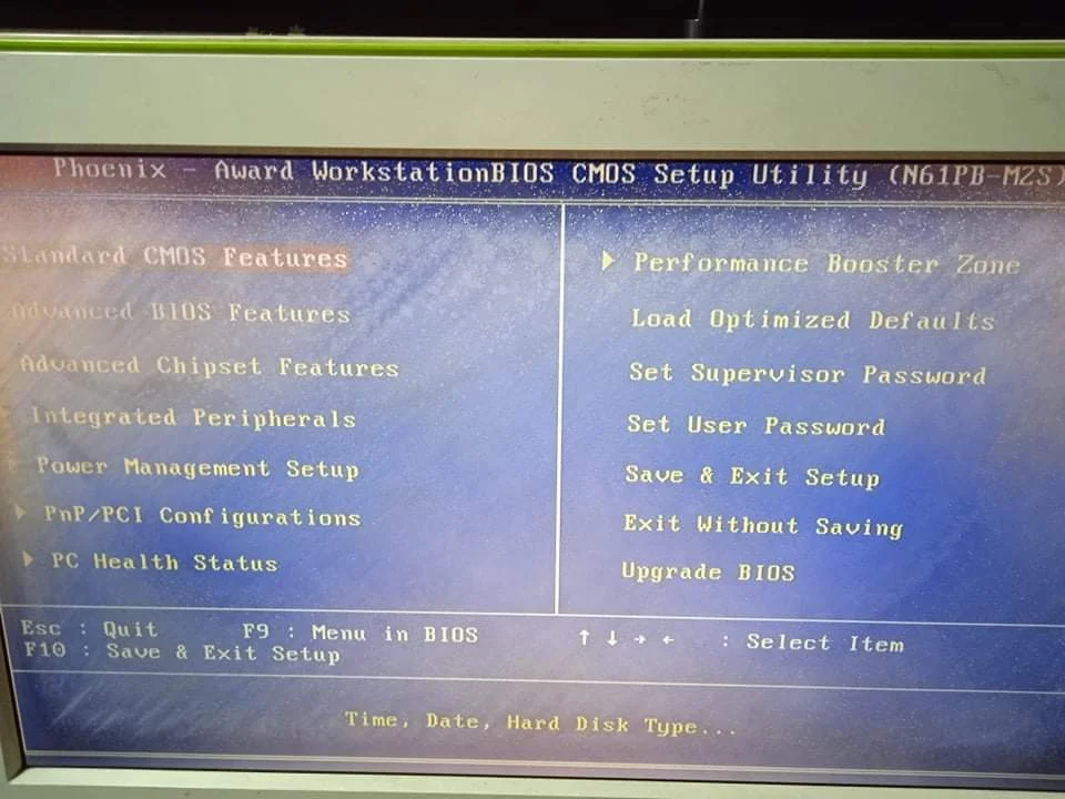

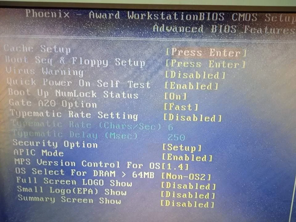

thanks po sa reply kagigising lang,,mag almusal lang ako sir ,, ipopost ko lahat ng screenshot ko about sa pc ko,,sana matulungan thanks po.
sori po for keep u waiting nagpost napo ako ,nakatag po kayo
senxa napo sa monitor malabo ,wala pa pamalit ,
received_816476716342497.webp received_817096439535341.webp received_803168924313306.webp received_647667726953188.webp received_553796776470594.webp received_5472759572849548.webp received_513490287335138.webp received_406440541567480.webp received_2892510440893143.webp Capture1.webp Capture2.webp Capture3.webp Capture4.webp Capture5.webp Capture6.webp Capture7.webp Capture8.webp
boss thank u po sori 4 late reply, brownout, ngaun lang ,,sinunod kopo un instruction nyo umokey na ,,kailangan pala clear cmos then dun sa cmos battery 10 min ko ,bago ibalik ,,power on ,punta sa bios menu clock date, the reboot ..ayus na ,,salamat ng marami sir
