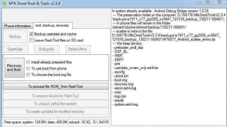

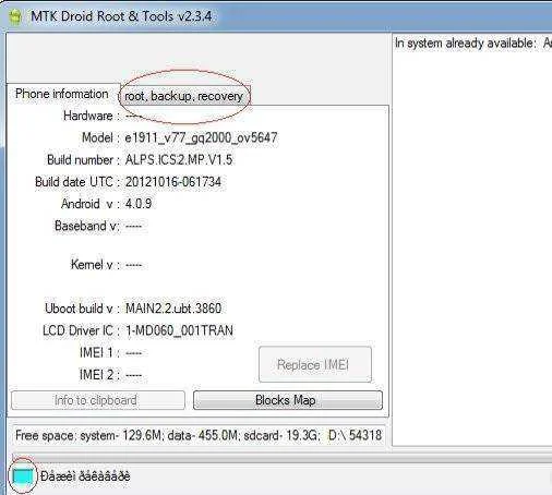

2. Plug your phone in (with USB Debugging enabled) and you should see a screen like this one, the blue status bar shows that your phone is succussfully connected:
3. Go to the ‘root, backup, recovery’ tab, as circled above.

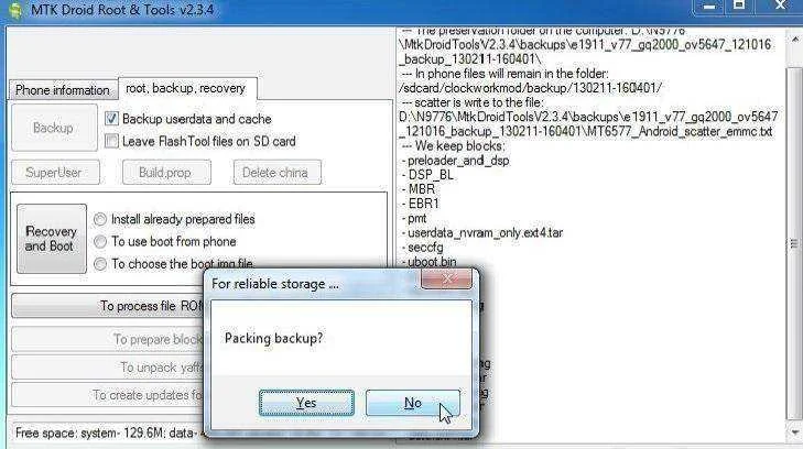

4. Check the ‘Backup userdata and cache’ box (as shown above) and click ‘Backup’.

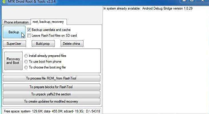

5. Now your full current ROM will be backed up, this part may require some patience as it can take a while. You’ll get a screen like this:
6. You’ll get a pop-up asking if you want ‘Packing Backup?’ Select ‘No’ as seen in the image below.

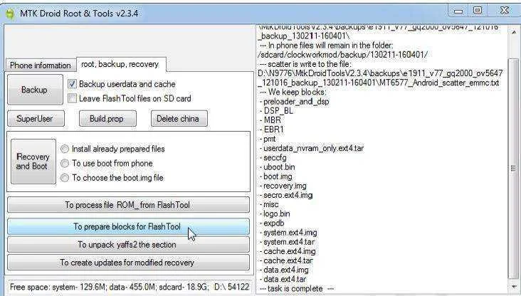

7. Once the ROM backup is complete then click on ‘To Prepare Blocks For FlashTool’ as can be seen below:

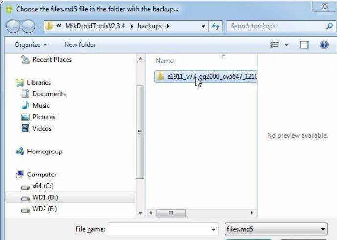

8. Next you have to select the the md5 sum file, to do this just browse the backups folder and there’ll be a folder entitled with the name of your phone. Open this folder.

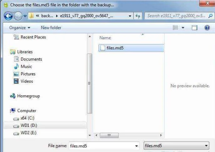

9. Inside this folder is a file entitled ‘files.md5’, click on it.

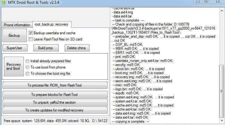

10. After selecting files.md5 you’ve completed the creation of Blocks for Flash tool, and you’ve backed up your ROM.
