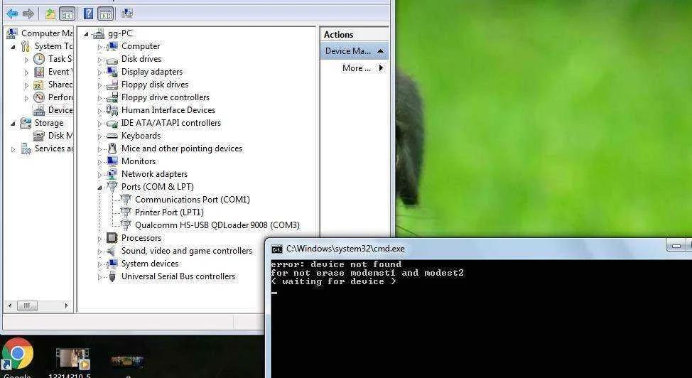

bat po ganun. mdedetect nmn po ung CM Omega Icon q pero nd po cia mkita pg.nag.flash na. device not found ung nkalagay.
-need help po plzzz. tnx guyzzz.
