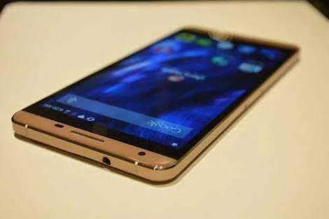

Unit : Cherry Mobile Flare S4
The only way to bypass the privacy protection password prompt is to flash new ROM. Unfortunately, many phones now come with this installed and there is no good way to bypass it if you never set it up in your phone.
Hard resetting does nothing for this issue.
The stock ROM for the Flare S4 is found here at You do not have permission to view the full content of this post. Log in or register now.
Install ROM: Install with SP MDT:
Ready?
1.Turn off your Flare S4.
2.Remove the battery then re insert the battery.
3.Connect your Flare S4 to a PC using a USB cable.
4.Wait for your PC and phone to sync then and show that it recognizes the device and disconnect.
5.Run the SPMultiPortFlashDownloadProject.exe from NeedROM.com that you downloaded.
6.Select File>Open File Agent download and select the file MTK_AllInOneDA.bin which is found in the folder SP_MDT.
7.Choose Scatter File and select the MT6753_Android_scatter.txt file which is found in the folder with the ROM.
8.Click Start All.
