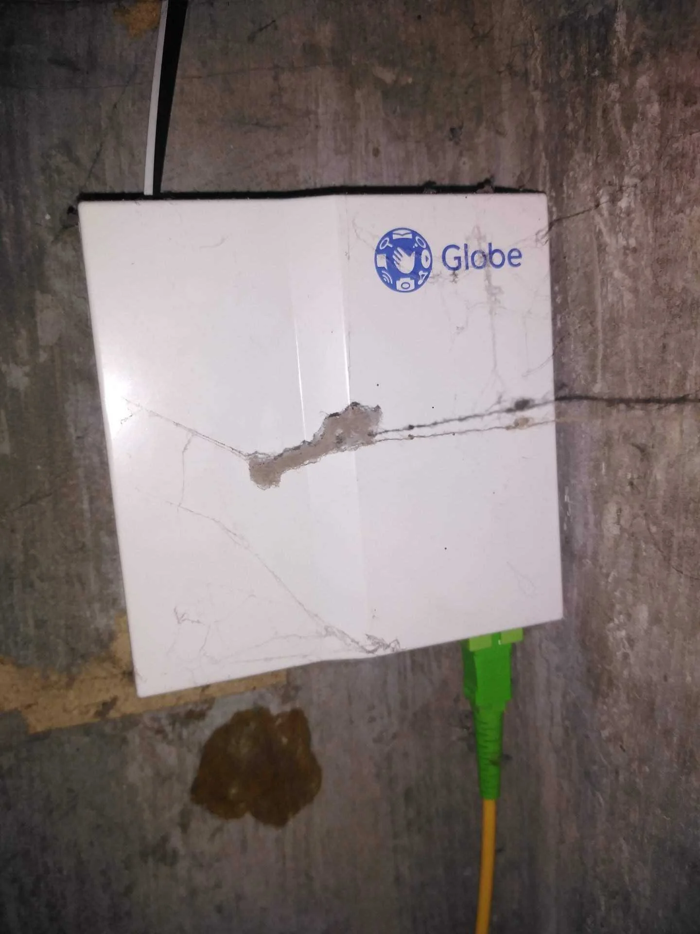

Picturan mo Modem mo paps, baka sa ρá†ch cord problema

Ito pic boss

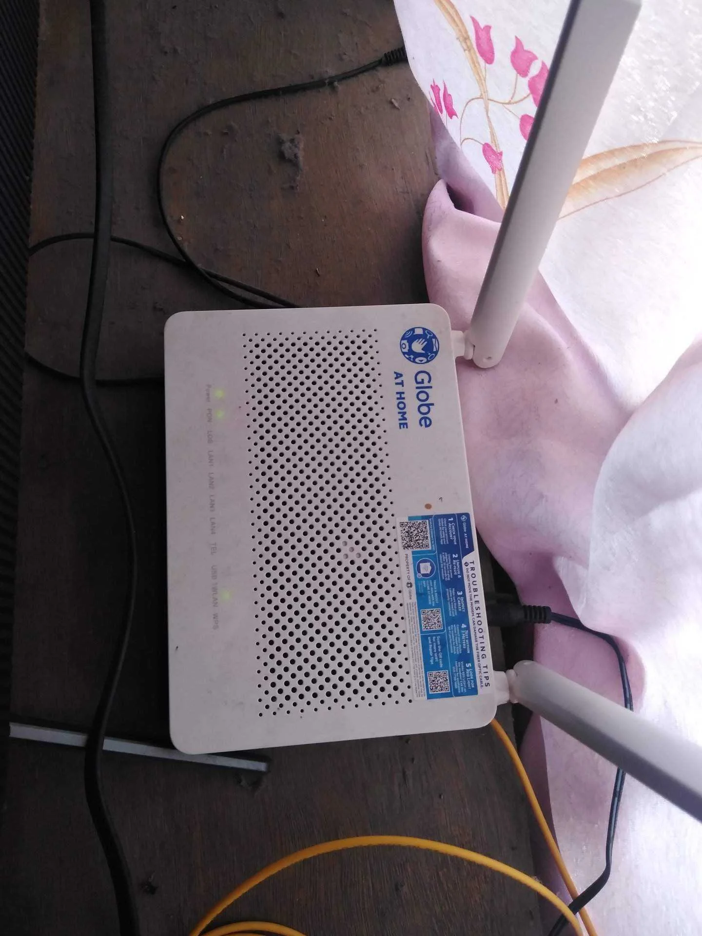

yung modem paps, tignan ko kung anu-ano nailaw.

okay, may internet nga. try mo bunutin yung kulay dilaw (ρá†ch cord) tapos salpak mo ulit.
Diyan sa Modem at dun sa Passive Receiver mo(yung unang sinend mo na pic).

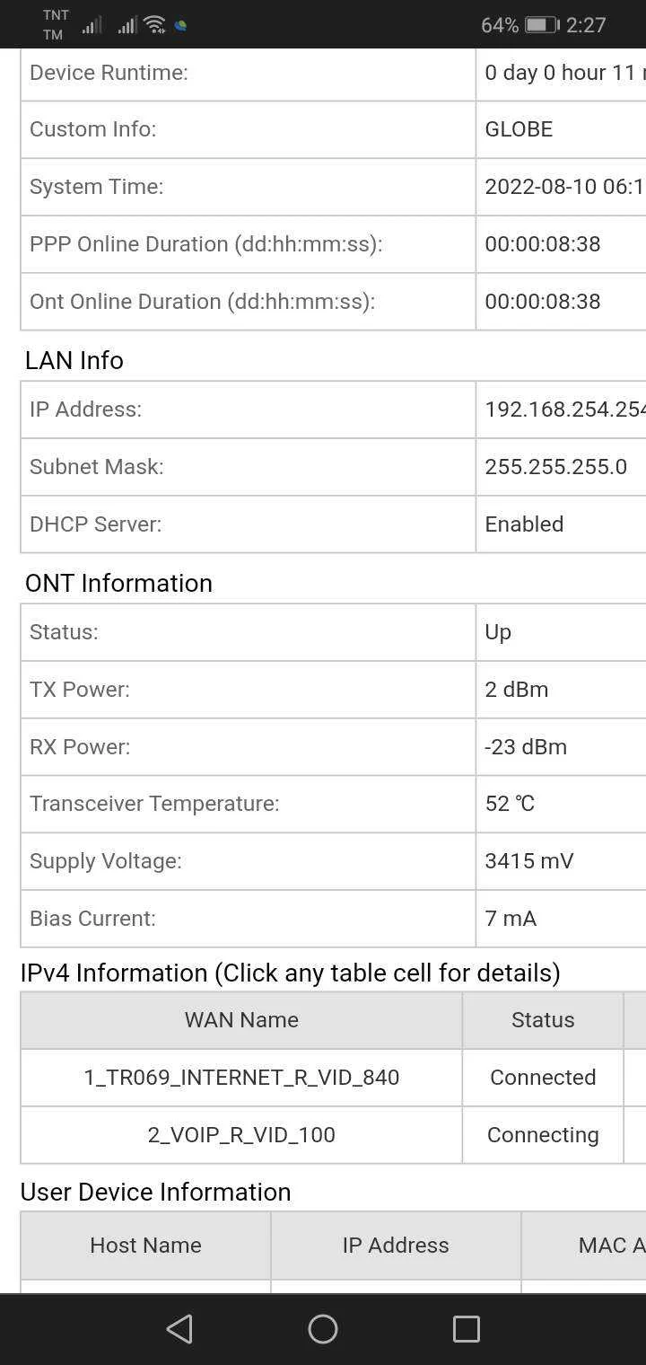

iba iba kasi location makikita yung Signal eh. eto sakin sa Huawei 2.4ghz
ONT Information
Current ValueReference Value
Optical Signal Sending Status:AutoAuto
TX Optical Power:1.84 dBm0.5 to 5 dBm
RX Optical Power:-23.37 dBm-27 to -8 dBm
Working Voltage:3393 mV3100 to 3500 mV
Bias Current:17 mA0 to 90 mA
Working Temperature:59 ℃-10 to +85 ℃

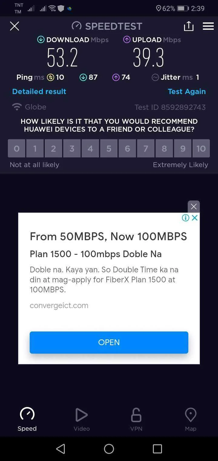

patingin ako ng internet speed

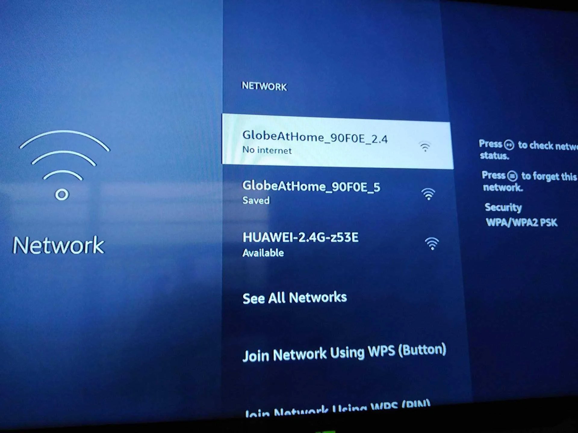

Maganda naman dito sa cp ko yung speedtest. Pero minsan kahit dito sa cp ko nawawala yung signal ng wifi, makikita ko na lang wala yung icon pag nawala yung sagap
