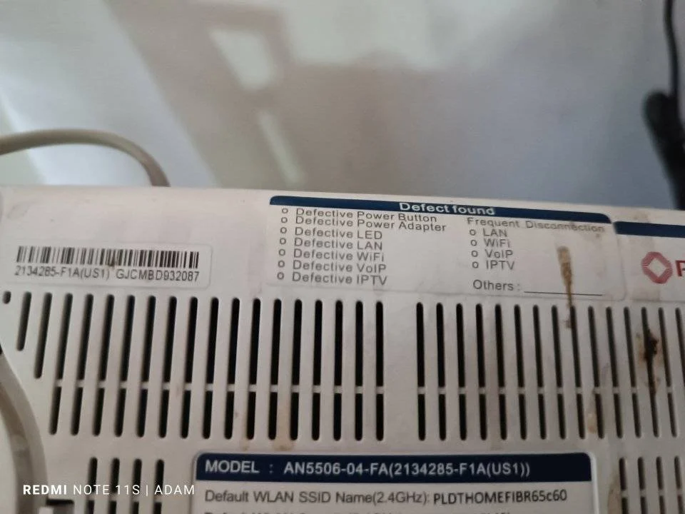

gpon modem, ako mismo nag configure nung ni reset ko modem at na access ko naman noon lahat ng acct (admin,adminpldt at superadmin).Ngayon d ma access yung adminpldt kahit nagawa kona lahat.
Anong exact brand/model?
Huawei or Fiberhome?
If Huawei, anong exact model?
If Fiberhome, anong exact model?

Method II. Disconnecting the fiber optic cable
Applies to: AN5506-04-FA (RP2649)/HG6245D (RP2740/RP2804)
❗Note: FiberHome has removed the fiberhomesuperadmin account on this version so the steps are different.❗
a) Disconnect the fiber optic cable by gently pulling the blue connector from the white box.
b) Restart the ONT.
c) Go to You do not have permission to view the full content of this post. Log in or register now.. Try entering your old adminpldt password if you have changed it before. If it doesn't work, use the credentials below to login to the adminpldt account.
Username: adminpldt
Password: z6dUABtl270qRxt7a2uGTiw or Mj5UI3OPr9vYq8bCxl1rV50E
d) Configure the settings you need to.
e) Logout of the adminpldt account.
f) Plug in the fiber optic cable.
