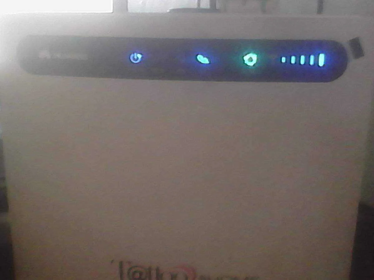

Hallo, after i reset my router with hold wlan+wps button and press the reset all togrther it lookks no so.
and when i make cmd ipconfig it shows me 169.254.68.113
but i can not connect to the modem. what must i do?? thx advance
