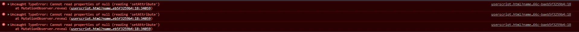

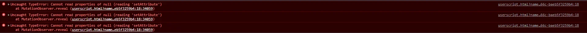

Ito lang probs sakin nag i-error ..
kaya walang button sa lower left ..
*UPDATE:
ok na pala nasa Page 4 yung updated script.
