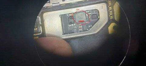

Nalowbatt , nag open saglit pero di nagtuloy sa home screen.
May iba pa kayang solusyon bukod sa palit ic?
Pwede bang ire program nalang?

Open the back cover of your phone if you can (Be careful syempre)
unplug the battery, and remove the shield/cover
just like in the picture, (leave it open)
replug the battery, then charge,.. I'm pretty sure it would turn on... :D
