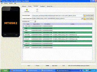

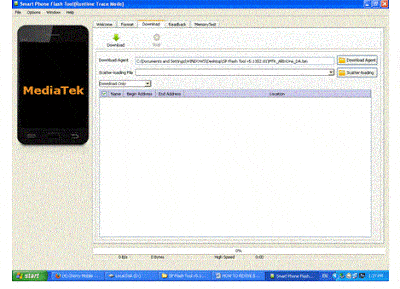

Go back extract then run spflash tool
Load scatter file. Locate MT6582_Android_scatter_emmc.txt
Uncheck Preloader for bootloop
Check PRELOADER for deadboot..
then check all...Tick Download

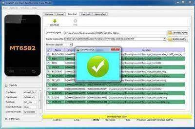

Now Connect Your FUZE w/o Battery .. Then Insert Battery After 2 - 3 sec ..
Close SP Flash Tools, remove device from computer
Remove Bat Then Re Insert ..Wait til the Process is Done until it finish Green Check..
Then reboot your phone
revive complete..
