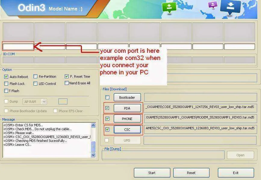

Flashing your Phone
1. Open Odin 3.07
2. Load the file (PDA Only). Click on PDA then look for the firmware that you had extracted.
*** For Rebootloop you can only check PDA, PHONE and CSC. (This is only base on my experience, because flashing PIT is dangerous too. You might brick your phone.)
PIT --> J13G.pit
BOOLOADER --> BOOTLOADER_BL_J100HXXU0AOA1_CL333157_QB3542504_REV 01_user_low_ship.tar
PDA --> PDA_AP_J100HXXU0AOA1_CL333157_QB3542504_REV01_user _low_ship.tar.md5
PHONE --> MODEM_CP_J100HXXU0AOA1_CL333157_QB3542504_REV01_us er_low_ship.tar.md5
CSC --> CSC_OXE_J100HOXE0AOA1_CL333157_QB3542504_REV01_use r_low_ship.tar.md5
Picture is example only.
3. Do not check repartition.
4. When you are ready to flash your phone, Press and Hold Volume Down + Home Key + Power Button, a selection will appear if you would like to go in Download Mode, Press Volume Up to proceed in Download Mode.
5. Connect your phone in the PC via USB Cable, wait for a value in the ID:COM to appear. It will turn yellow with number example: COM32, if it nothing appear close Odin an open it again and load the file again.
6. Press START to proceed flashing your phone. Wait until it is done, the phone will reboot after flashing.
