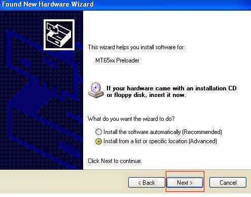

  4. In your computer, it must detect your phone and it will install the MTK Preloader or Mediatek USB VCOM driver.
  5. Repeat 1 to 4 if it does not detect your phone.
  6. If MTK Preloader/Mediatek USB VCOM Driver is installed you are good to go in flashing your phone ^_^

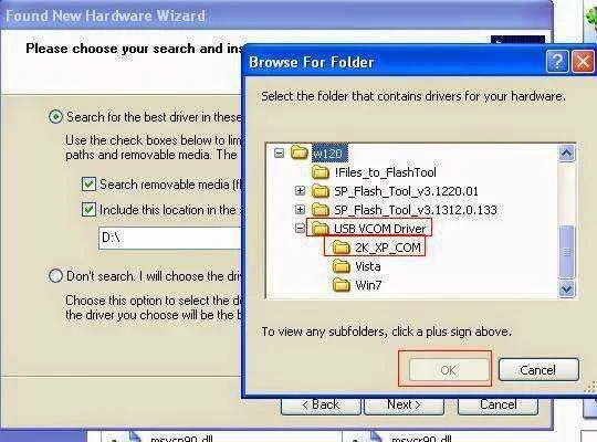

When installing it manually your phone must be turned off, then connect it to your computer/laptop while pressing VOLUME UP or VOLUME DOWN. This will detect and look for the driver.
1. This is the first time that you will connect your phone and it will search for the correct driver.
2. Check include this location ... ... and click on browse. Look for USB VCOM Driver and Click on 2K_XP_COM folder if you are using Windows XP or Win7 for Windows 7 and then press OK when you are done picking the right folder for the driver.

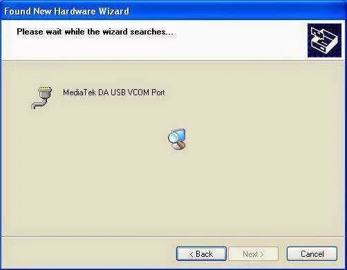

3. If the driver is successfully installed MediaTek DA USB VCOM will appear in the New Hardware Wizard.

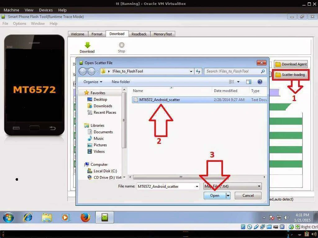

2. In Flashtool, Click on Scatter-Loading, and load your scatter file. (see example below)
Example only, May differ depending on phone

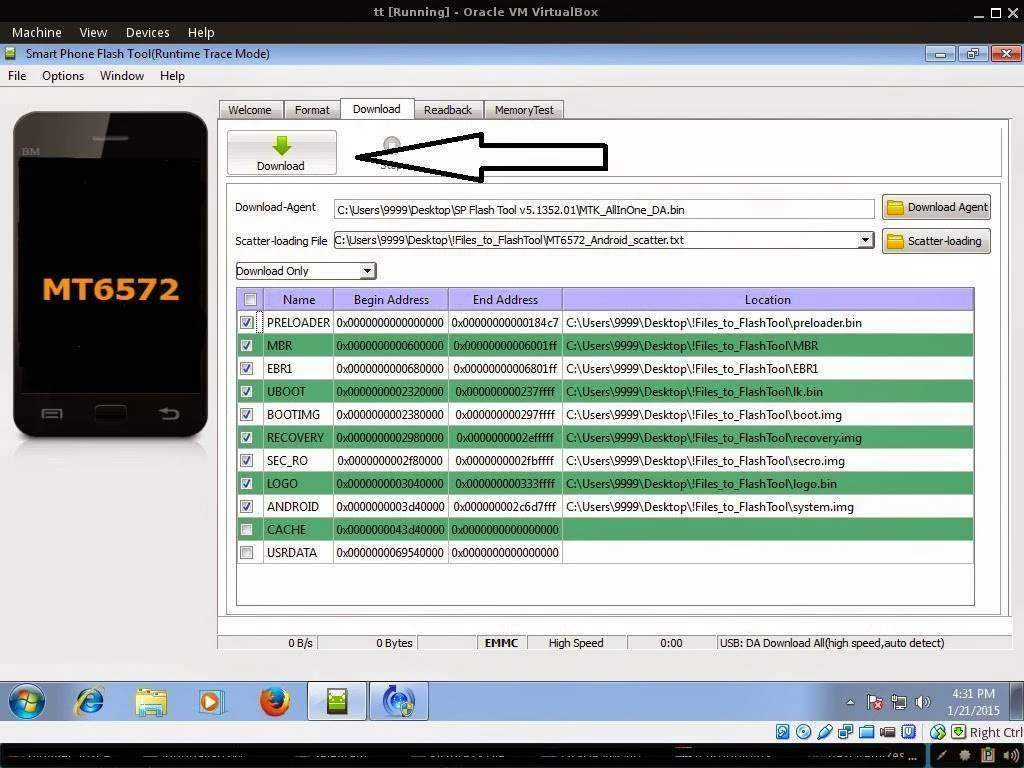

3. After you load the file, UNCHECK PRELOADER and DSP only (Never flash preloader and DSP if available in firmware) If you can't proceed flashing without these two files then proceed at your own risk, press Press Download to Flash your Phone.
