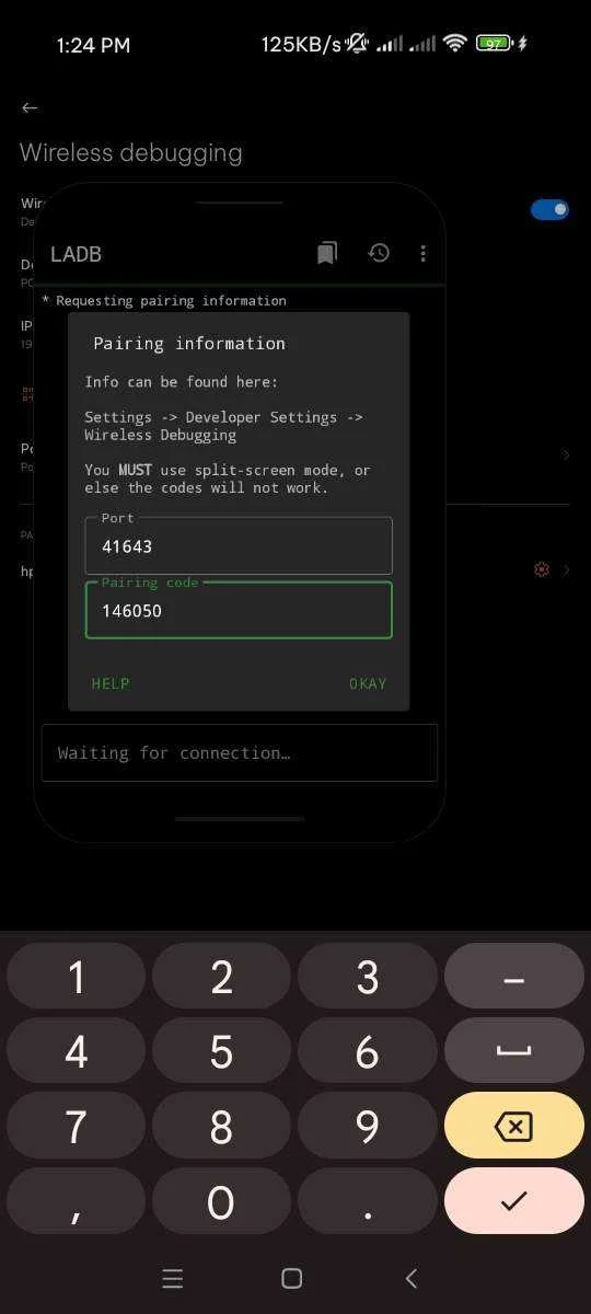

7. Open LADB app, it shows Pairing Information
  • Port (get port number by accessing Wireless Debugging)
  • Pairing (get pairing code by accessing Wireless Debugging)

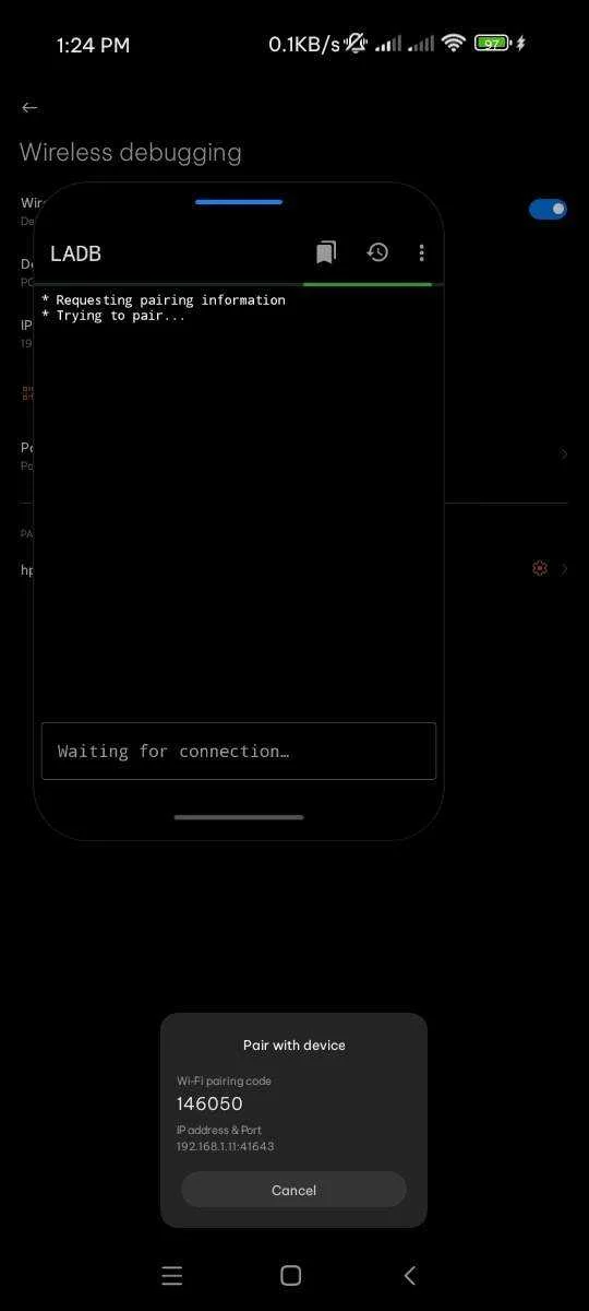

8. Go back to Wireless Debugging and use floating windows, choose LADB (2 apps running in overlap)
9. Tap Pair with Device in Wireless Debugging, it shows
Input Port (get the last 5-digit port number from IP address & Port & add it to LADB)
Pairing Code (6-digit Wi-Fi pairing code & add it to LADB)

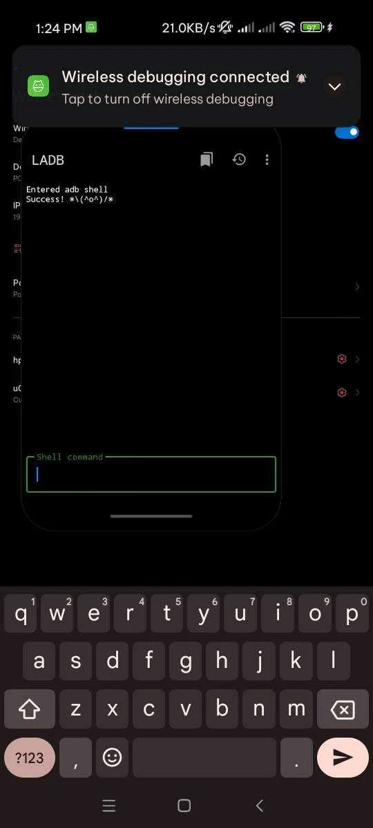

Once it is done, tap Okay in the LADB app to connect to ADB shell (wait 10 to 30 seconds), it creates a command with Success!

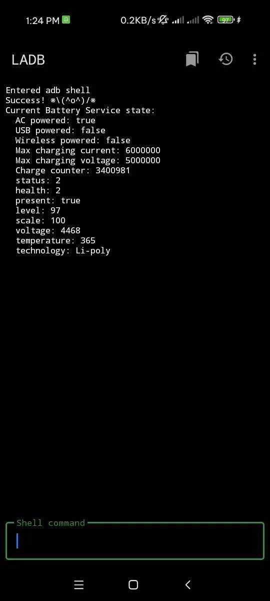

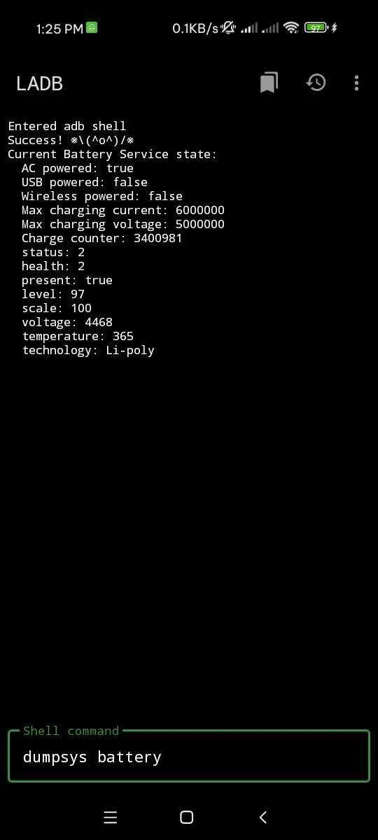

10. To show battery information, in shell command, type dumpsys battery without quotes.
Decoding values in response to a command:
  • Charge counter: only first 4 number you need. I have 3760 (that's mean my battery have 3760 mAh when it fully charged). After you find the current capacity, take the declared capacity from the manufacturer and subtract the current one from it. You will find what is the loss of capacity of your smartphone. Example Mi 9T (4000 mAh - 3760 mAh = 140 mAh this figure is the lost battery capacity, but do not forget about the error in the battery capacity from the manufacturer 0.5%).
* Status have 5 stages:
1 - issues with reading battery info
2 - charged (not full)
3 - uncharged, but connected to usb or charger
4 - uncharged
5 - Fully charged
* Health also have 5 stages:
1 - Excellent
2 - Good
3 - Normal
4 - Poor (need new battery)
5 - Very bad (need new battery)
  • Level - How much is currently charged
  • Scale - at what charge will the maximum battery capacity be
Additional note: For accurate measurement, do shell command dumpsys battery for newly calibrated battery (0 to 100% charge)

Btw, does 2 mean na may maliit na damage na ang battery?
Bagong bili kasi tong phone then hinahard game ko. Nadamage ko kaya yung battery?
2 on Battery Health status means Good.
If you are unsure of your battery health status, you can calibrate your battery again by discharging it to 0% and charge it to a 100%
baka mag 1 ang status yan means Excellent, otherwise yan na talaga (playing a game produces heat e, saka charging cycle)
