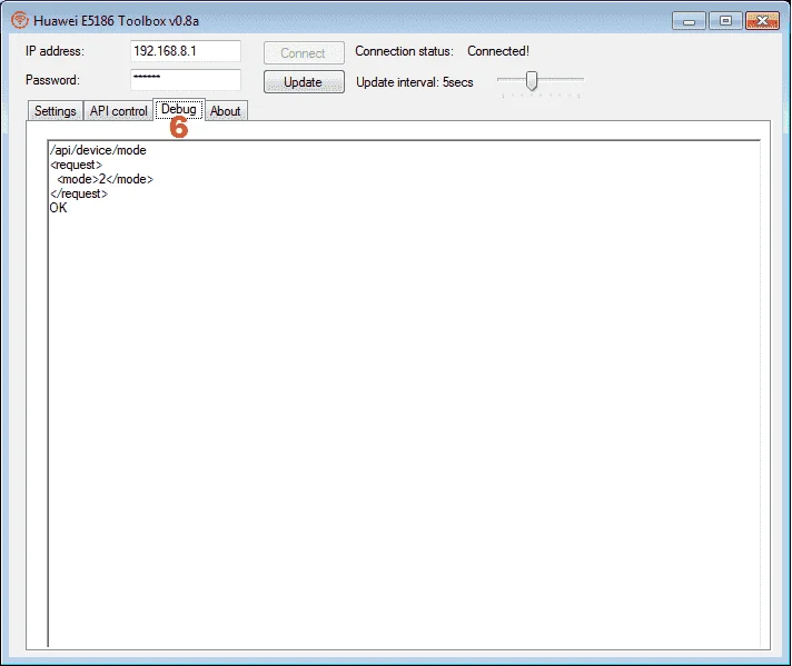

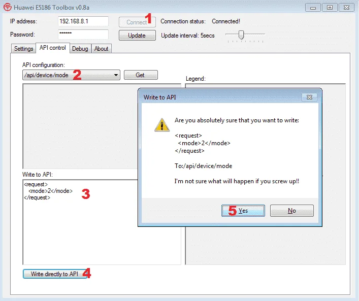

1. Connect 936 sa LAN, Open E5186 Toolbox, enter admin password, Connect. Huwag i-click ang GET. See SS.
2. Confirm if OK ang response and Exit.

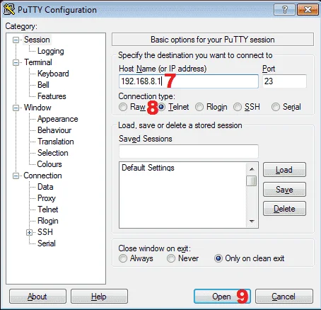

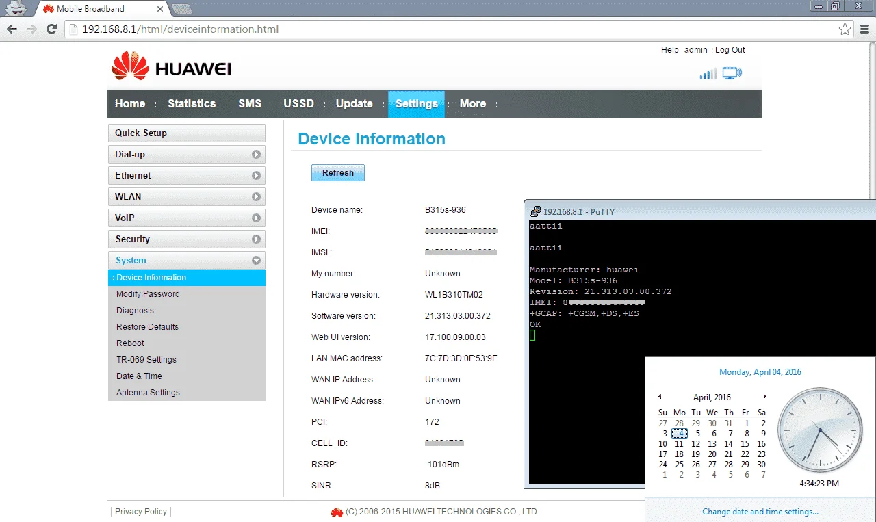

3. Open PuTTY, type IP, select Telnet, Click Open or See the screenshot. Pwede rin, open cmd, type telnet 192.168.8.1
4. Type ati (aattii in putty) to confirm na connected tayo sa modem at ung commands sa baba.
at^sfm=1
at^reset

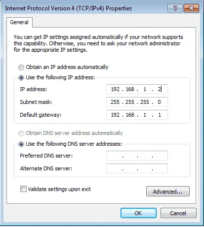

6. Set static IP.
(You can use the IP from the attached image, if ever the flashing is failed and the LED turns RED, try to use this one, credits sa B315s-936 Debranding Tutorial.)
IP= 192.168.1.100
Subnet Mask= 255.255.255.0
Gateway= 192.168.1.1
Preferred DNS= 192.168.1.1 yung sa baba secondary blank na then ok

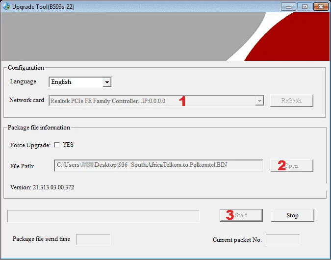

7. Open Multicast Upgrade Tool, Select Network Card, piliin kung anong firmware ang gamit niyo sa modem at kung ano gustong ipalit, click Start.
(Requires USB Cord)
