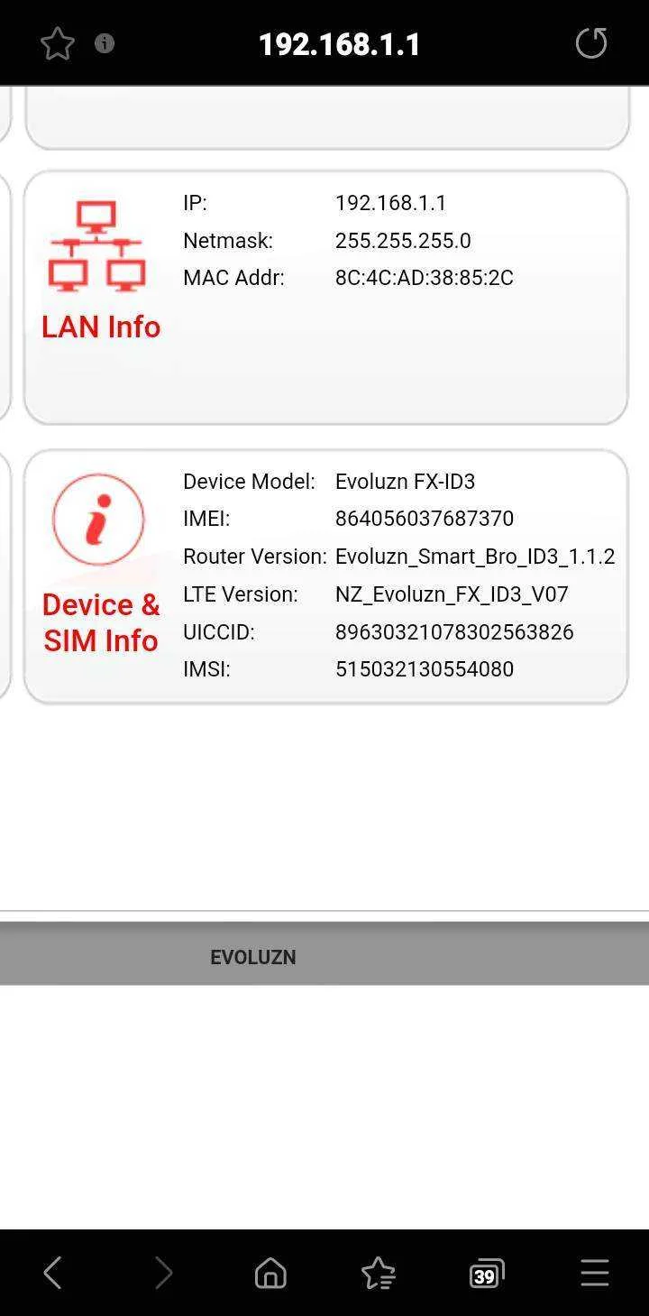

Here you can download the LTE/Baseband firmware to upgrade or downgrade on Evoluzn FX-ID3.
Code:
V05 (recommended): Evoluzn_FX_ID3_V05_LM89_AT2.22_V05_20170928
sha1sum: a86021e5c7ac8e30e5b40c012483ba509bd047ae
Code:
V07: Evoluzn_FX_ID3_V07_LM89_AT2.26_V01_20191129
sha1sum: 7f052feec1cc61d38732afb26f80456637148b70
If after the update has finished and the unit restarted, you notice that the WiFi/AP doesn't come back and the signal is blinking red, wait for 5 minutes and then power cycle the unit. It should then work normally.
I have successfully downgraded mine from V07 to V05 running v1.2.4.
