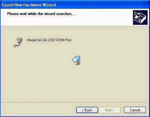

Installing Driver with AutoInstaller
First try the Alternative Driver, which is the You do not have permission to view the full content of this post. Log in or register now.. Just open the install.exe then it will automatically install the driver. To fully check if the driver is correctly installed in your computer.
Follow these steps:
  1. Turn off your phone (always powered off is a must)
  2. Press and hold volume up or down, or you can simple press the two button.
  3. *********** USB cable without releasing the VOLUME button(s).
  4. In your computer, it must detect your phone and it will install the MTK Preloader or Mediatek USB VCOM driver.
  5. Repeat 1 to 4 if it does not detect your phone.
  6. If MTK Preloader/Mediatek USB VCOM Driver is installed you are good to go in flashing your phone ^_^

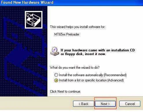

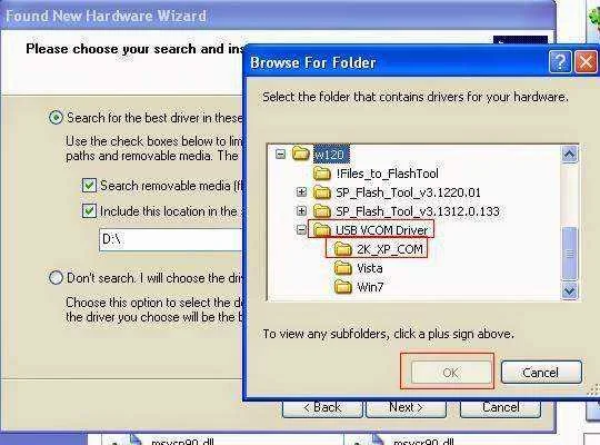

Installing Manually using VCOM Driver
When installing it manually your phone must be turned off, then connect it to your computer/laptop while pressing VOLUME UP or VOLUME DOWN. This will detect and look for the driver.
1. This is the first time that you will connect your phone and it will search for the correct driver.
2. Check include this location ... ... and click on browse. Look for USB VCOM Driver and Click on 2K_XP_COM folder if you are using Windows XP or Win7 for Windows 7 and then press OK when you are done picking the right folder for the driver.
3. If the driver is successfully installed MediaTek DA USB VCOM will appear in the New Hardware Wizard.

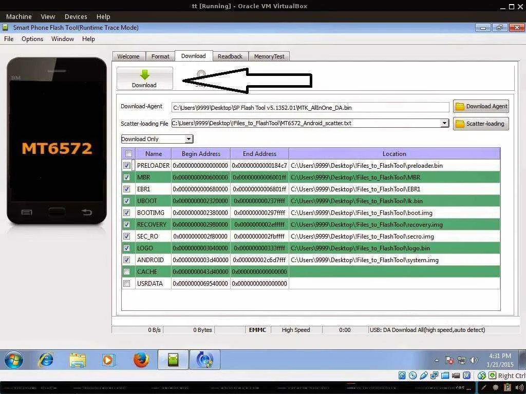

Flashing

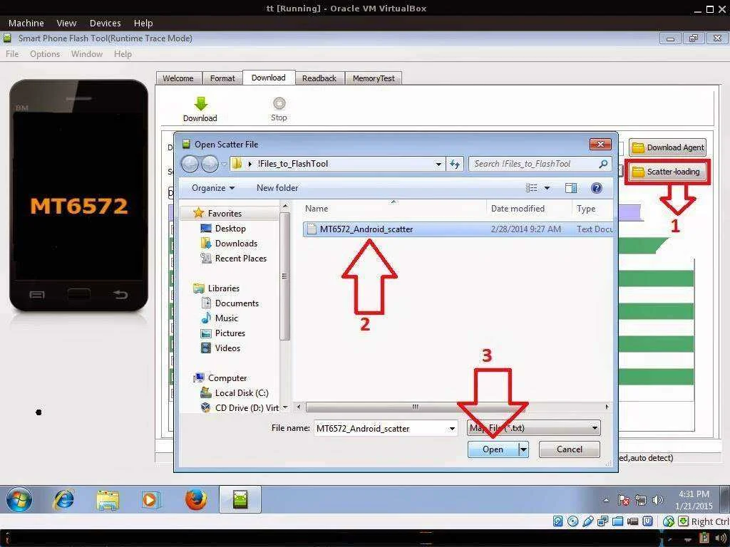

1. Launch FlashTool (flash_tool.exe)
2. In Flashtool, Click on Scatter-Loading, and load your scatter file. (see example below)
Reference Video Using FlashTool version 5.xxx (watch in HD)
3. After you load the file, UNCHECK PRELOADER only, press Press Download to Flash your Phone.
4. After you press Download Follow these steps
  • Turn off your phone (always powered off is a must)
  • Press and HOLD volume UP or Down or you can simply press it simultaneously
  • *********** USB cable without releasing the VOLUME button(s).
  • Keep on repeating until Flashtool detected your phone.
5. If successfully detected just wait until the progress bar reaches 100%. If your phone did not automatically turn on after flashing, remove battery and USB cable. And put back your battery then turn on your device.
"Hard reset your phone after flashing"

Flashing
