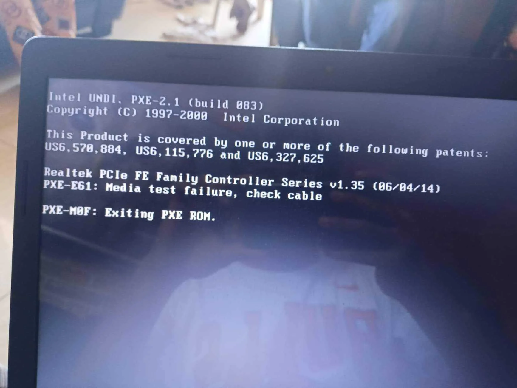

🔒 Closed BOSS PANO TO AYUSIN
Parang hindi na nadedetect ang harddisk, baka nagloose o sira na. May nakasalpak bang USB flash drive sa unit mo?
If your computer is a You do not have permission to view the full content of this post. Log in or register now., you may not be able to open it and check the connection. In this case, we recommend having a trained repair professional perform this task for you.
wala po bossing, working naman sya dati bigla ganyan
thanks po idol,
yun boot order priority mo sa bios ay nauna ang network boot kaysa sa harddisk..... pwede mo palitan ang order at unahin mo yun harddisk.... pag hindi lumalabas sa boot order priority ang harddisk ay malamang sira na ang harddisk ng laptop mo
bago magboot lods, punta ka sa BIOS tapos check mo sa boot order kung nareread pa yung HDD/SSD mo.
check mo din kung nka UFEI boot ka (Win10)/Legacy(Win7)..pag wala, pwedeng sira nu yung drive kung saan naka store ung OS mo..
Possible cause: kulang lang yan sa higpit, ribbon/wire/conductor pins issue, or yung mismo hardware nya na meron damage that need to be replace.
