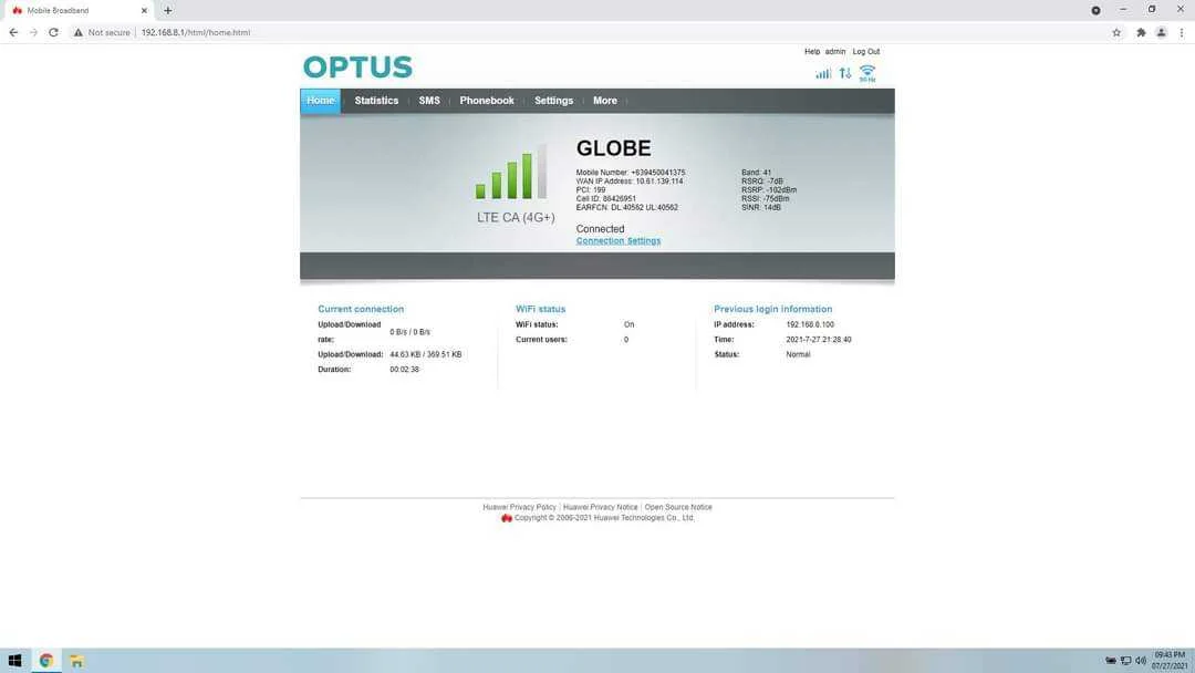

  • Change networks type name.
4G+ - LTE CA (4G+)
4G - LTE (4G)
3.5G - DC-HSPA+ (3G) / HSPA+ (3G)
3G - HSPA (3G) / HSUPA (3G) / HSDPA (3G) / UMTS (3G)
2G - GPRS (2G) / GSM (2G)
  • Add mobile number, wan ip and signal information in homepage.

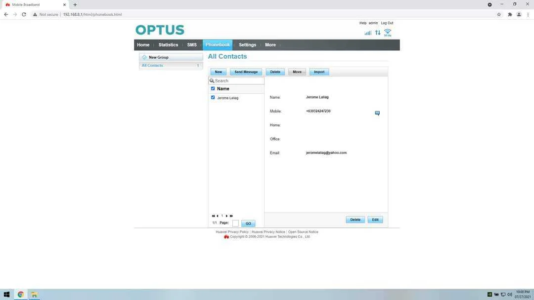

  • Enable Phonebook.

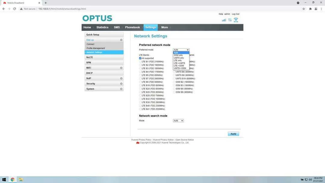

  • Enable all bands and multi selector in 4G, 3G and 2G. (Default bands in optus firmware is 1,3,7,8,28 and 40 only.)

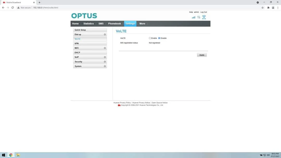

  • Enable VoLTE.

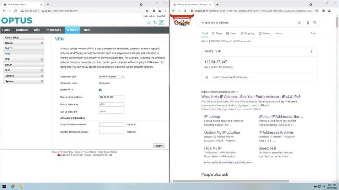

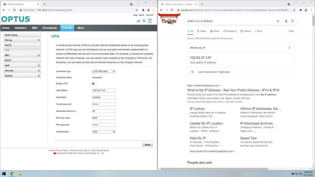

  • Enable L2TP and PPTP VPN client. (Working, tested on my server.)

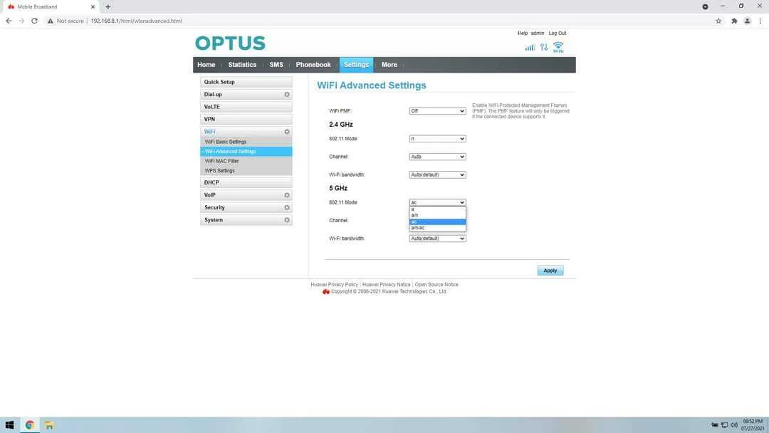

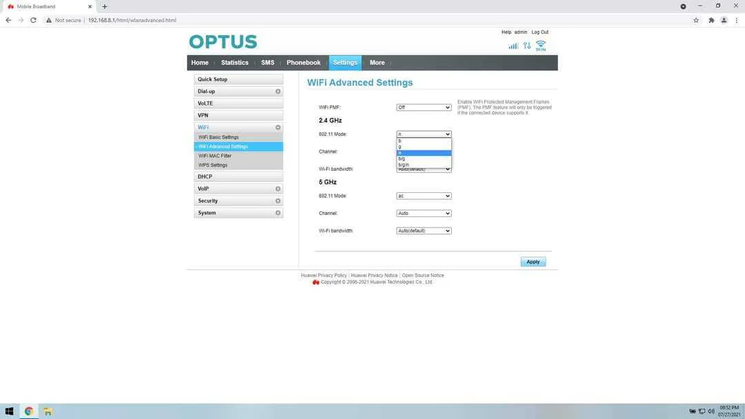

  • Enable WiFi Hardware in 2.4GHz (b/g/n) and 5GHz (a/n/ac).

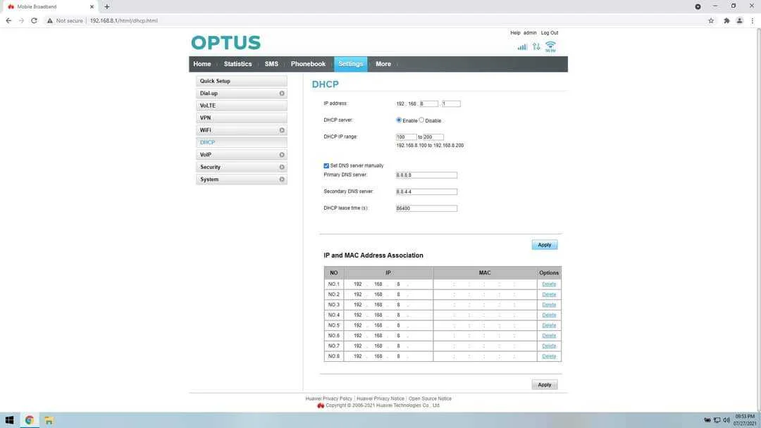

  • Enable DNS server manually in DHCP.

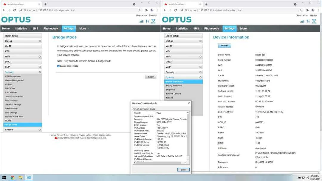

  • Enable Bridge Mode.

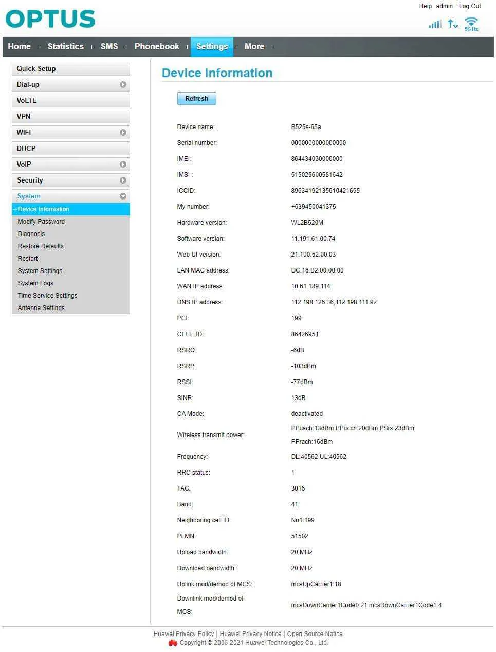

  • Add more details in device information.

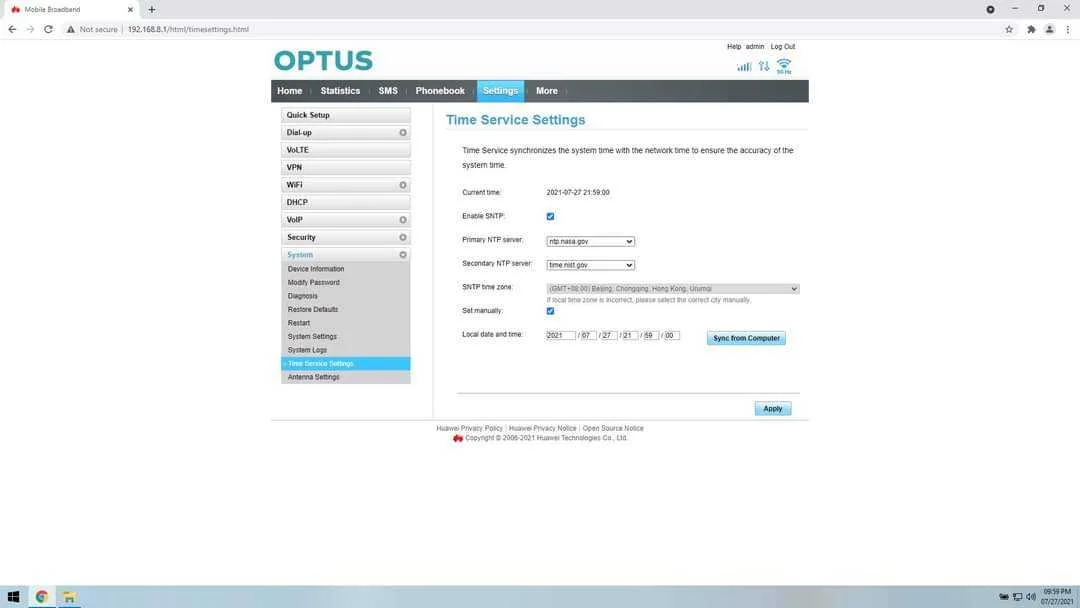

  • Enable set manually in time service settings.

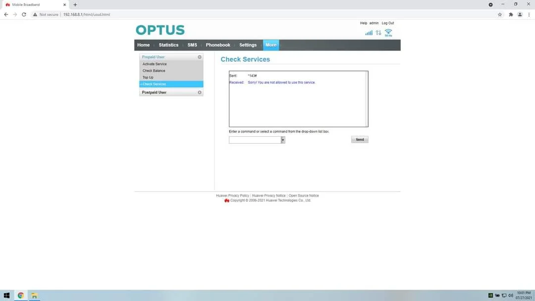

  • Enable USSD.

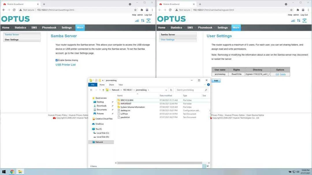

  • Working USB Printer and Samba Server in USB. (Samba server is working in all file system, tested on my UGreen Enlosure with 1TB [NTFS File System].)

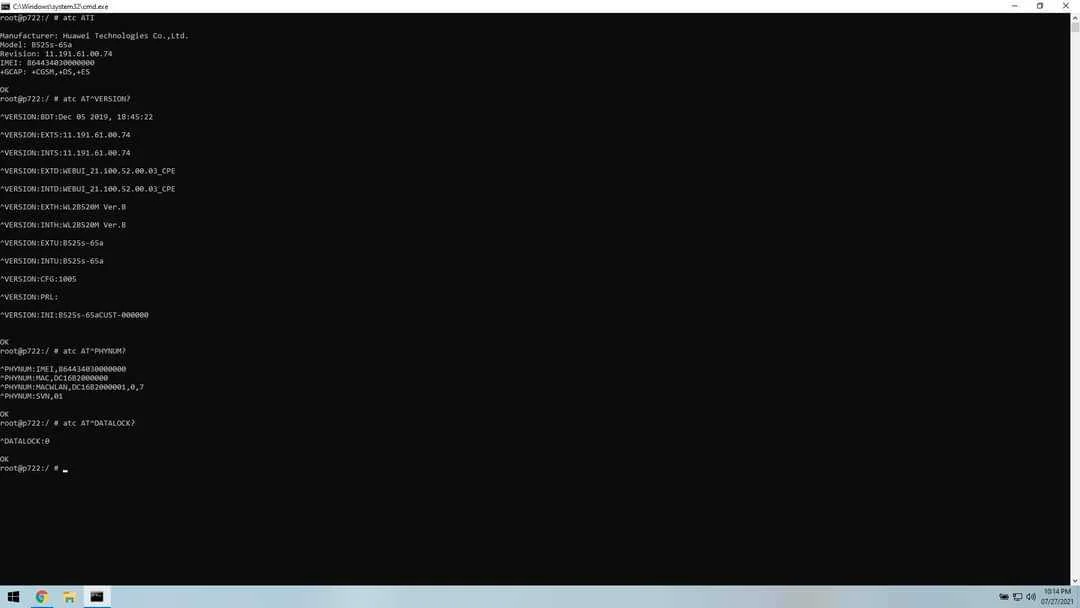

  • Add kpatch.ko module in startup to enable writing in nvram or datalock is set to 0 /system/xbin/kpatch.ko.
  • Enable adbd in startup for adb connect in modem ip address /system/xbin/adbd.
  • Add atc for AT Commands /system/xbin/atc.
