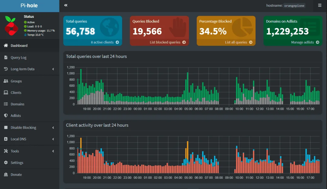

Salamat sa input mo sir. After ko magbasa basa sa guide napagana ko siya. Currently using Pi-Hole + Unbound. So far wala naman problema. Magandang alternative to since nagmahal ang rpi. Plan ko din bumili ng isa pa. Screenshot 2023-03-22 152032.webpScreenshot 2023-03-22 145311.webp
limited lang yan to 100mbit connection, kung gusto mo 1gbit mas maganda kumuha ka na lang ng cheap devboard sa shopee something like orangepi 4 lts or orange pi r1.
great alternative lang yung ni-recommend ko for not so heavy task and doesnt require gigabit ethernet. if im going to compare it, on par lang sya sa performance ng raspberry pi 2 or orange pi one
but hey, 450 pesos na lang sya, to be honest its a very good deal if you just want to run light stuff like a DNS server, or you want a cheap and low power torrent seedbox para hindi ka ma kick sa private trackers, this is the box for you.
