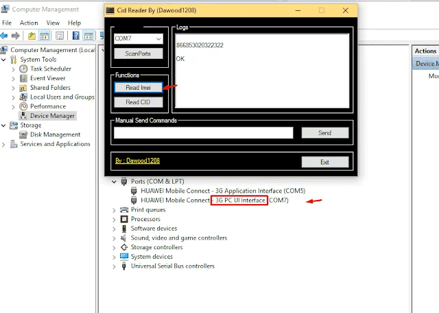

Sir yung niread ko yung emei walang lumabas sir, wala rin sa device manager ko sir.

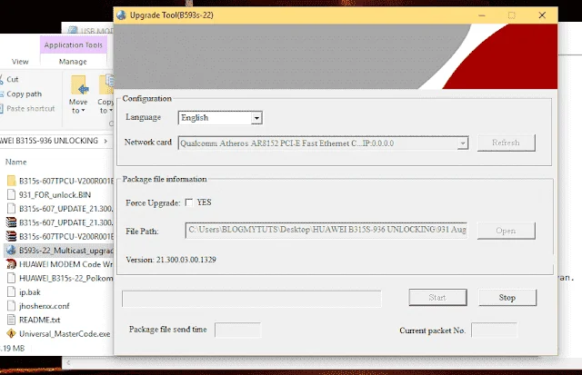

1. Hanap ka ng Multicast Tool gaya ng You do not have permission to view the full content of this post. Log in or register now.

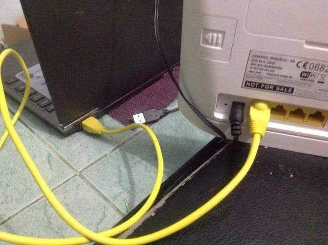

2. Select mo yung LAN saan mo isasaksak yung Modem mo (Lancard) Pati USB cable Buksan nadin yung Mobile Partner (hindi pwede sa WiFi ah!!) Off mo WiFi ng Laptop mo kung Laptop gamit mo hindi kasi gagana Multicast ng maayos..

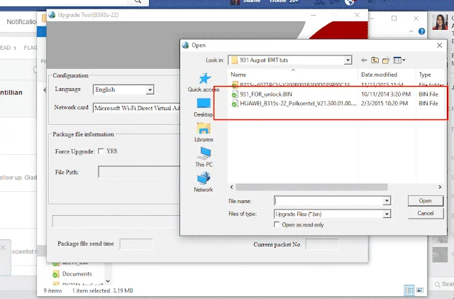

3. Upload ka ng kahit anung bin firmware (sample is yung firmware ng 593) then click START
4. Dinagdag ko ang step 4 na eto para sa hindi marunong mag Multicast! . Bunutin nyo saksak ng MODEM saka nyo i saksak ulit!

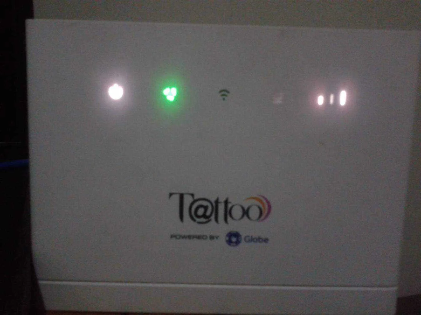

7. It will turn Blue again then wait a few second sipol sipol ka muna.. mag GREEN LED stay Stable..
Your USB Mode is Ready!!.
