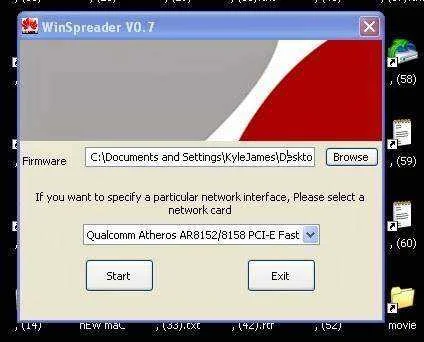

1. Get a Winspreader and Smart v7 firmware
2. Open a Winspreader browse the Smart v7 firmware Hit start.
3. Plug your Modem Power and Lan Cable the wait a few minutes....

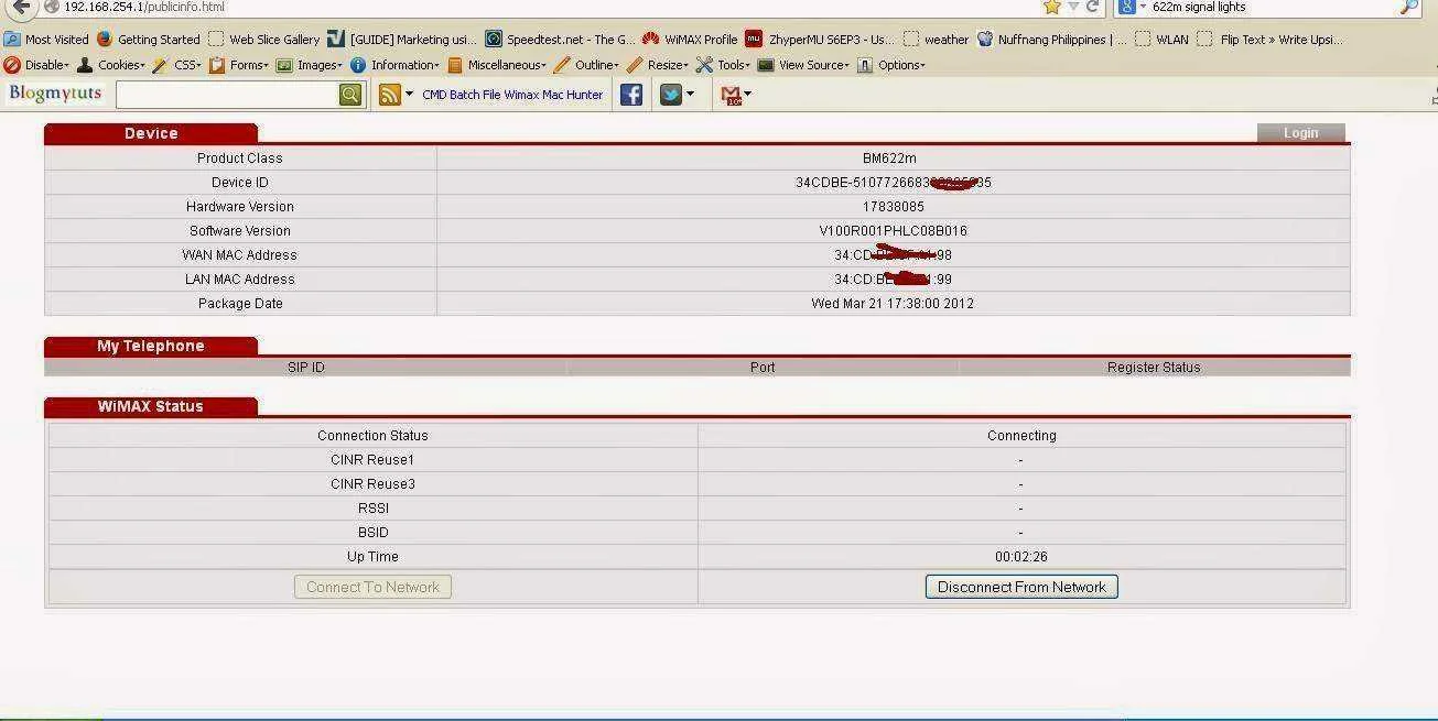

4. check the web GUI .. type the 192.168.254.1 on your browser
5. If you Gui Change to Smart...

Open a browser type 192.168.15.1 then you will see PINK page with error link is like this You do not have permission to view the full content of this post. Log in or register now.

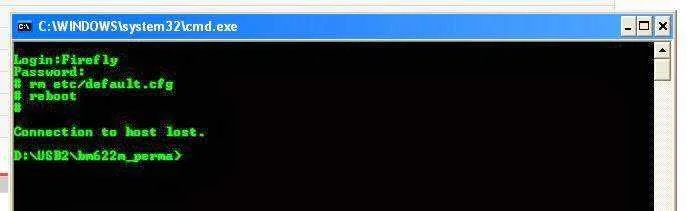

Now open a telnet again
Telnet 192.168.15.1
Login:Firefly
Pass:$P4mb1h1r4N4m4nT0!!
rm etc/default.cfg ( Enter )
reboot (Enter)
rereboot yan may ilaw na modem nyo. ..
Take Note yung original MAC and Serial nya sa sticker ay babalik parang brand new ulit yung modem nyo.. at kung signal light lang habol nyo skip nyo nalang mga ibang step diretso na kayo sa step 11
