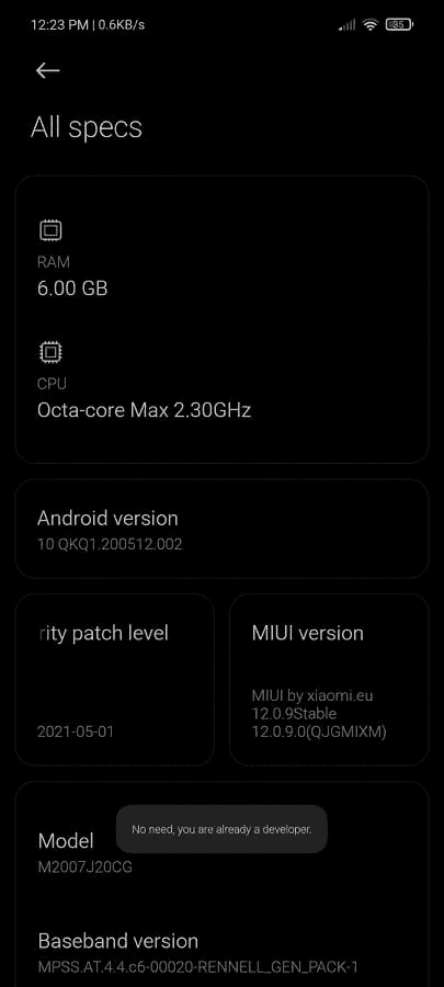

Step 2: Enable mo muna Developer Options by tapping 7x MIUI Version (Settings > My device > All specs > MIUI Version)1644640858011.png

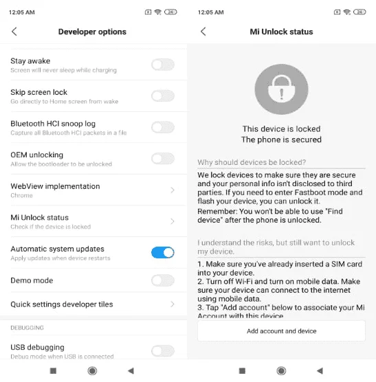

Step 3: Sa Developer options enable OEM Unlocking at USB Debugging Then Mi unlock status click Add account and device (need mobile data bawal wifi)1644641015696.webp

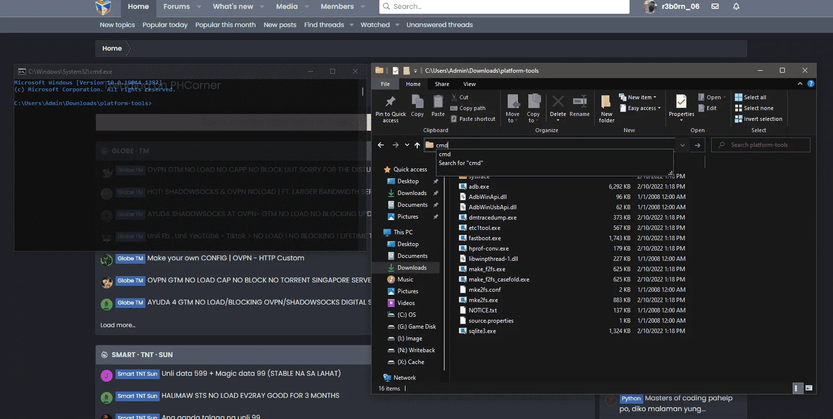

Step 4: Kapag okay na lahat pati yung sa requirements punta ka sa folder ng Platform tools then hold shift + right click open command prompt here / or type mo nalang sa address bar "cmd" then hit enter
