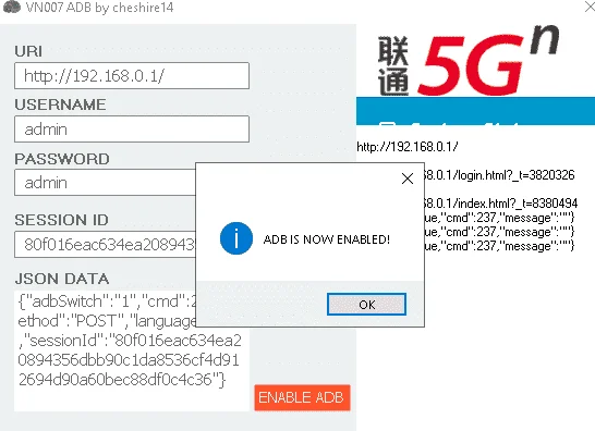

I was able to downgrade my vn007 to 1.x, although it was discouraged to go from 3.x to 1.x, it worked fine and it is working fine functionally.

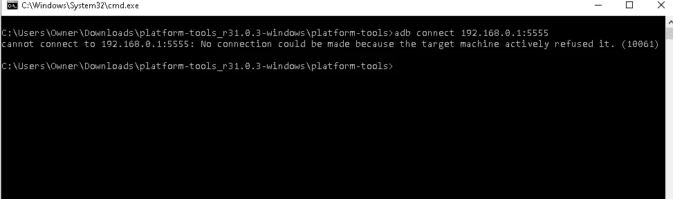

Still no success using the tool and even I ran the commands from the web browser console. I ran a scan with nmap but I dont see any ports open like 5400.
I am willing to help, I just dont know if I am doing something wrong or there is some other way to attack this!

Hi, I wasn't able to open the adb port but I did however unlock the root user tho is pretty useless because the vn007's firmware didn't have any band locking feature.

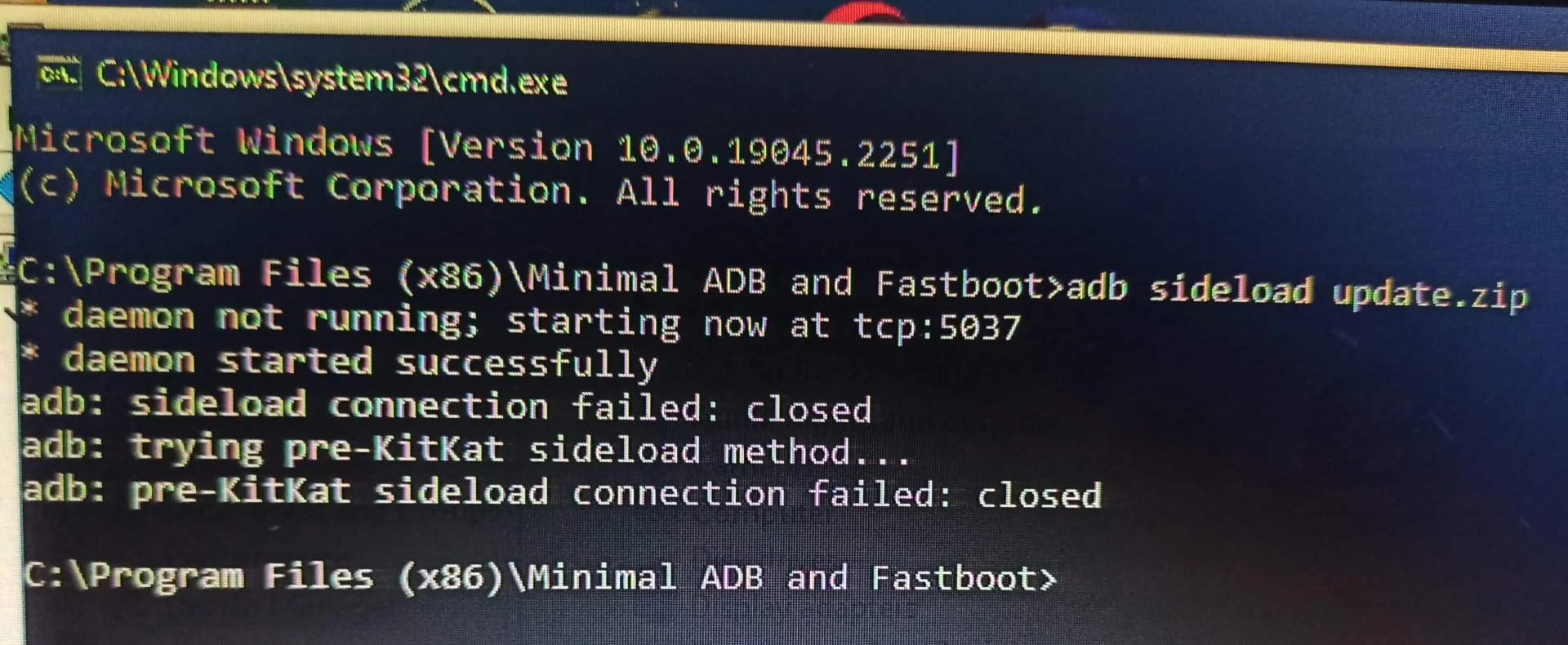

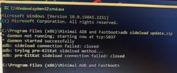

Nagtry ako iflash yung fw sa adb tool using the command "adb sideload update.zip" yung update.zip v3.8 fw po yan kaso ngfailed. May idea po kayo san ang mali?
connection failed it means hindi po maka connect ung adb sa modem.
Pero nakikita ko po naman yung vn007 ko sa adb device command

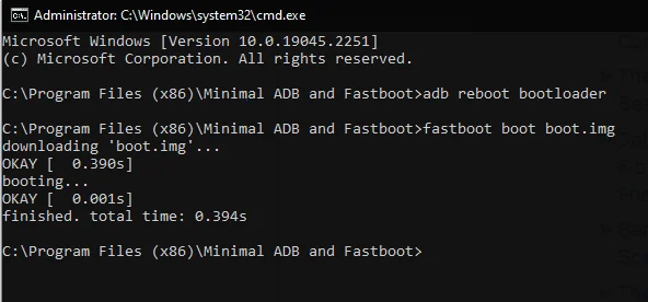

Napa run ko naman tong command nato okay naman kaya lang yung boot.img lang tinry ko baka kasi magkamali ako at tuloyan pang matotally brick ang vn007 ko di ko kasi alam ang sequence.
Ano po kaibahan ng fastboot at adb installation?
wala pa akong nakitang nakapag try mag load ng custom bootloader sa vn007, idk san ka galing nyan boot.img baka na download mo lang sa google at di yan pang vn007, baka yan yung main reason kaya nasira ung modem mo.
fastboot - allows to boot from a custom recovery image
android debug bridge (adb) - programming tool for debugging of android devices
Hi po, yung boot.img enextract ko lang galing sa vn007 fw v3.8 kumbaga sugal yan kasi testing lang yan if magssuccess yu command at sa tingin ko ngsuccess nmn pero hanggang jan lang di ko tinuloy kasi di ko alam ang kung iisahin ang .img na file kasi nabbrick daw ang device kapag mali ang sequence.
