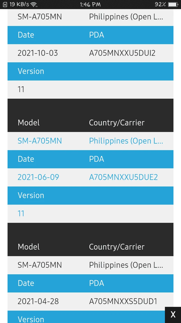

Pwede ka magdowngrade sa mas mababang OTA update but same binary, makikita mo sa picure na latest updates ung nasa taas which is 2021-10-03, pwede mo iflash ung ota updates dated 2021-04-28 since parehong binary 5/U5, kung latest yang update ng device mo, magflash ka ng version na mas mababa but same binary

Download firmware then flash sa odin, tingnan mo muna kung anong binary version ng device mo, go to about phone makikit mo ung ganito A70xxxx5HYFJ, hanap ka lang ng updates na same binary pero outdated,
Make sure din po na tamang firmware ang idadownload mo, pili ka ng carrier, SMA-SMART, XTC -OPENLINE, GLB - GLOBE
Make sure din po na tamang firmware ang idadownload mo, pili ka ng carrier, SMA-SMART, XTC -OPNELINE, GLB - GLOBE
