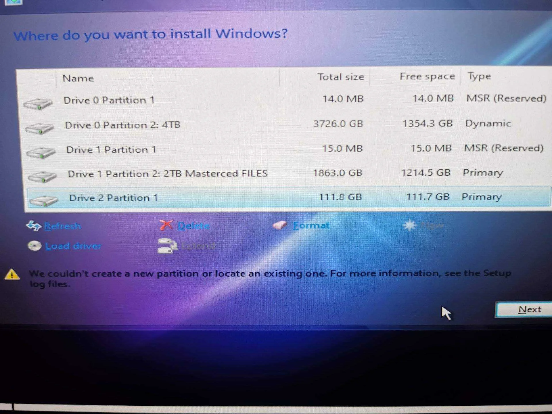

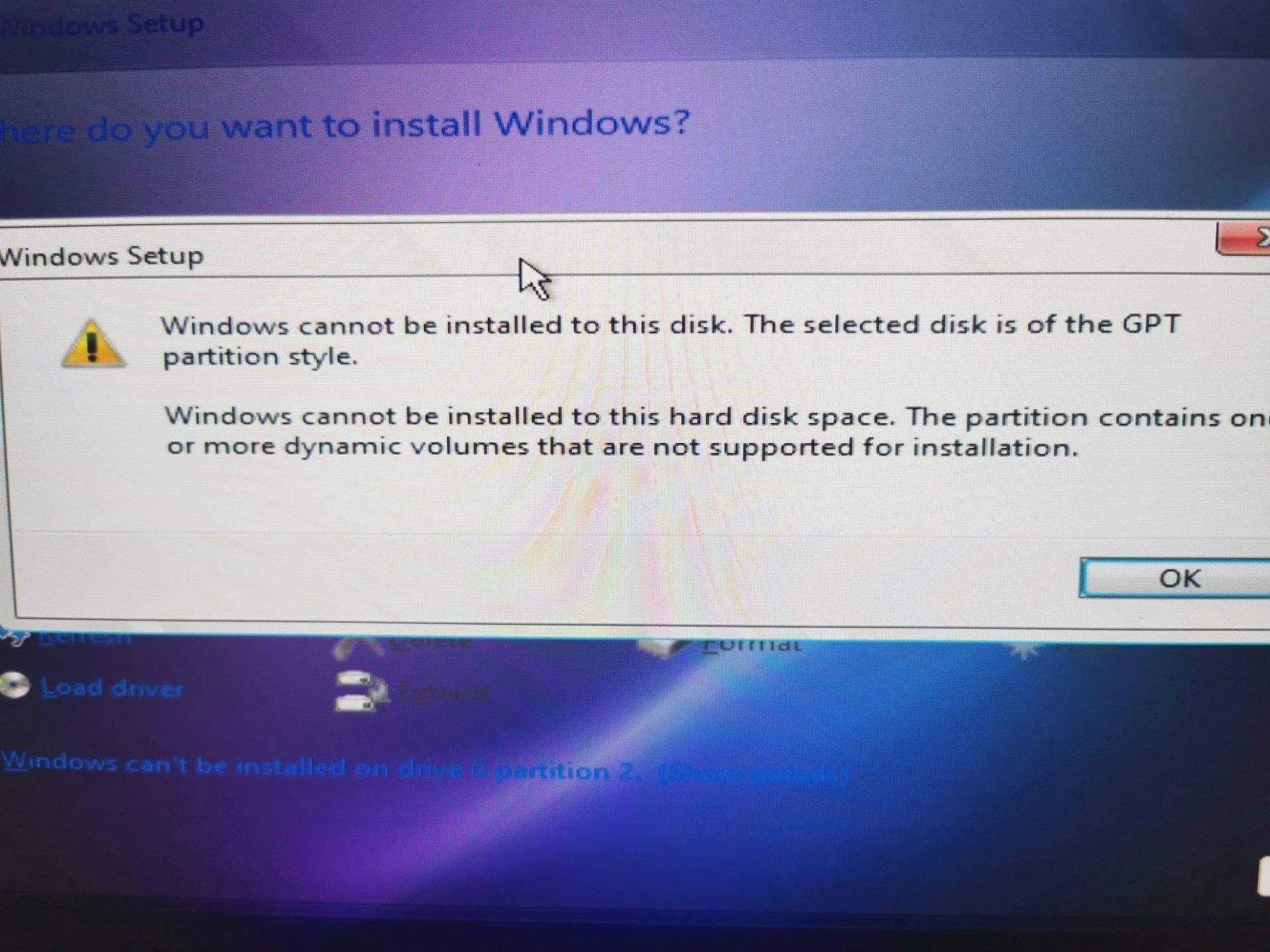

Guys pa help naman di natuloy yung usb Os boot ko naformat ko na yung SSD ko
trying to install Ghost Spectre windows 10 21h1
unang error: windows cant install to this disk, the selected disk is of GPT style...
format ko naman po yung SSD gamit AOMeI
error: we couldnt create new partion or locate an existion one

remove mo muna yung 2 drive moiwan mo lang yung SSD na ipoformat mo.if nasa list disk ka na ng drive, idelete mo muna.then next na.
