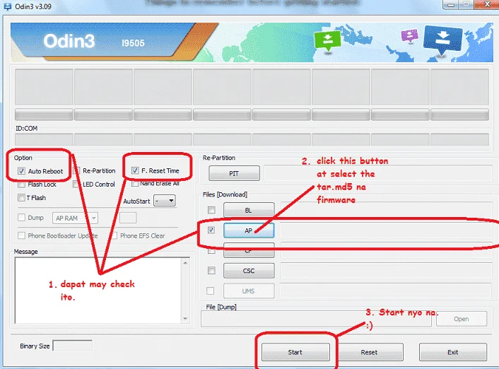

• Make sure that, only the “Auto Reboot” , “F. Reset Time” and "AP"options are checked. See Screenshot
Now, extract the downloaded firmware zip file, you’ll find a firmware file with extension .tar.md5
In Odin screen, click on AP button and select the firmware file with .tar.md5 extension.
Now, click on the Start button to begin the installation process, wait few moments.
• Once completed, you would see “PASS!” message in ID:COM port having green background
• Your phone should automatically reboot after completion
• You can now disconnect your phone from computer
• Finish
• Finish
• Finish
