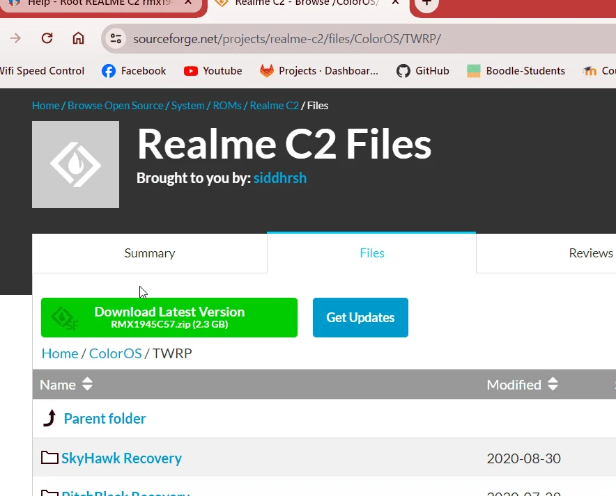

4. Reboot phone to bootloader mode
5. Flash image using - fastboot flash recoveryYou do not have permission to view the full content of this post. Log in or register now.(pili ka dyan compatible for color os).
6. run - fastboot oem reboot-recovery (Skipping this step will revert to stock recovery)

5. Reboot to bootloader
6. Now flash twrp using - fastboot flash recovery recovery.img
7. Now type - fastboot reboot recovery
8. Flash You do not have permission to view the full content of this post. Log in or register now. otherwise it will be reverted to stock recovery
