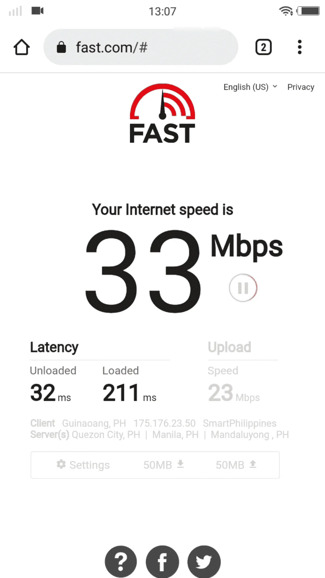

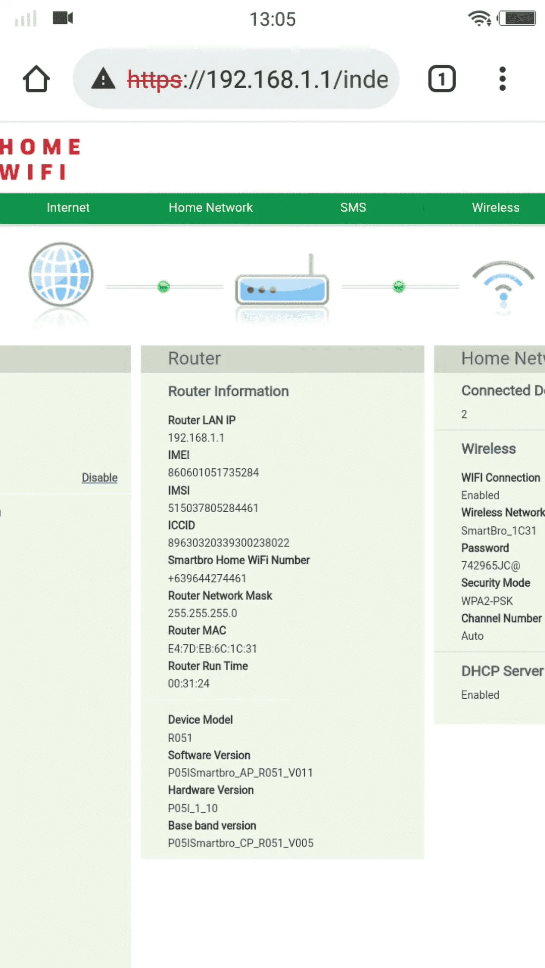

Lumakas pala ung new model ng r051 naka firmware v11 na at baseband v5
Malakas na yung upload speed

Kac yung latest model ng r051 v11 baseband v5 , napaka
Stable na ngayon saka malakas upload speed halos the same sa download speed

Yung updated na r051 ngayon super stable, wala lang network unlock pang smart network lang design pero nilagyan na built in diagnostics
