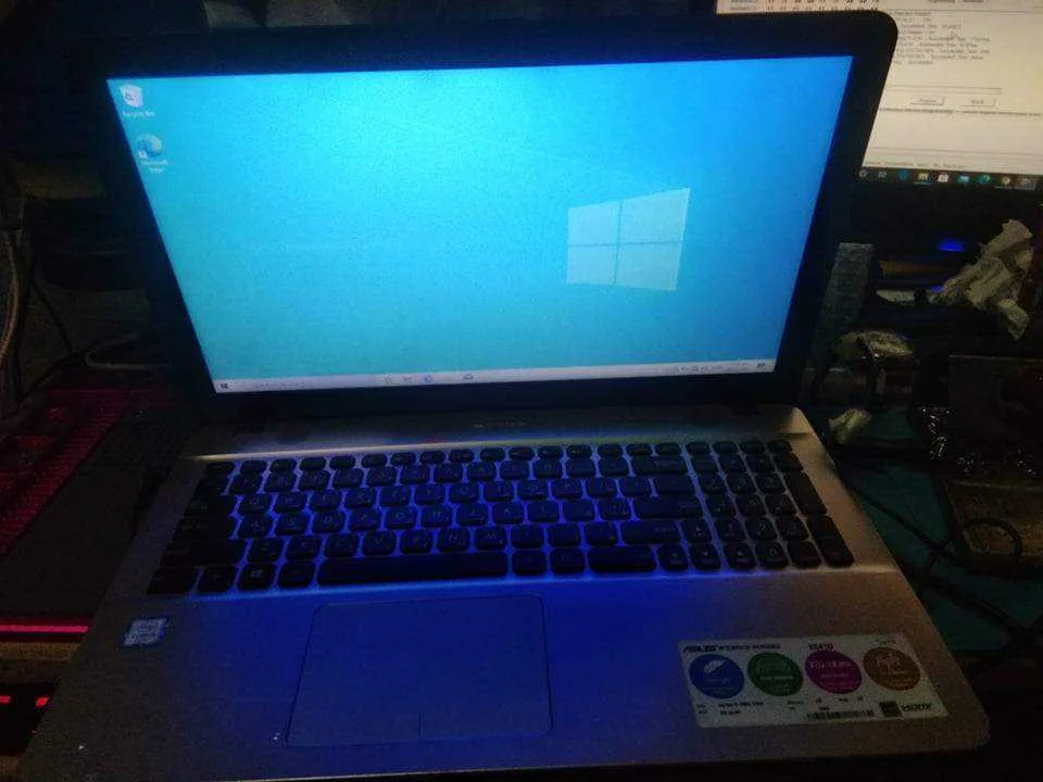

Issue : Upon Receiving Unit/Device NO DISPLAY
Action Taken : Tried to Reseat Memory issue still persist!

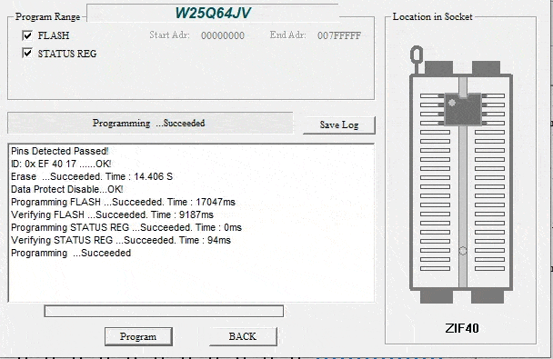

Next Move : Tried to reflash BIOS Firmware SUCCESS

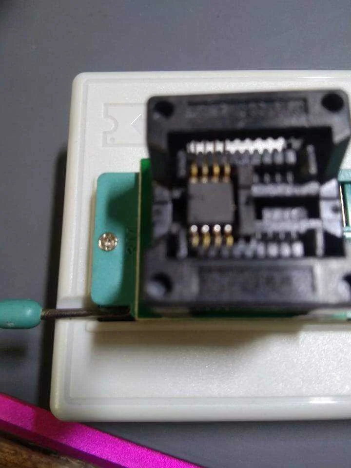

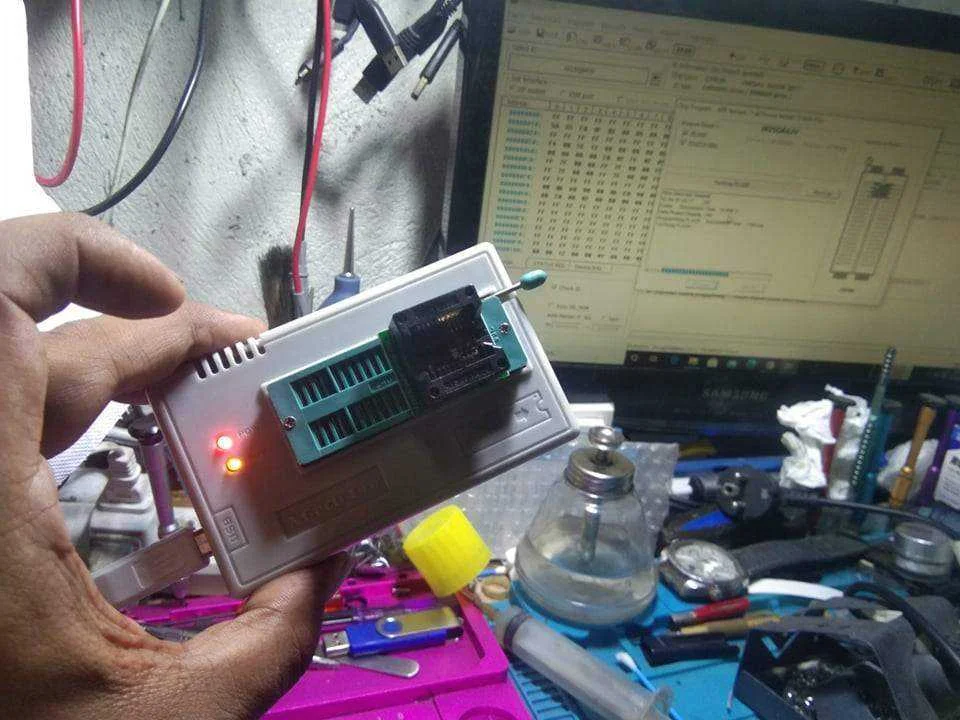

BIOS Programmer Tools : TL866-11 PLUS
Firmware Link :

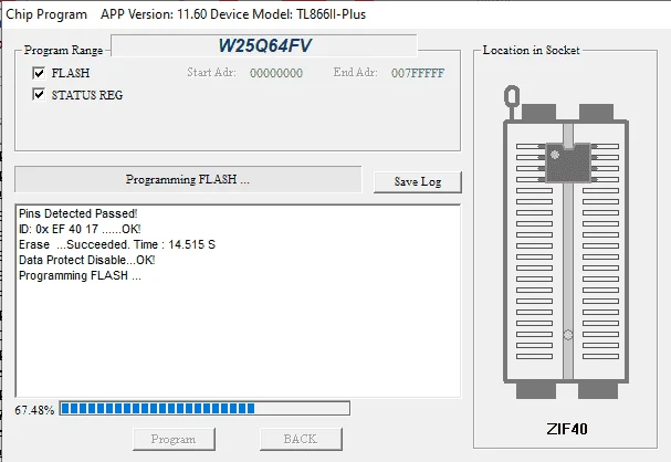

-READ CHIP
-SAVE AND BACKUP CHIP FOR SECURITY PURPOSES
-LOAD DOWNLOADED FIRMWARE
-PROGRAM FIRMWARE THEN WAIT....

Locate and desolder BIOS CHIP
