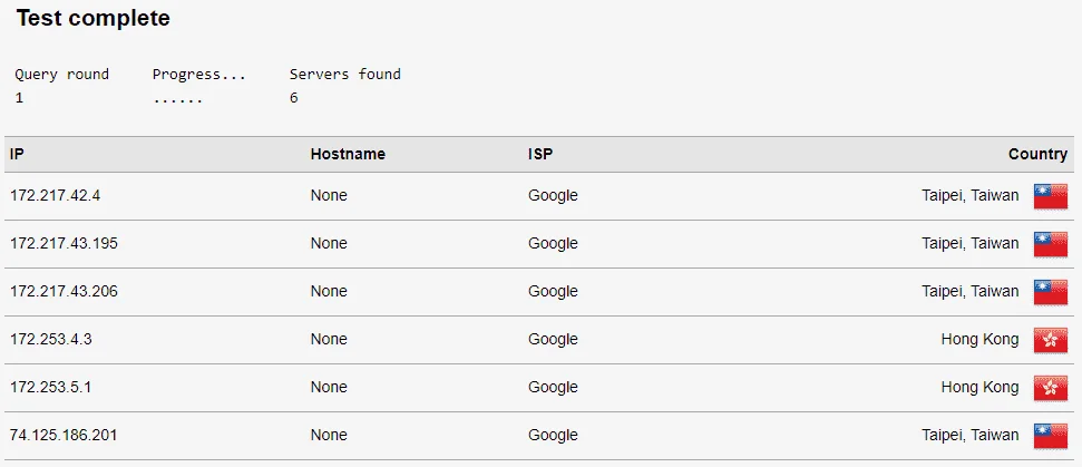

Nope, you can't change DNS when using D2K, even if you change your DNS servers in your devices. It doesn't matter what nvram commands you read that try to change the DNS, those don't work. If you don't believe me, then here's a simple check to see if you are indeed using the DNS server you set.
Visit You do not have permission to view the full content of this post. Log in or register now., and under the ISP results, you should see the DNS servers you set, like Google if you use 8.8.8.8 or CloudFlare if 1.1.1.1. If you don't see them, then you didn't change DNS servers when you thought you did. 😉

Thanks, Nagtataka lang ako kasi mataas ping niya sa ML. Mabilis naman siya sa speedtest 30-40mbs DL then 5-10mbps UL.

via SSH or Telnet
echo "search local" > /etc/resolv.conf
echo "nameserver 8.8.8.8" >> /etc/resolv.conf
echo "nameserver 8.8.4.4" >> /etc/resolv.conf
* Note: This will revert to default "nameserver 10.86.75.171" after the modem/router restarts.
