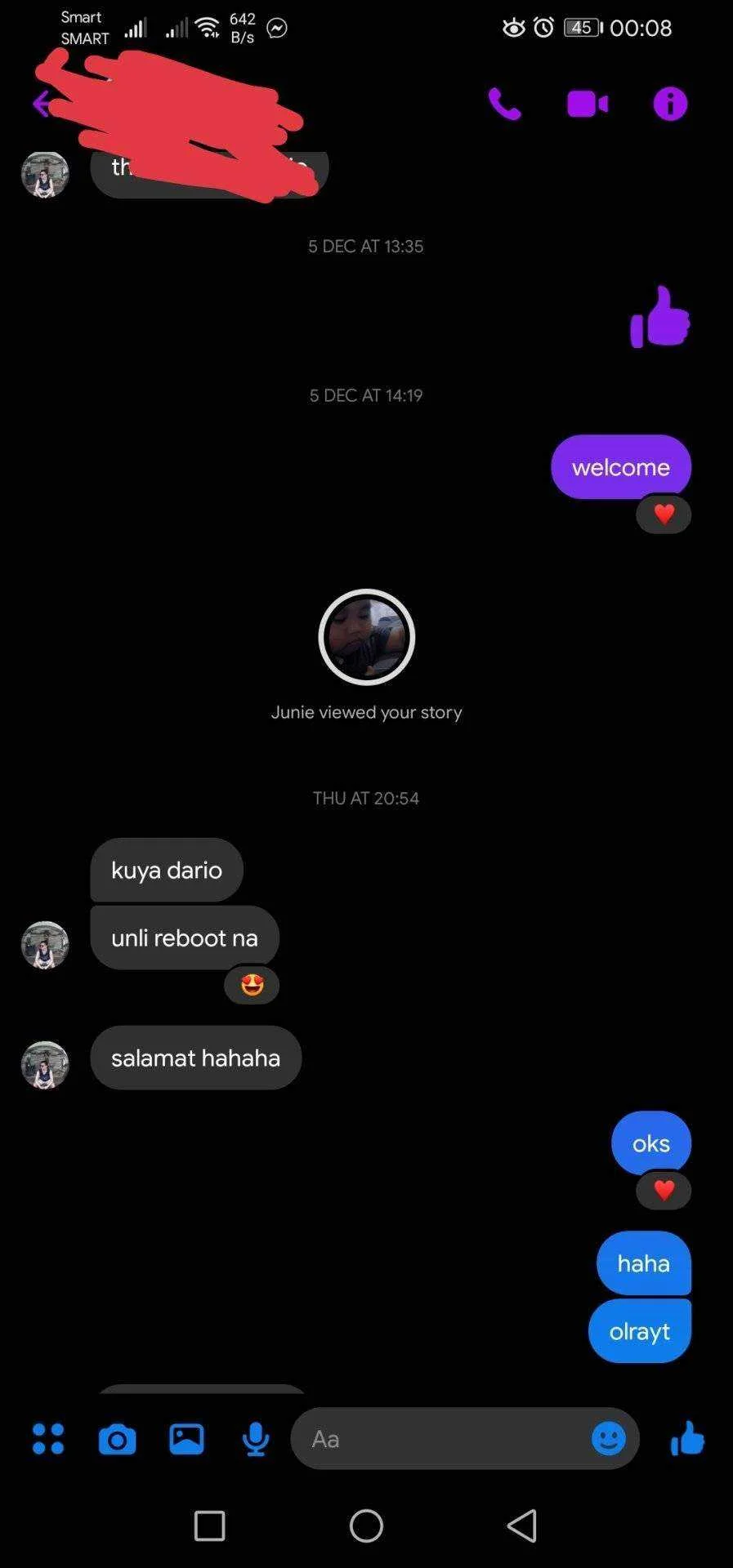

eto yung feedback sa ginawa ko sa kapitbahay libre lang di ako naninigil ehh hahaha pameryenda lang sapat na sakin, minsan pa nga ty lang hahaha saka di naman ako cp technecian, may konting knowledge lang sa electronics dahil nagrerepair
redmi 9t model yung kanya tanggal ic shield lang

Update: Dahil atat na atat na akong ma fix phone ko paps nag improvise Ako Ng lense plus sun ray at sa wakas na tanggal din Ang shield . The phone was totally dead for about 20 mins with the proper board heating (pwede gamitin Ang hair dryer 250 °c ok na Yan ) the phone turned on. After I did try to reboot the phone as many as I can to check if the fix was working. So far 20 reboots na Yung nagawa ko. Mga 5hrs na din Mula Nung matanggal ko Yung shield and Walang problema Ang phone.
Success
