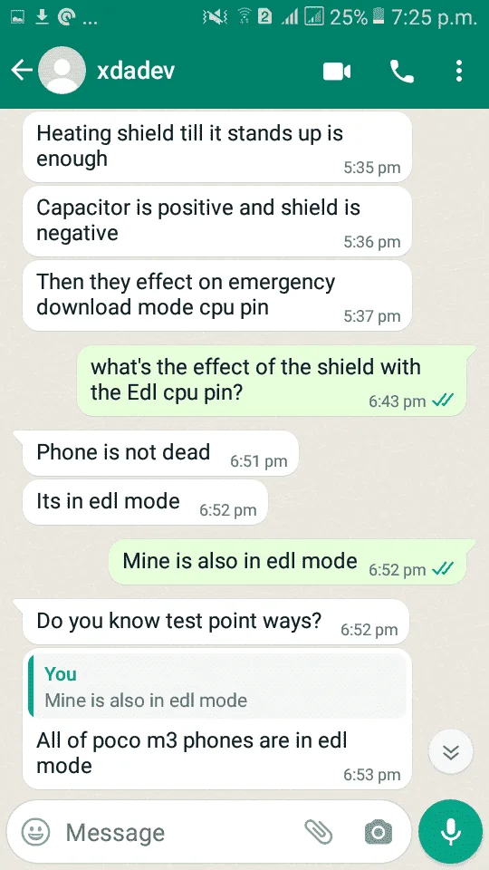

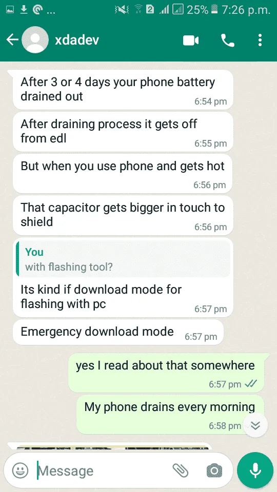

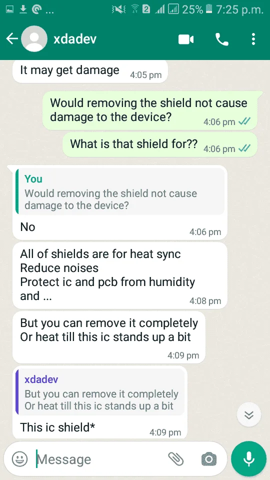

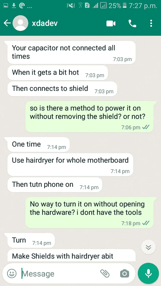

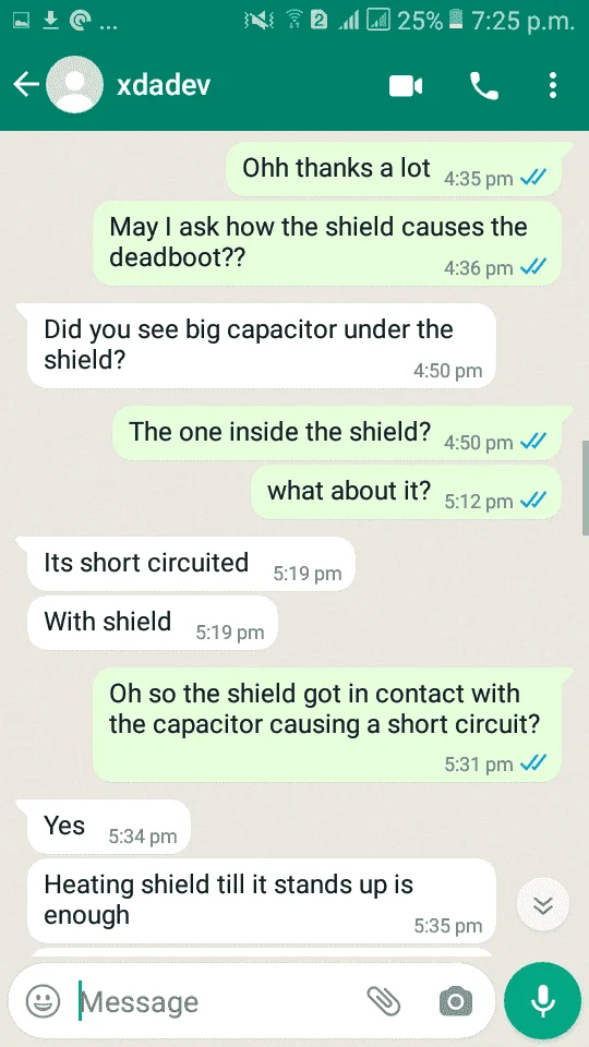

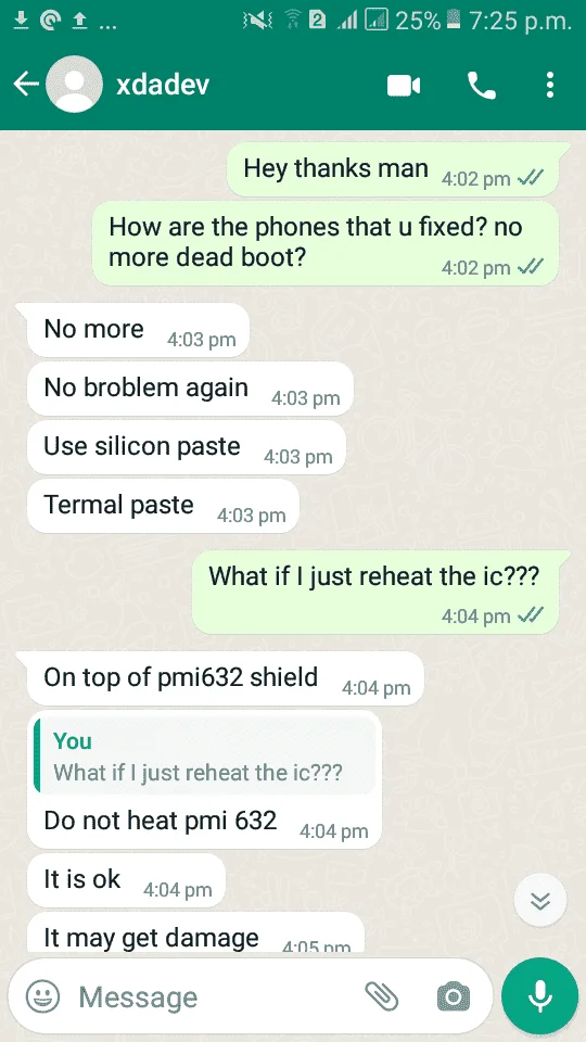

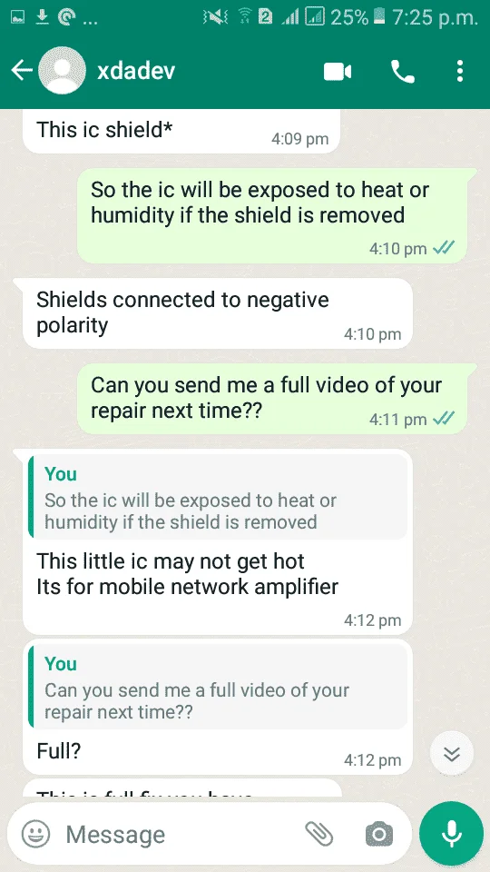

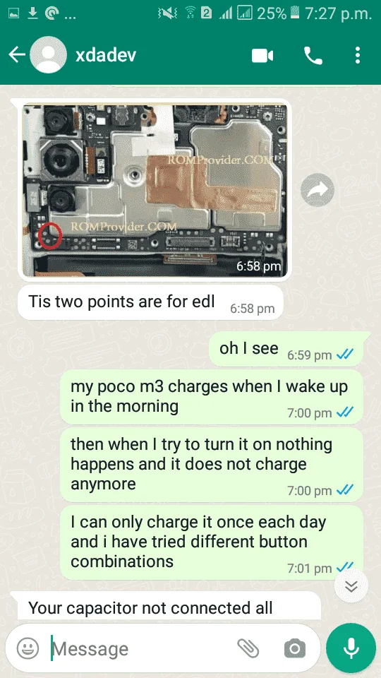

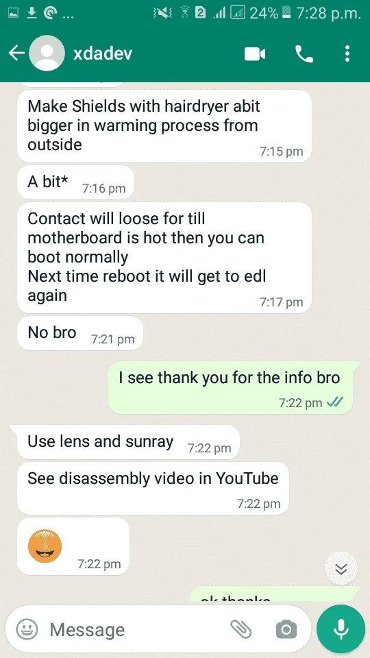

So according sa tech na nakita ko sa isang forum, kaya nagkakadeadboot ang ibang poco dahil sa short cirtcuit between the capacitor and shield ng network amplifier, minsan daw kapag umiinit ay nagkakaroon ng contact ang capacitor sa shield (thermal expansion), dahil sa short circuit naactivate yung EDL(Emergency Download Mode) mode ng phone na nagpeprevent ng pag power on ng phone to avoid further damage(kasi may short circuit) kaya hindi nama talaga sya "DEAD", need mo lang tanggalin yung shield para maka exit ng EDL mode at mabuksan yung cp
Fix is applicable lang sa mga unit on edl mode at hindi nadamage ang board dahil pinagawa sa tech

SEE ATTACHMENTS FOR DETAILS & GUIDE VIDEO

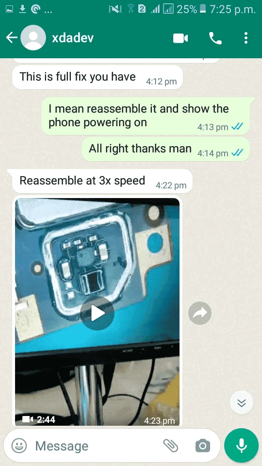

Update: Dahil atat na atat na akong ma fix phone ko paps nag improvise Ako Ng lense plus sun ray at sa wakas na tanggal din Ang shield . The phone was totally dead for about 20 mins with the proper board heating (pwede gamitin Ang hair dryer 250 °c ok na Yan ) the phone turned on. After I did try to reboot the phone as many as I can to check if the fix was working. So far 20 reboots na Yung nagawa ko. Mga 5hrs na din Mula Nung matanggal ko Yung shield and Walang problema Ang phone.
