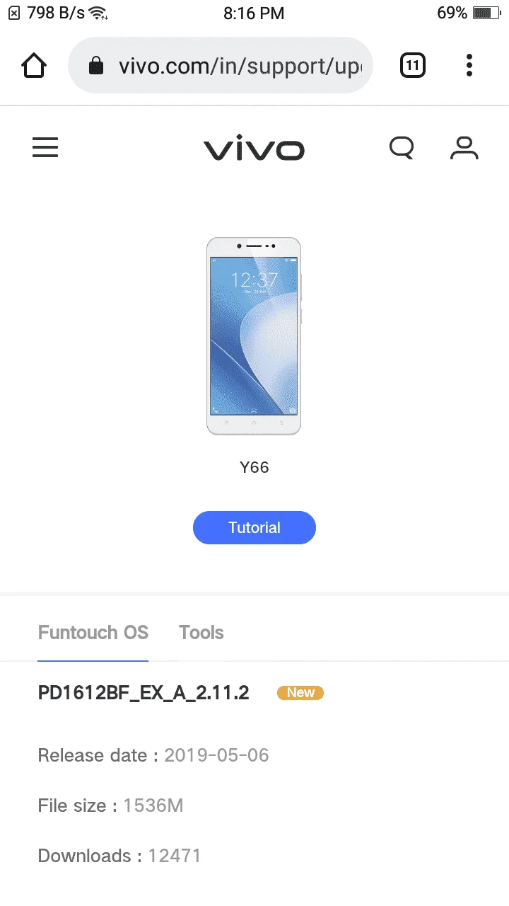

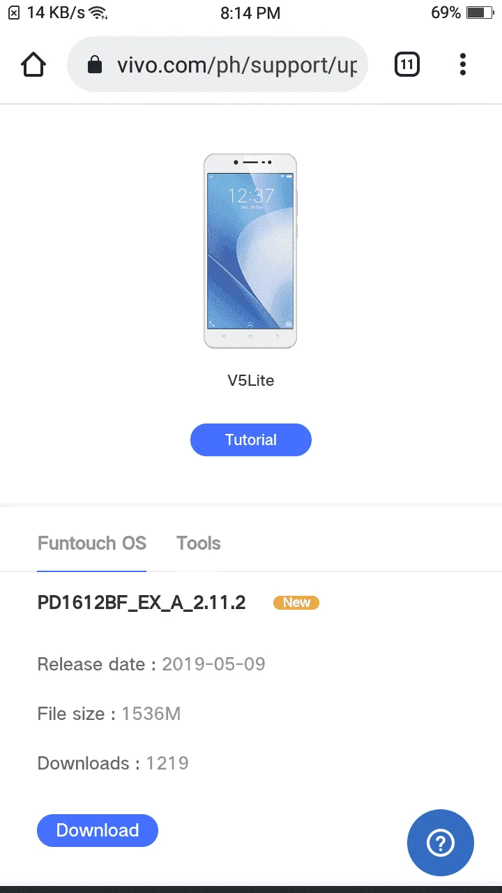

May possibility din po na battery ang problema, according to other sites, v5 lite po ang model ng vivo phone mo na available sa philippines, y66 is from india, as you can see sa OTA updates, magkapareho po ang version ng v5 lite at y66 which is PD1612BF_EX_A_2.11
PD1621 is snapdragon processor, kung detected ang device as qualcomm meaning sd processor yan, PD1621 = SNAPDRAGON PROCESSOR, PD1612BF = MEDIATEK:)
